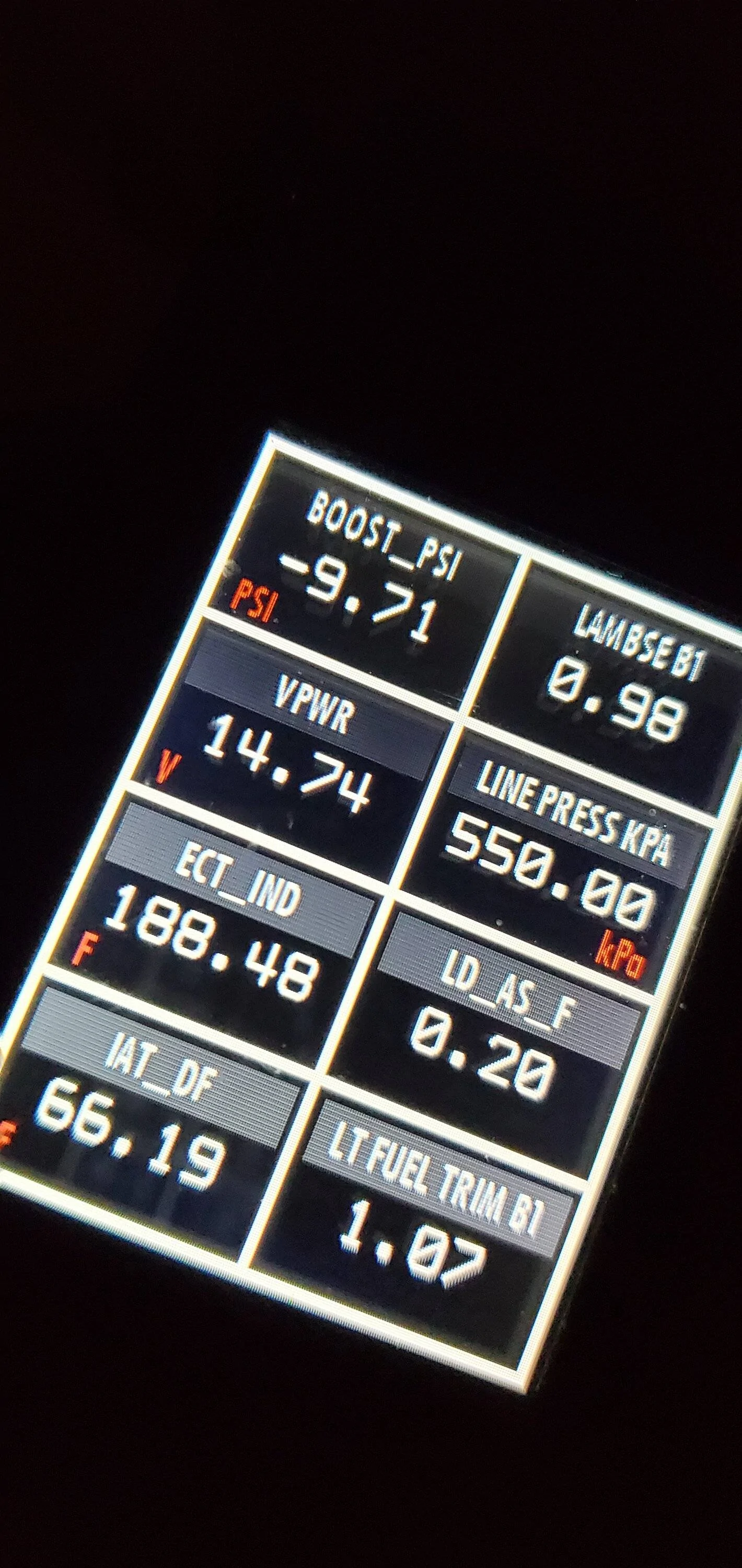

Thanks for the input I trying to make arrangements to get into modified by kc may26 is the plan this time of the year they pretty busy outside of driving all the way to Oklahoma all though I was tempted. My car is way overdue for dyno. There's only so much bama can do just via email tune revisions and some things can't be done through email or the cloud. This is one example granted I don't know or understand half what looking at except there was difference that I noticed just unable to pinpoint pulled out most of my hair in the process lol
