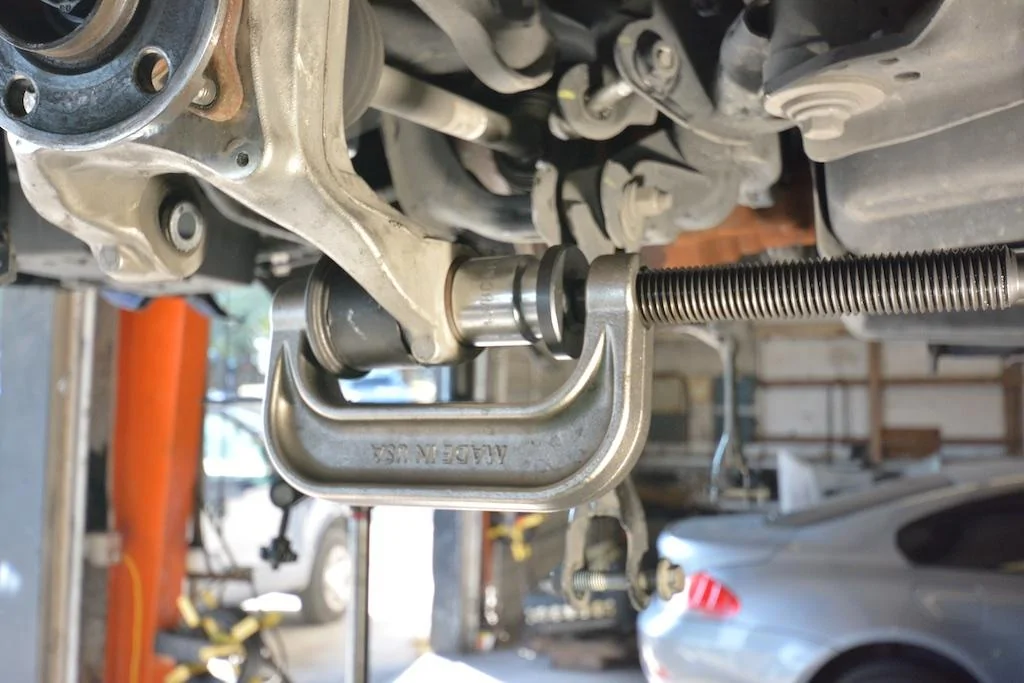

I'm in the process of replacing my knuckle to toe and rear control arm bushings and found a 1-1/4" rigid conduit coupler in the electrical section at Home Depot that worked perfect for getting the first toe link bushing out.
The toe link bushing sleeve is 49mm in diameter. The coupler is 48mm so the perfect size for the job.
I ended up taking the knuckle out of the car and using a 12 ton HF press to do it.

Did you try a 1 1/4" socket or just the coupler? I'm looking to do this one soon with one of the rental tools.

All I needed was my socket. I have a write up on this somewhere. Having a set of extra hands to align and hold together all the press tool parts makes it way easier. Frankly, if I did it again, I'd probably just use an air hammer and the socket as a pusher to jackhammer the bushing out vs. waste time setting up a press to do that.
Honestly, I don't remember if I tried a socket or not or why not. I remember having a helluva time trying to line up a clamp, bushing press and cup while on the car and gave up on that since a press was available to me.

I did mine on Saturday, and my 1-1/4” socket was a bit too small to get the outer lip of the original bearing. I made a tool... 1.900” OD with a 1.625 c’bore to accept the inner portion of the bearing. Simple after that.
