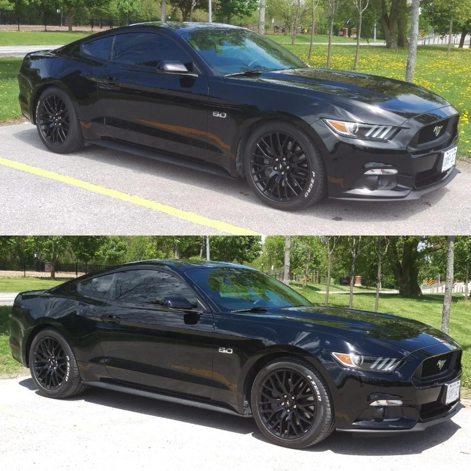

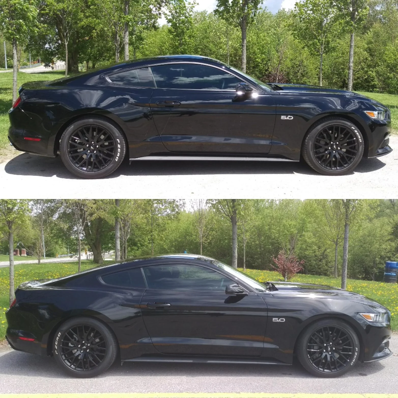

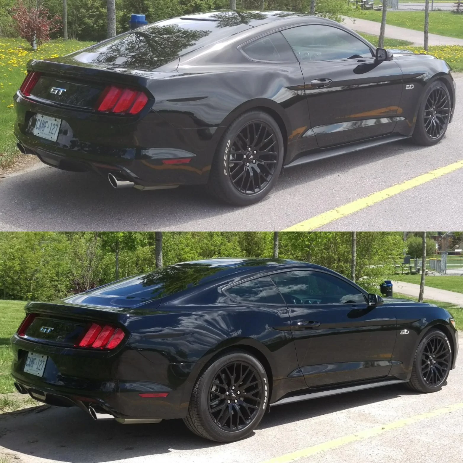

Added pics. Drop is so minor you can barely tell the difference. Another reason why I liked this kit.
Shiny picture shown one is stock. Dull is after.
