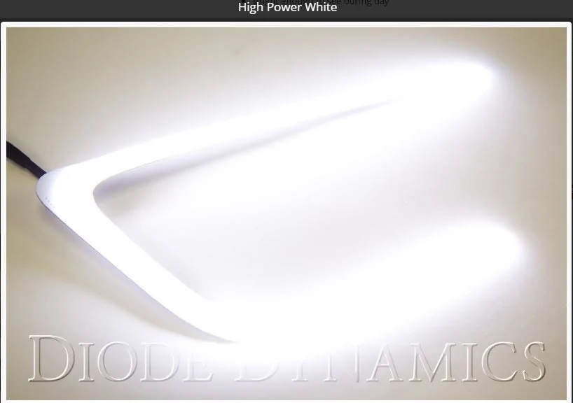

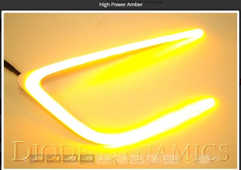

[MENTION=9987]Diode Dynamics[/MENTION] , just saw on your website you also have a DRL kit for the 2015/2016 Subaru, I don't know why, but I think the setup of this DRL boards is better than the single LED's on the mustang boards...
Why are you not looking into something like this for the Mustang instead of the single LED's ?
So we can have the entire bar lit up and it resolve the thing that the single LED dots can be visible if you take a closeup look to the car. :shrug:

Look how thick the lights for the Subaru are. I think the bars in the Mustangs have to be very slim or at least not thicker than the OEM LED boards, otherwise they wouldn't fit in the housing

Yes, but I mean to keep the setup like now and to add this coat around the LED's to hide the LED dots.
That's the info on the product's page (for the Subaru light) :
these modules are populated with over 500 LED chips, which are then coated by a diffusing gel, resulting in a perfectly uniform light when turned on.

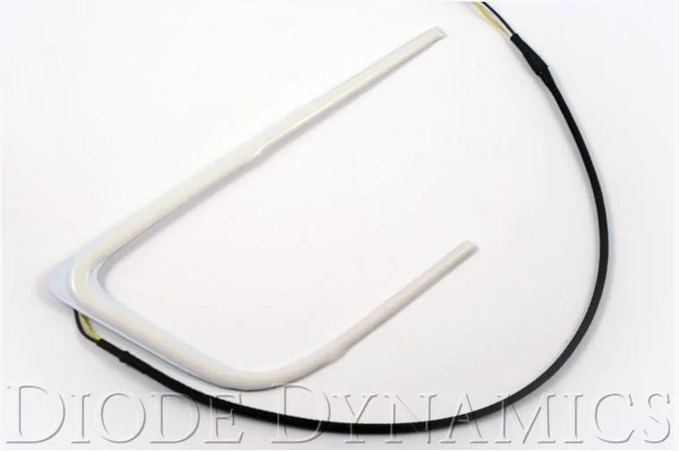

The 2015+ Mustang housing has optics specifically designed for these LED boards and the position of the LEDs behind the factory diffuser lens. By replacing the boards themselves and placing the LEDs exactly where they are from the factory, you get a more uniform effect that matches the clean, factory appearance.
The 2015+ Subaru WRX doesn't share the same LED board / optics setup. On the non-premium models it's a simple 194 bulb mounted in the corner behind a lens to light up the entire C-Light shape. Our LED boards for those housings fill in the entire diffuser, which doesn't have an LED board to begin with.
Here's some comparison pictures to visually explain the Subaru setups better:
Subaru XV:
With our Switchback C-Light LED board installed:
Replacing boards or installing new boards in the factory mounting locations is also an easier installation process for the end-user.
Thanks!

I was just thinking that adding the diffusing gel on the Mustang's LED boards could be a good idea to have a better light distribution behind the OEM lens of the Tri-bars.
The Mustang has an optical system integrated, which is always better than a simple strip (like the C-Light product). The gel diffuses the light in all directions. Even though the C-Lights are similar in brightness to these, they do not have the intensity because the light is going in all directions. Not ideal, it's just the only way to do it if you're making the light into a shape. Optics are always much better, more efficient, etc.

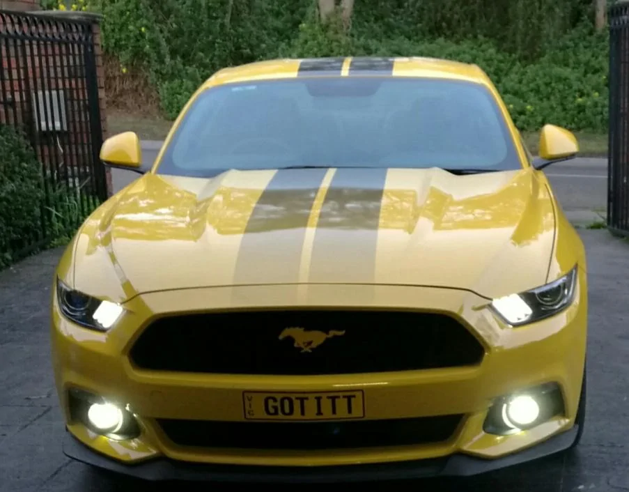

Here's mine with tri bar lights but old version.
