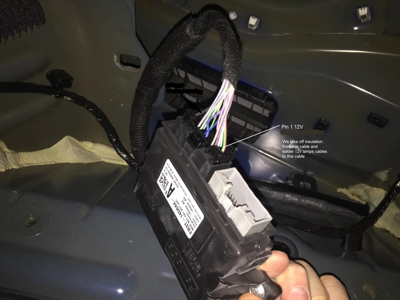

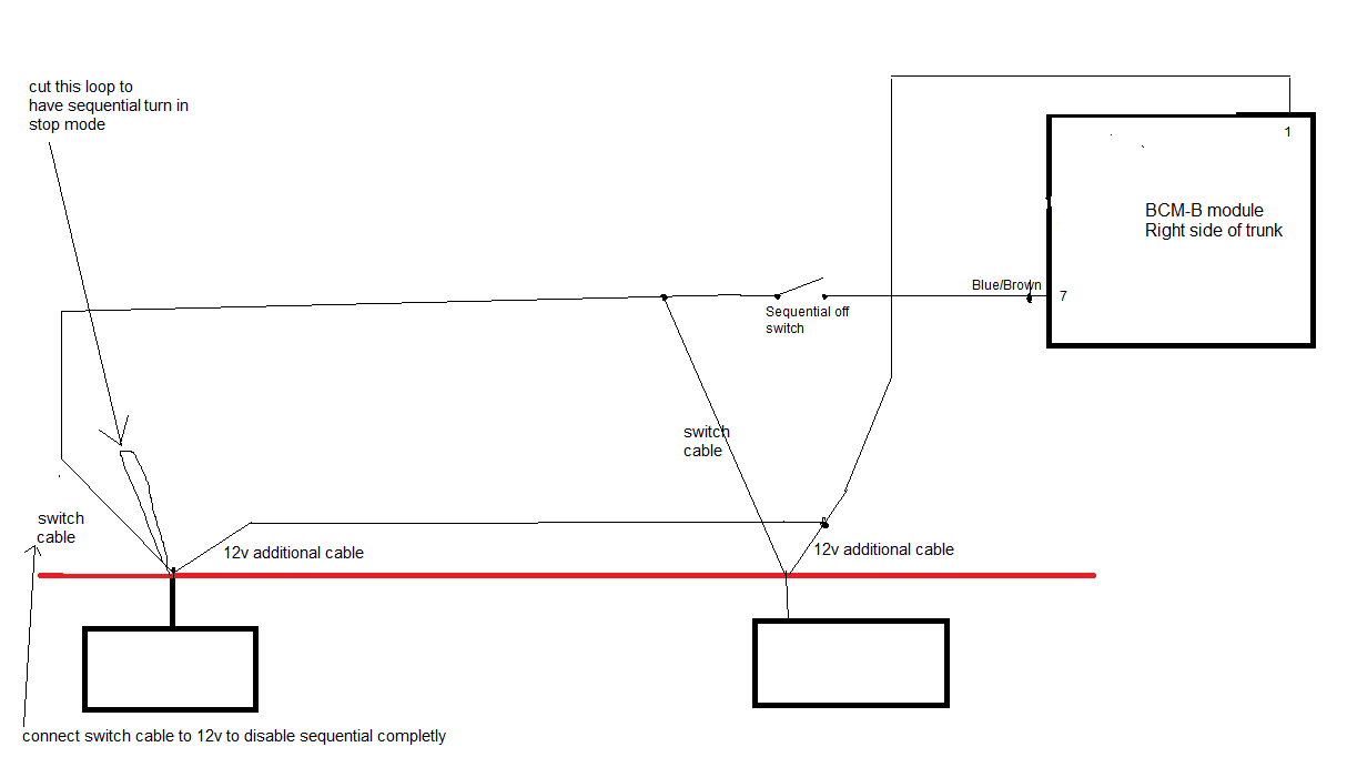

So, the long awaited mod finally done! This is the real thing: US-style red tail lights with amber sequential turn signal. MAN, they look fantastic!
The ecu that does the magic is now hidden probably inside the lights, so one less thing to worry about. As with the previous version there are three wires coming out of the light:
-A red wire marked "12V", that was connected to pin 1 of the BCM-B module that is located on the right side of the trunk, as shown on the diagram below.
-A brown wire marked "Seq. Switch off" (I simply insulated it for the time being as I don’t want the stock function)
-A red wire that has a loop (I cut the loop as I want to have sequential function while braking)
Here is the installation diagram and the photo of the BCM-B for anyone interested:

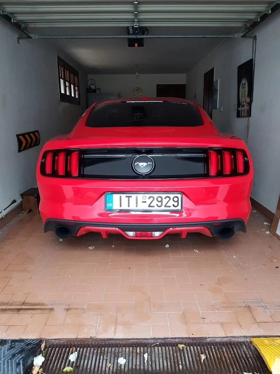

Here is a photo of the car inside my garage. In reality they look so much better!
This is a very simple video inside my garage, because it was raining like hell, I was alone and I could not record all the functions of my new tail lights (such as turn signal while the rear parking lights are on or while braking). I will try to post a complete video with all functions during the weekend and post it here.
