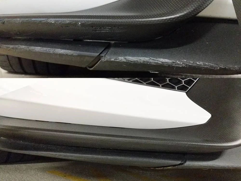

UPDATE: Instead of replacing the whole splitter - I have decided to minimize the scuffing with a little self repair. Will replace it in the future when its really damaged. Reality is, it will keep hitting crap on the road.

Update on fix:
Started sanding it. This is the first pass sanding using 120grit sanding sponge.
Did a few minutes moving in one direction.
Next, will be another pass using 220grit and higher until its smooth.
Will then clean it up and finish it with VRP Plastic Protectant
or
Do an experimental paint approach by using a soft sponge to dab paint in the damage area. So that there is some texture to match the original.
Any ideas/suggestion REALLY welcomed.
Here is a before(top) and after(bottom)
