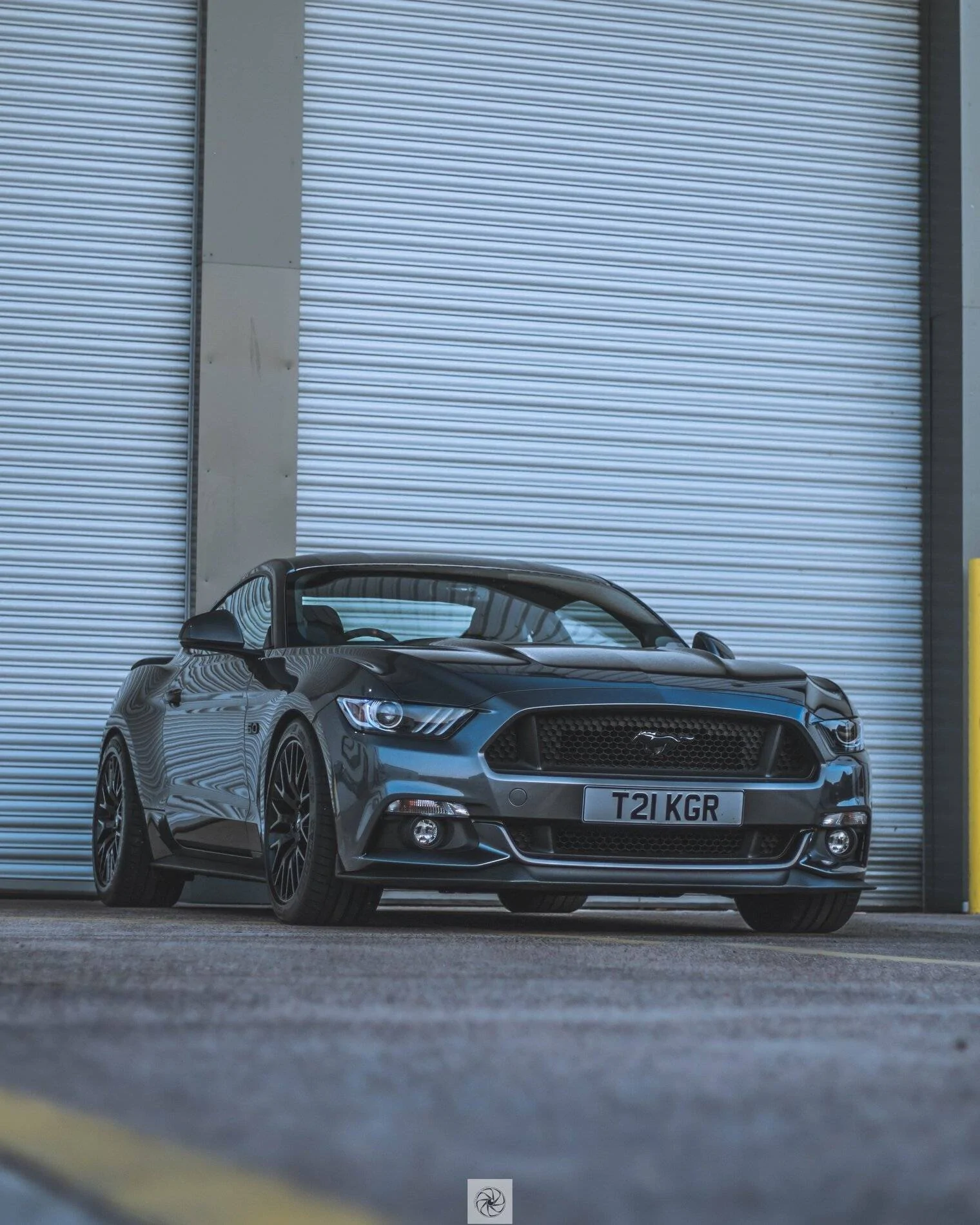

I've had a few different combination on mine. Ended up with 23mm at the front, 20mm at the rear. Eibach pro lowering springs. Perfect for me, sit's real nice. Excuse the gloomy photo, but you can see how the fronts sit well;
