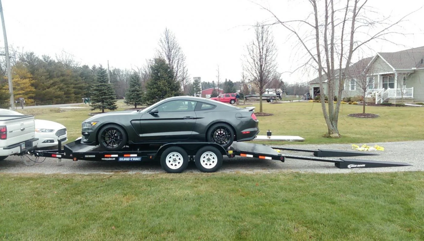

I'll tell you this. My race ramps have a 6.3 degree angle and with no splitter on yet I have 1.5" or so. But as I pull up on the trailer onto the steel ramps it becomes closer. That's why I put the scissor jacks under the dovetail to prevent the trailer from sinking as the weight of the car compresses the trailer.
