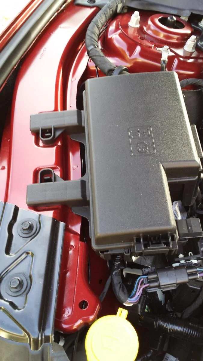

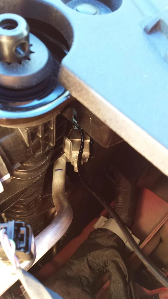

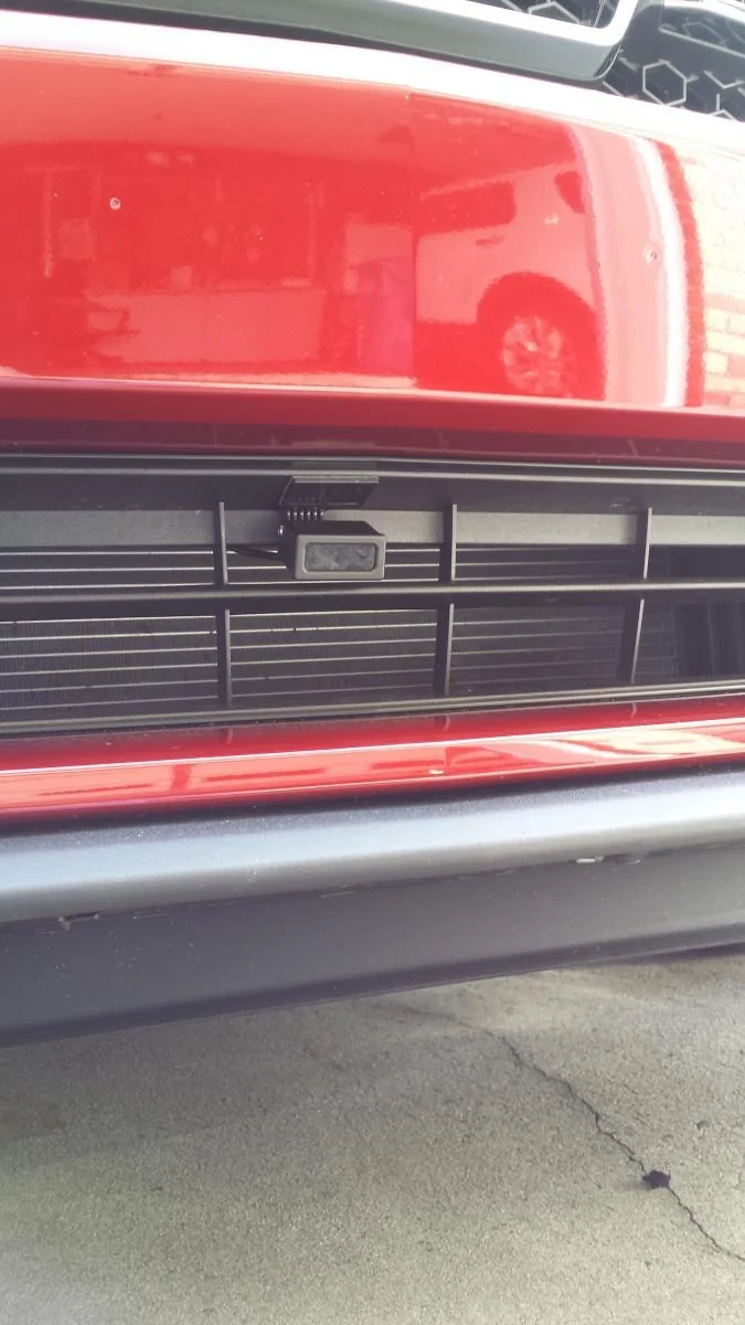

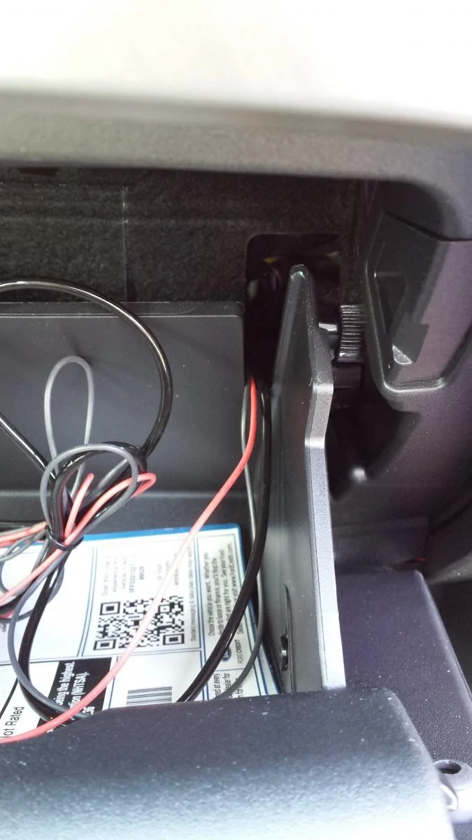

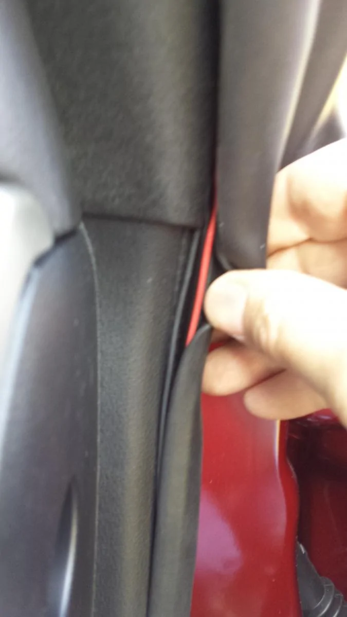

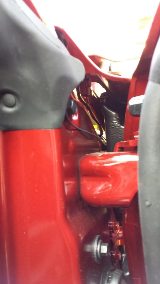

Got the curb alert mini installed and working. Numerous lessons learned with recommendations and photos.
1. With the hood up I took a straightened coat hanger and pushed it
The pictures should help out with my description of the install.
Thanks so much for the install info and pics. :hail:
I read elsewhere that it might be helpful to first install with plain double sticky tape* while testing and adjusting, that way you can change your mind on location or exact angle of surface to choose. (* tape can even be made less sticky by applying to your pants a time or two, so you it can come off easily).
Can you describe the test you planned to see how wide the beam detects at it's farthest and closest activation?
Can you post a picture several feet away so we can see how noticeable or not that the sensor is? Though I am pretty sure it is MUCH less noticeable than a crunched air dam. :eyebulge:

Appears the field of view of the sensor it about 10 deg left and right. Outside of that it would not see the 4 inch high test box at all. IMO to have complete front end warning would require at least 3 sensors: two additional sensors with each located on the edge of both sides of the lower grill.

A couple of problems I see with this install even though it WILL work.
1) You shouldn't wire directly to the battery -- it will create a parasitic drain on the battery. And although minimal, it will draw power. It should run to the fuse box to a circuit that is only powered on when the "key" is on. And if you DO run to the battery, you should have a fuse between the control box and the battery (as close to the battery as possible).
2) The routing of the sensor wire (and power) through the fender and under the door frame seal. That's sharp sheet metal under there and not a good way to run a cable. This should go through the firewall.
