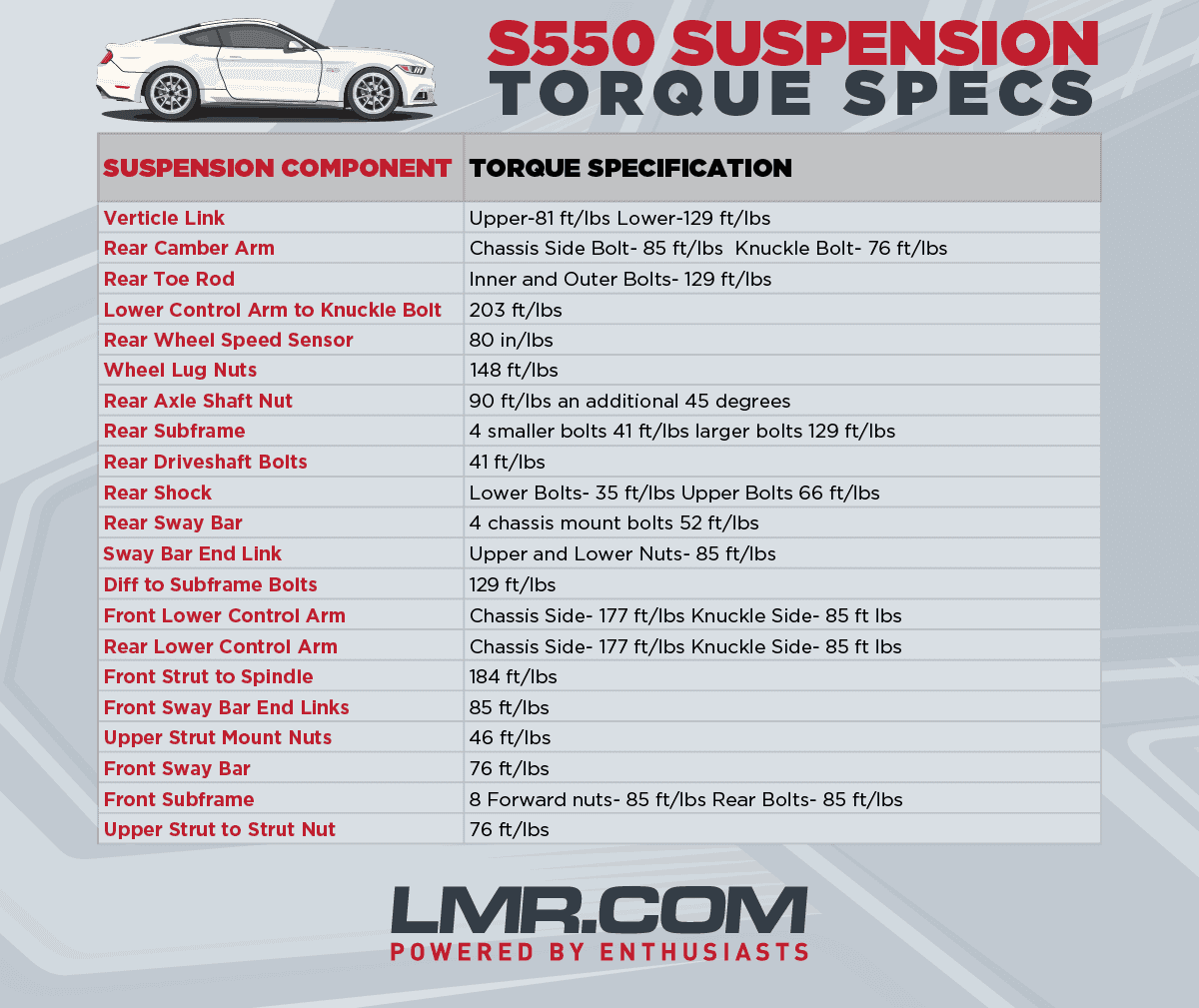

Hey this is junior from Need4SpeedMotorsports, i just did the sway bar links on my car this past weekend. I suggest having both wheels up in the air and doing both sides at the same time for the front and rear. I tried to do one side at a time and was having trouble getting the links to line up with the holes. LMR.com has a sheet on their website with factory torque specs.

Thank you guys for the input. Before checking to see if anyone responded I did the rears and one wheel at time. Yes it was difficult to line the bolts into the stabilizer bar. I kept lowering the jack to get close to ride height and I got it. Tomorrow I will do the front and raise the front and take off both wheels. Thank you again. It was difficult to get to the torque to 85 ft lb. I used the rachet wrench and allen key to tighten then I tried the torque rachet but it appeared that it never reached the click sound. Any suggestions?

Yes, once you are a little more than "snug tight", you should be able to achieve 85# without having to hold the pin still.
