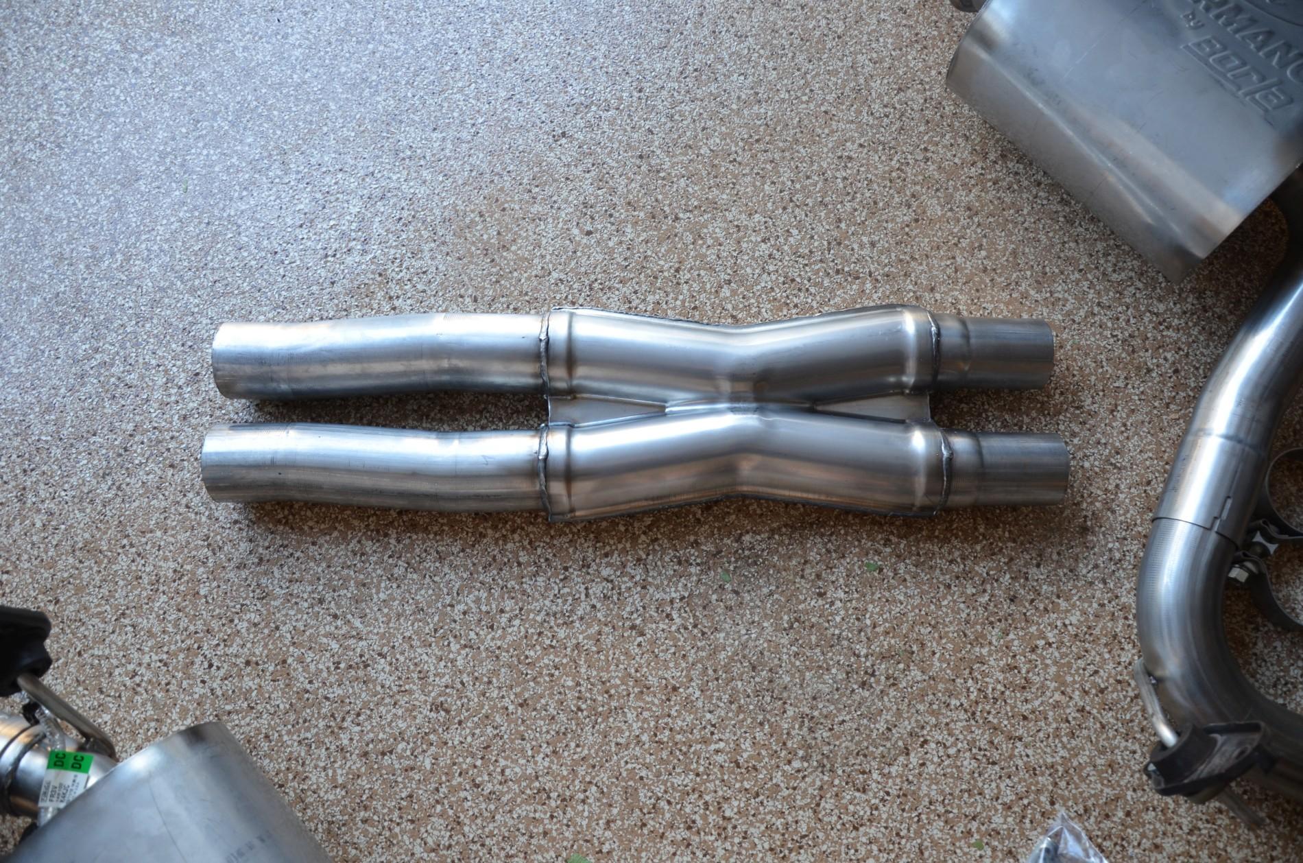

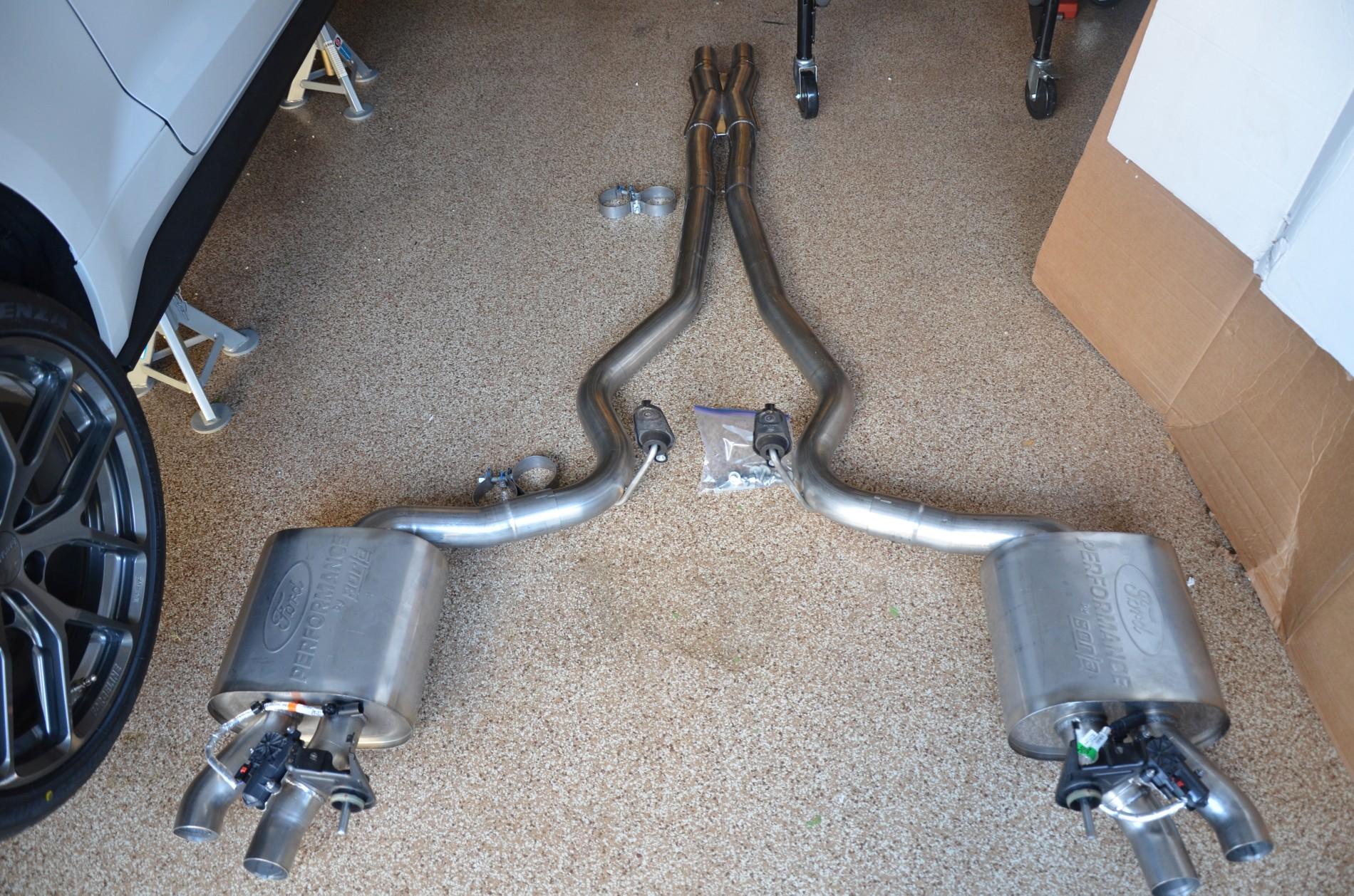

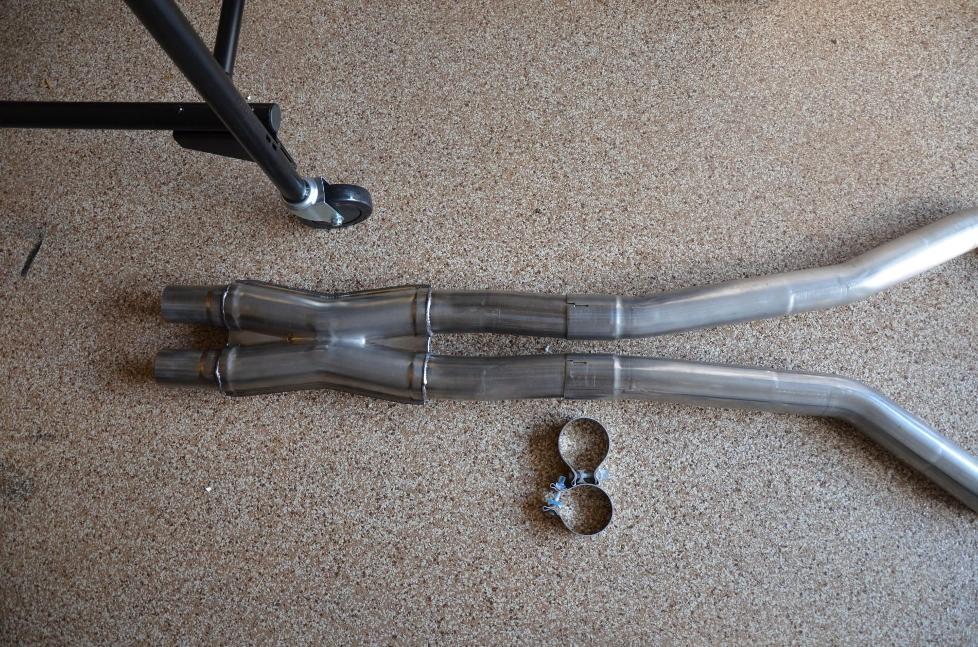

For completeness, it looks like Borla has continued to improve the design on this exhaust system. I purchased and installed a Ford Racing Borla exhaust system (largely based on this review), and have the opportunity to update a few changes.
The box is fixed; July 7 2017 manufacture date, no change to the instruction manual.
It didn't look like major changes...
...the big change is the x-pipe
I'm still working through a couple heat cycles, but the clamps appear to be holding the muffler in place without allowing rotation at the rated 35 ft lbs torque. I had no toubles aligning the muffler tips in the valence, so maybe the bend changed a little bit on later releases.

Superb. Matt, a huge thanks for sharing the changes that have been made.
A big thanks to Borla for listening.
I pulled my Borla system to access the driveshaft and put everything back in today. It really is a robust system and I'm thankful for the attention to detail.

I don’t see where Dave ever came back to address the different x pipe.
