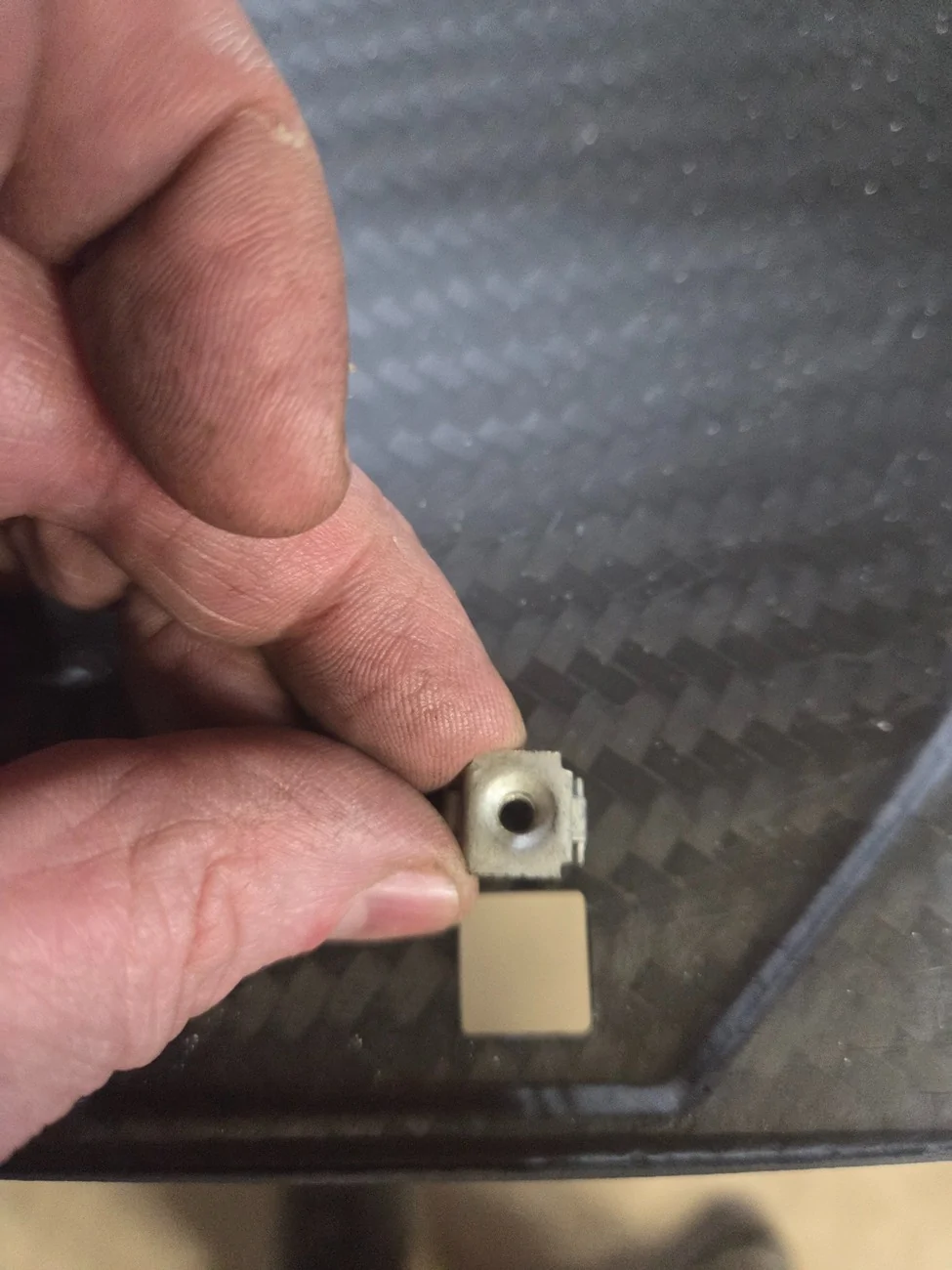

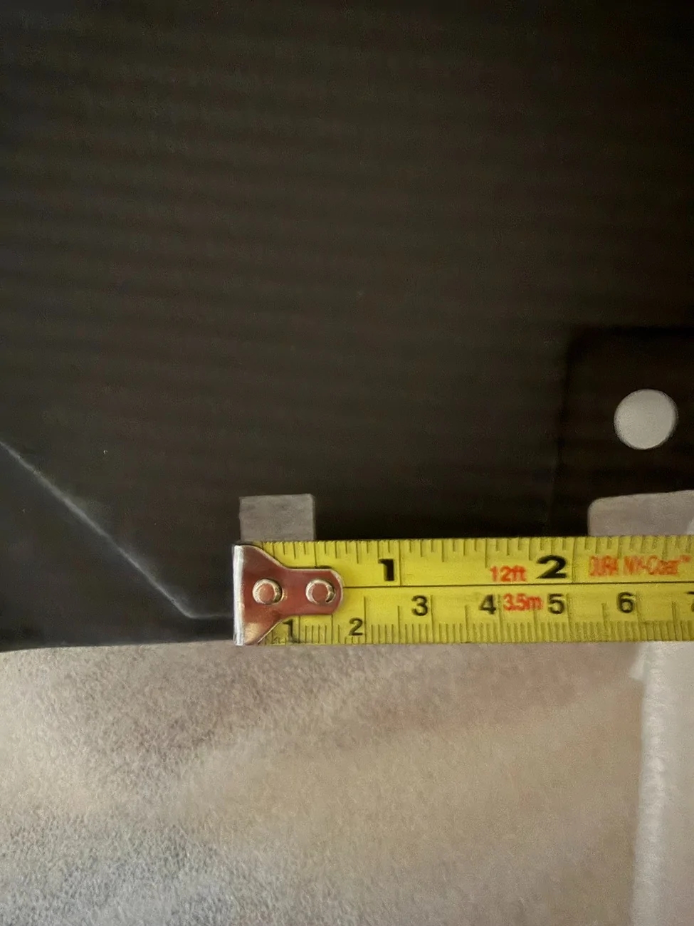

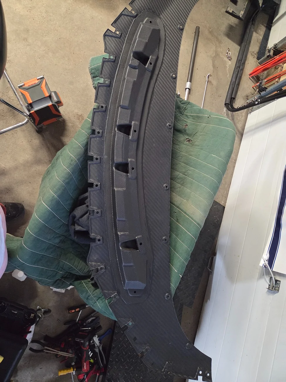

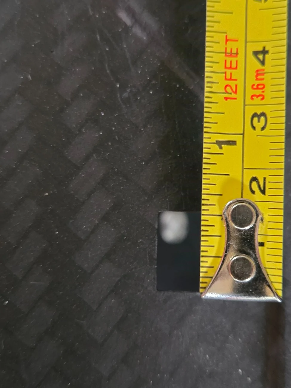

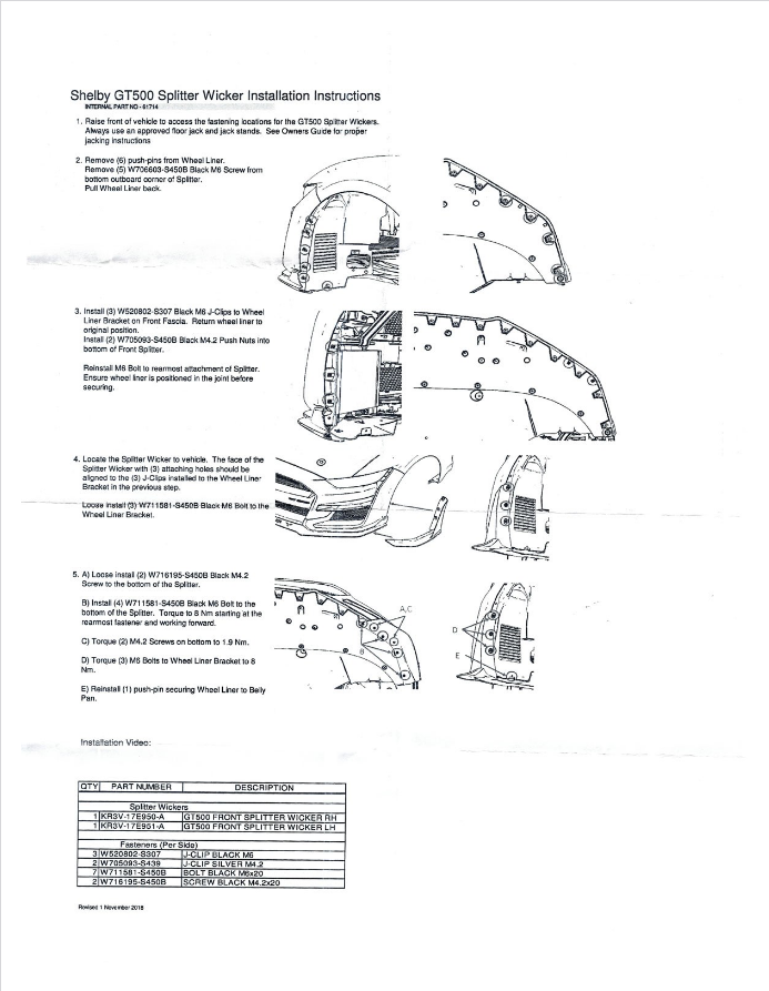

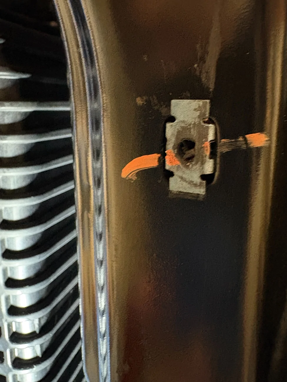

Was wondering anyone have seen this issue? Trying to install the Ford Performance CF Belly pan and the bolt retainer clips for the splitter wickers don't fit. Been working with Anderson Composites for the last couple of months. They informed me that there are no included clips and I confirmed with Ford that the clips are the same for the 20-22 GT500s. We have confirmed the size is correct to one they have in stock, but the clips from the stocker just don't fit.

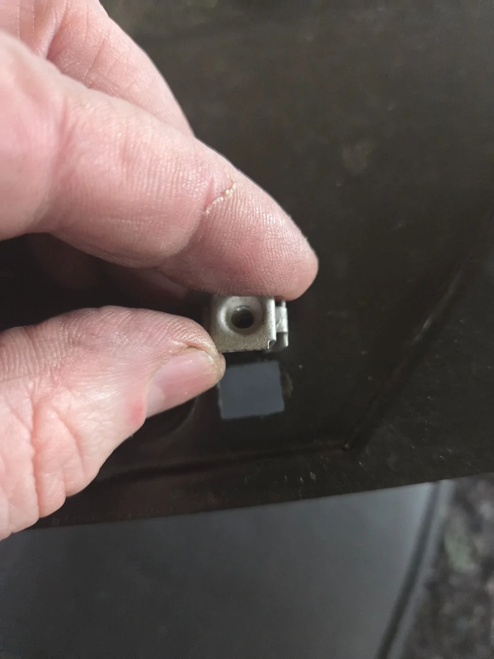

Finding the right clips is always a challenge and It's nice when the right hardware is included. For reference is the OEM clip style mounted in the square frame hole to mount the belly pan mounts on my car.
