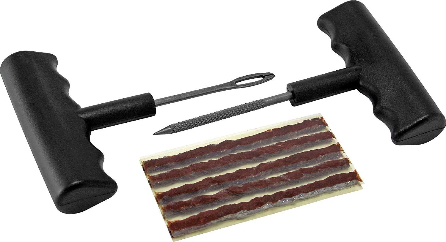

When you get a nail, if you are having it repaired, always have the tire dismounted and have them use the plug/patch. It is the only way to make sure that it holds up safely.
If you use something like this and just patch from the outside, it will work, but IMO its just a temporary fix.
I keep the DIY patch kit in my car as I dont have a spare, and its better than trying to use that sealant junk.

When I was younger, I worked in a service station where I bet I plugged thousands of tires with two types of tire plugs: The leather type shown above for bigger nails and screws, and a rubber string type used with glue for smaller nails and screws. We hardly ever had anyone come back and complain. About 2 y ago, my wifes Acura tire had a nail about 1" in from the edge, the major chains refused to fix it. Went to the local smaller tire shop, they plugged it and didnt even think twice about it. Doesnt leak a bit of air. Then right after that, same thing on my truck, the major chains wouldnt fix it either. Had it plugged at the smaller shop, same thing, no leaks. But these are guys who do this all day, I dont know if I'd recommend plugging it yourself, you may not have the same quality of plug and or skill level. But I'd have them do it again for me... The major chains claim plugging is bad, it needs to be patched, I'm sure there are a lot of folks on the net who claim its hogwash for the normally used tires. Now a track tire, probably an entirely different story.
