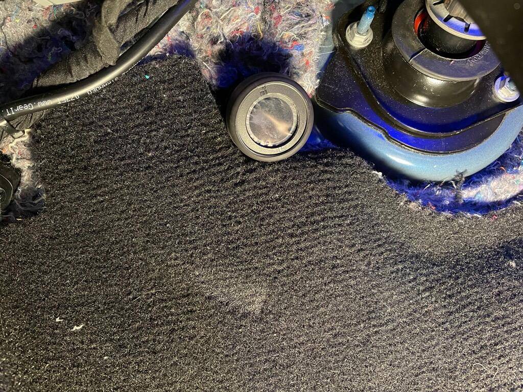

Best sound transfer occurs when the clear membrane in the cap is tightly stretched. Super loose results kazoo sounds. The membrane can lose tension during the install or when ambient temps change. Hit the clear membrane with a hairdryer or light heat from heat gun for a few seconds.
It should NOT look like the pic below. There should be no wrinkles. Should feel instant tension when you boop it.
