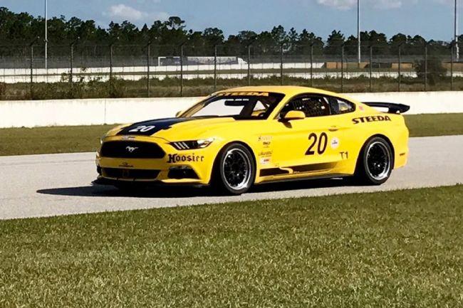

The parts in our kit has been track tested & a proven winner as shown by our Steeda's #20's success:
https://www.steedablog.com/2017/11/01/steeda-wins-scca-2017-tropical-endurance-series-championship/
http://www.mustangandfords.com/news/1704-steeda-q500-mustang-sweeps-weekend-with-two-wins-and-runner-up/
Happy to put you in contact with one of our build experts that has put together the above package & pushed it on the track.
Shoot me an email with your contact info to [email protected].
Best Regards,
TJ

Steeda, I love the parts, but come on. That yellow race car has completely different springs and shocks than the kit the OP was posting about. Its not even apples to oranges.

The point of the post was to make the OP aware that we track test our parts & many of the parts in that kit started off in our #20 development vehicle & were designed for the aforementioned package.
The #20 car has gone through many transformations & test sessions:
http://www.mustangandfords.com/featured-vehicles/1705-not-so-mellow-2016-steeda-q500r-ford-mustang-racer-in-yellow/
And while the Steeda Q500R looks fantastic, many of the go-fast enhancements are hidden under the skin. Keeping the contact patches flat under corning is the name of the game so Steeda went into battle with its Pro-Action adjustable dampers and recently released progressive lowering springs. “We’re running all equipment from our catalog, but we use spring rates that are way higher than what you’d want on the street,” explained Vitale. “We just introduced the progressive spring (PN 555-8241) that’s on our website. It came from what we’re doing with the race car, and match nicely with our Pro-Action shocks, the same ones that we use on our Q-series street cars,” he added. “It’s a spring that we recommend for track use, but it can absolutely be used on the street. It’s been very popular. You can use it with stock struts, but we recommend using our Steeda Pro-Action or Koni dampers.”
