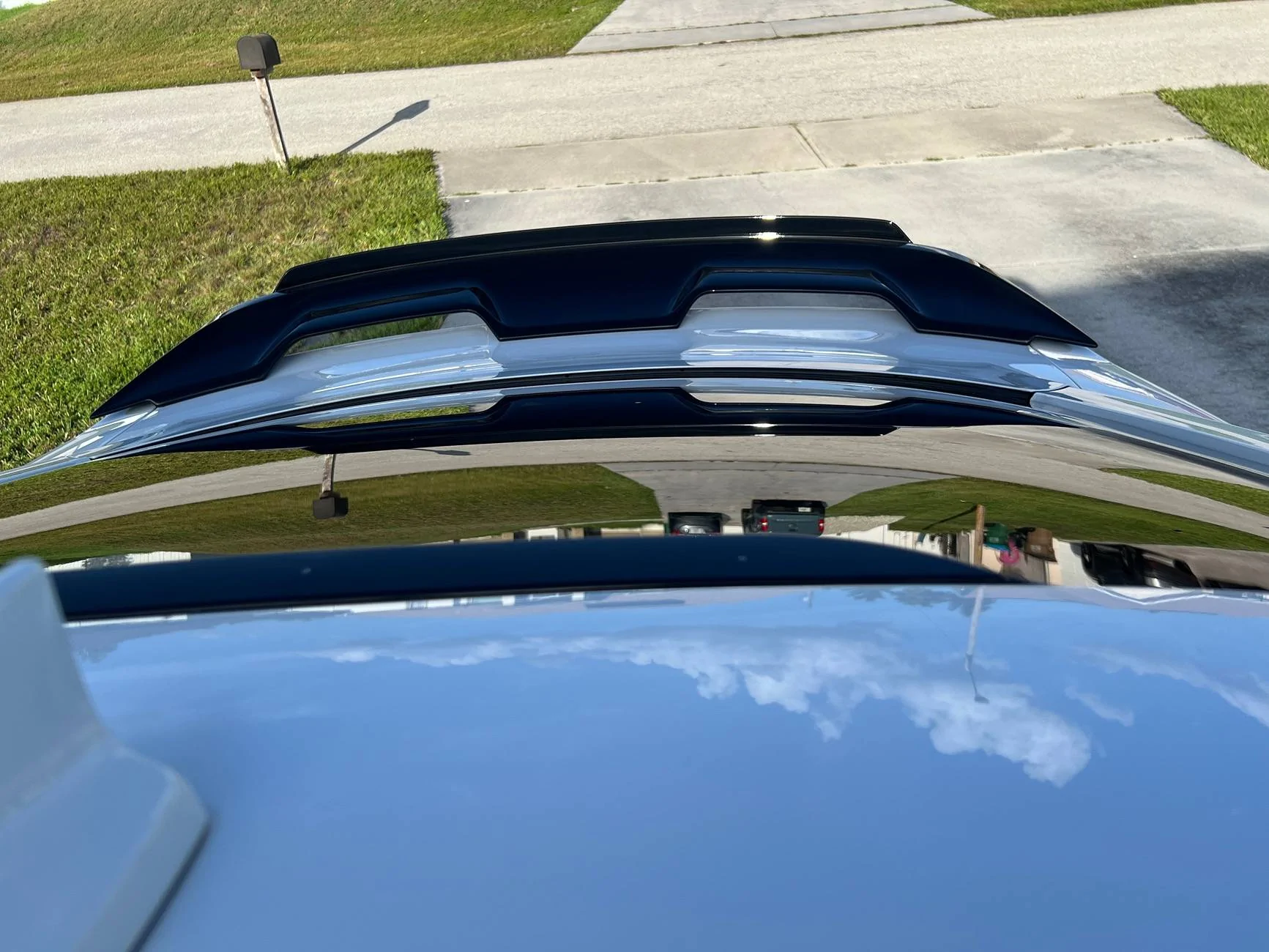

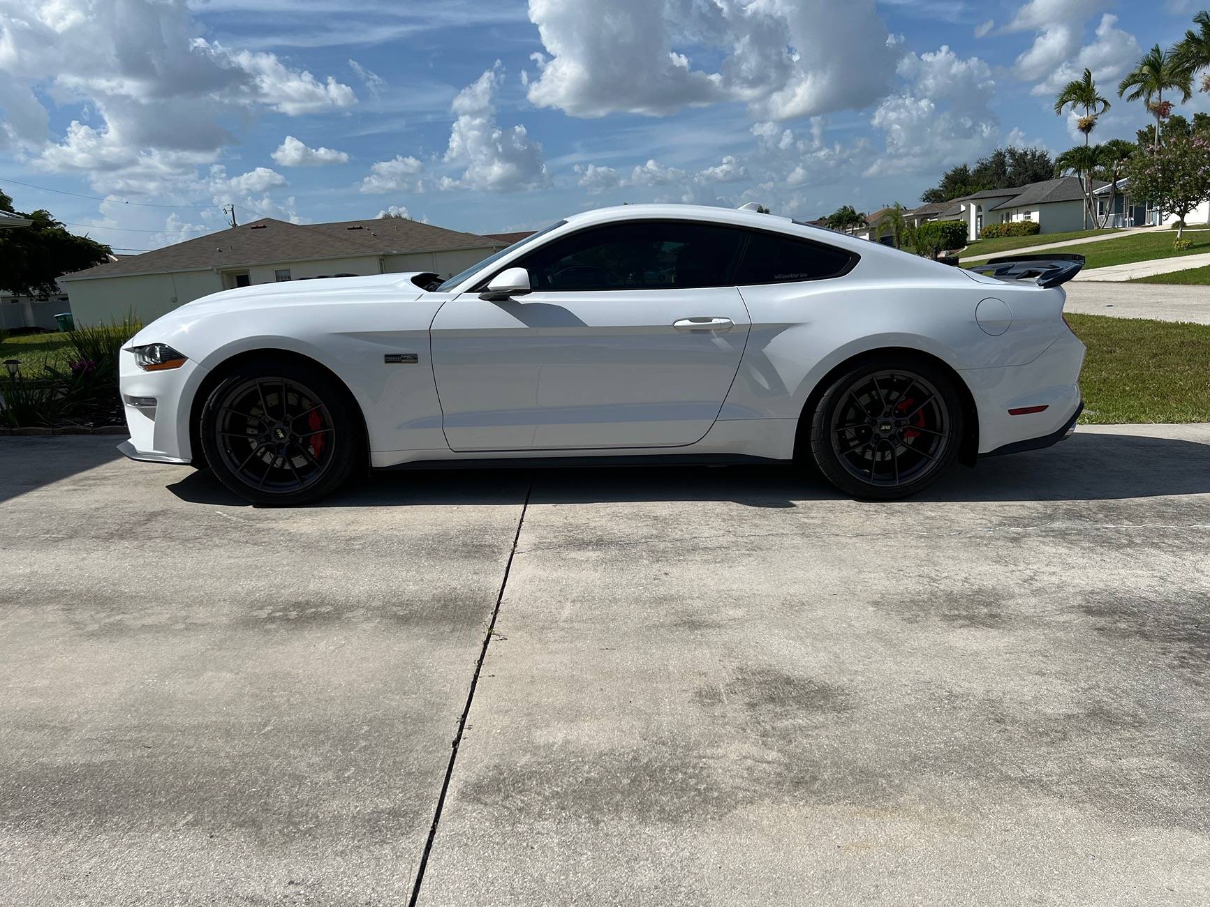

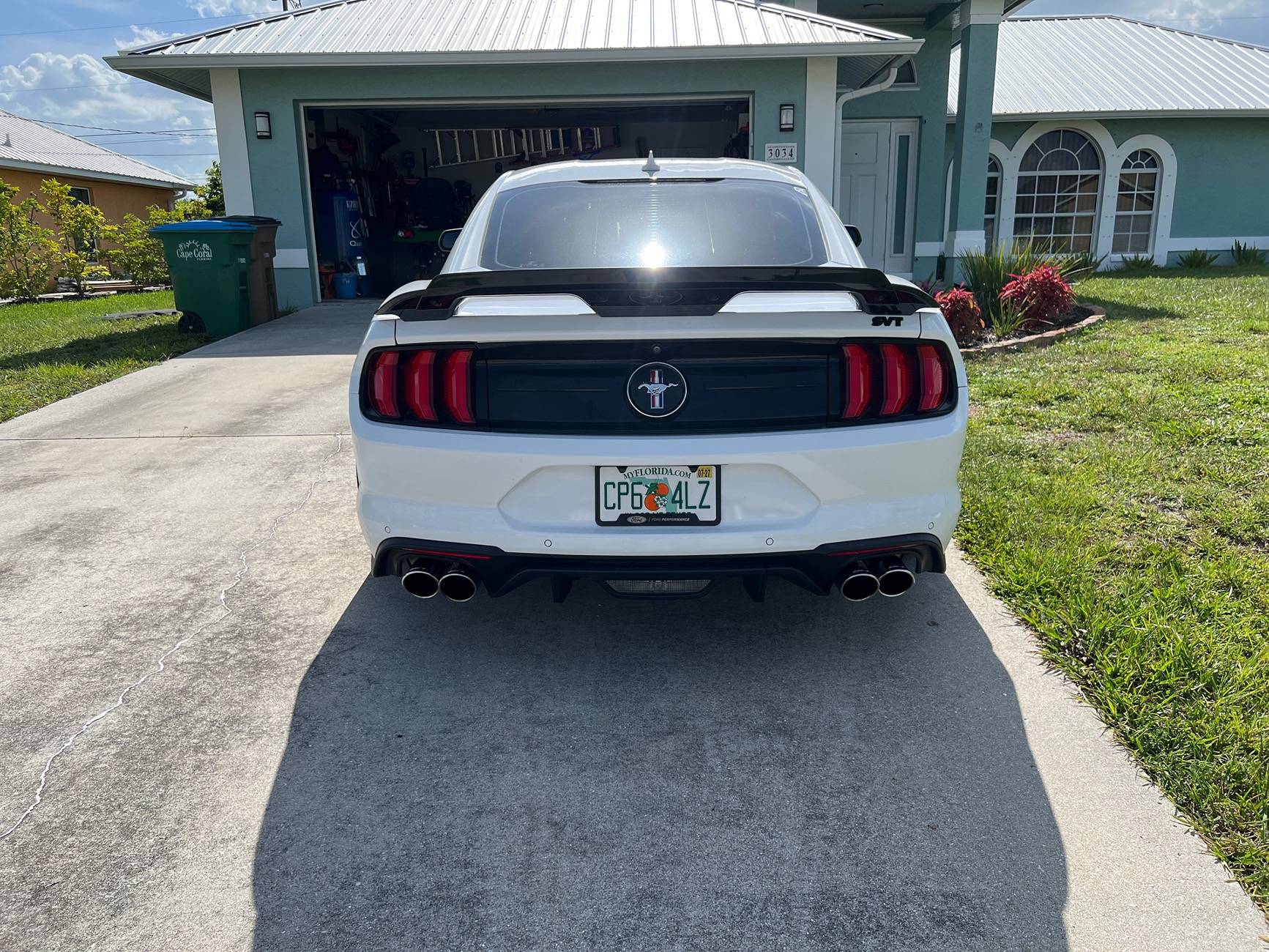

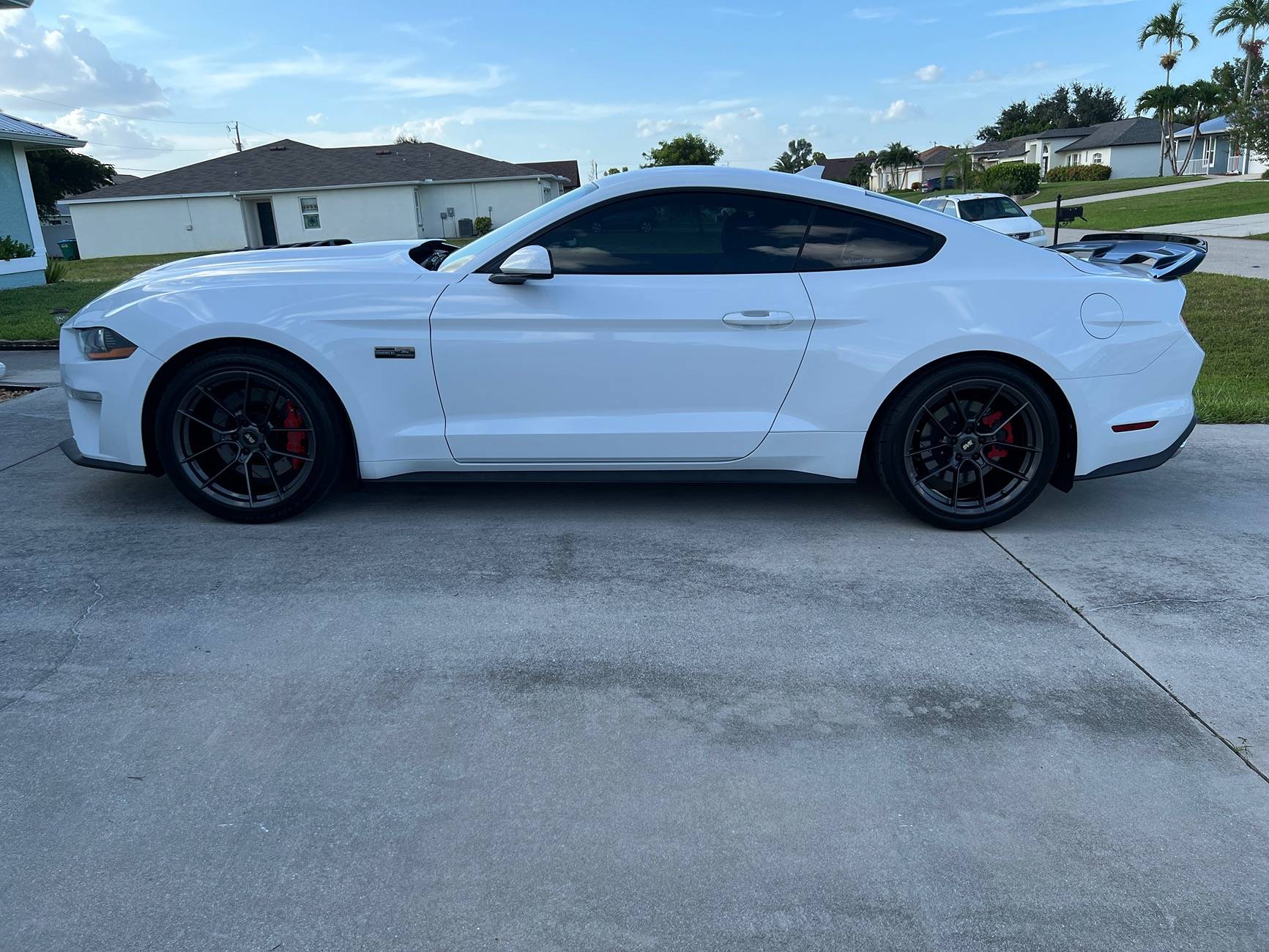

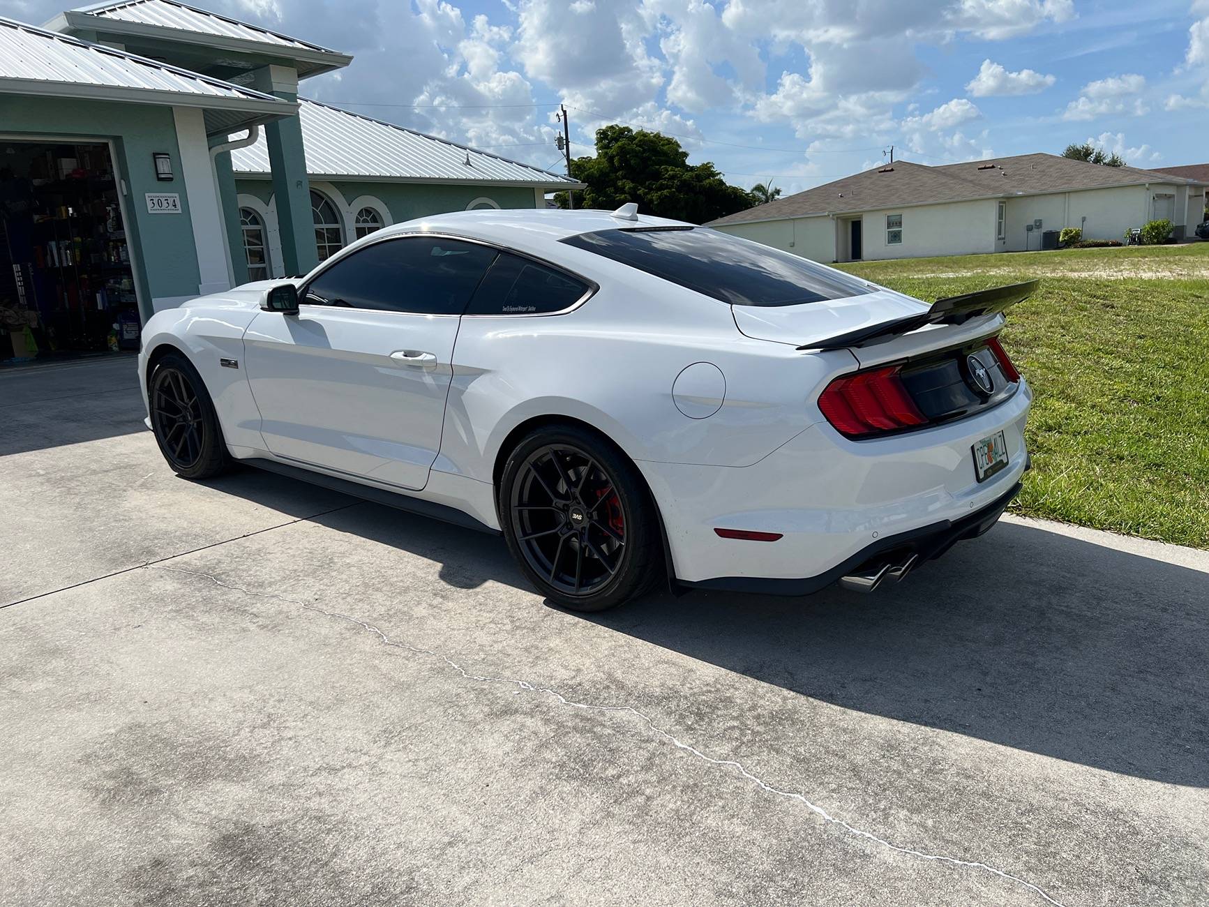

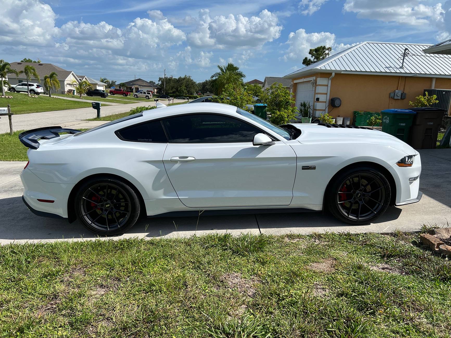

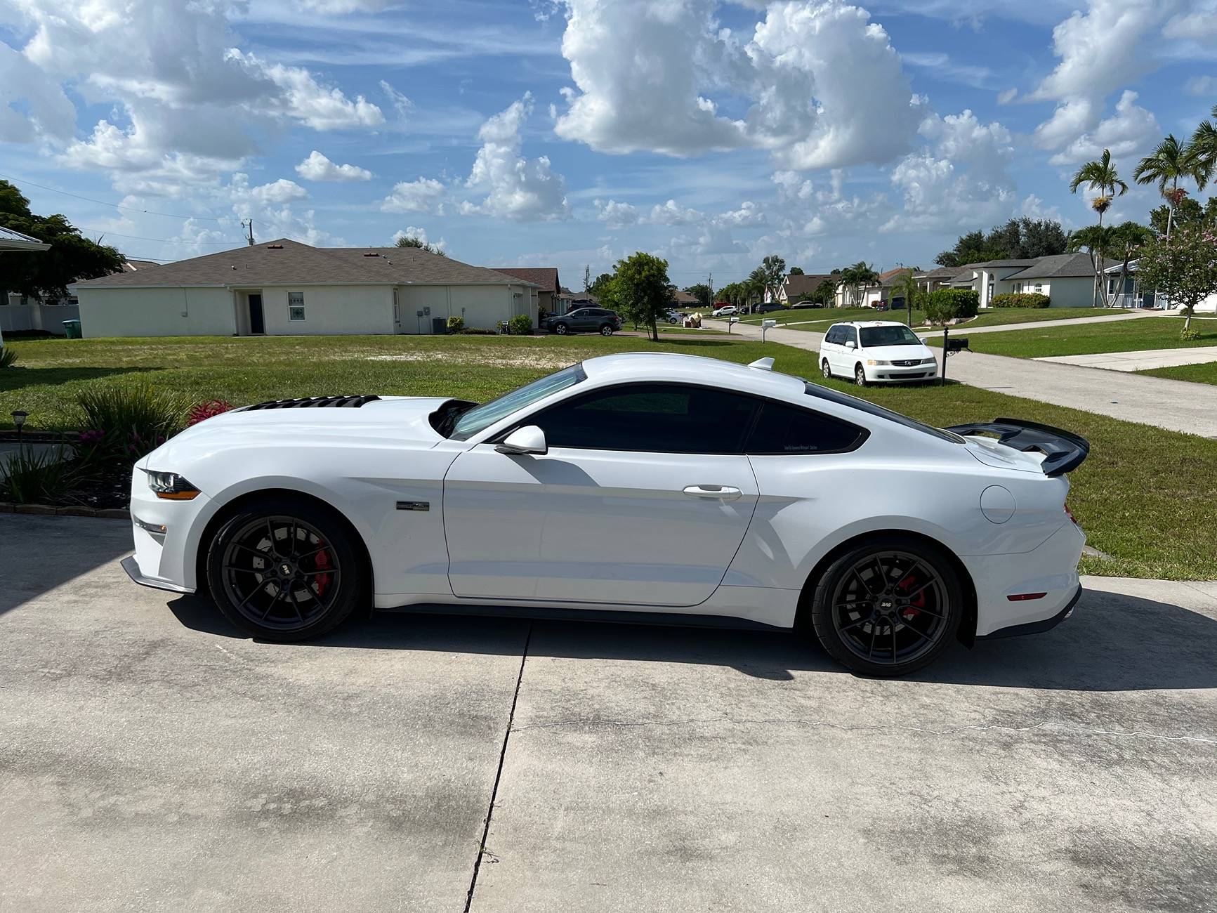

I received and installed the Ford Performance GT500 rear spoiler today, July, 27, 2025, install was not hard, the GT500 spoiler uses the same holes in the trunk lid that the factory blade spoiler used so it was removing the factory spoiler, clean up the double sided tape from the removal and installing the Ford Performance GT500 spoiler, it comes with double sided tape pre installed and four studs with four nylock nuts. It also comes with the Gurney Flap and I installed that along with it, that is just four torx screws to attach it to the spoiler and remember to put some blue loctite on the screws before installing them with the Gurney Flap. Over all this is a quick and easy upgrade and really changes the rear appearance of the Mustang.
