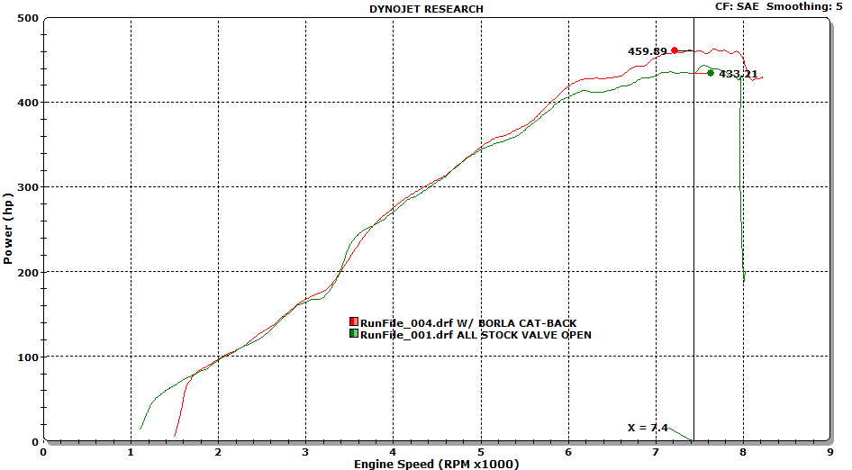

So this system flows as well as the ATAK, but has less aggressive and quieter mufflers?
Flow from the catback is somewhat irrelevant as anything after the cats doesn't have nearly as much effect as the headers and cats themselves. Unless there is a severe crimp in the pipes all of the catbacks would flow about the same.
JN66
Feb 28, 2016
82
1,251
510
British Columbia
2017 GT350R, 1966 Couple (347 Stroker)
That seems to be the consensus. Almost sounds too good to be true.
Any confirmed HP increase? Or do we need to change out the headers for that.
Grimace427
Dec 6, 2013
6,467
1,702
NoVA
2011 Mustang 5.0
Don't expect any gains from a catback. The majority of the exhaust restriction is in the cats followed by the headers.
