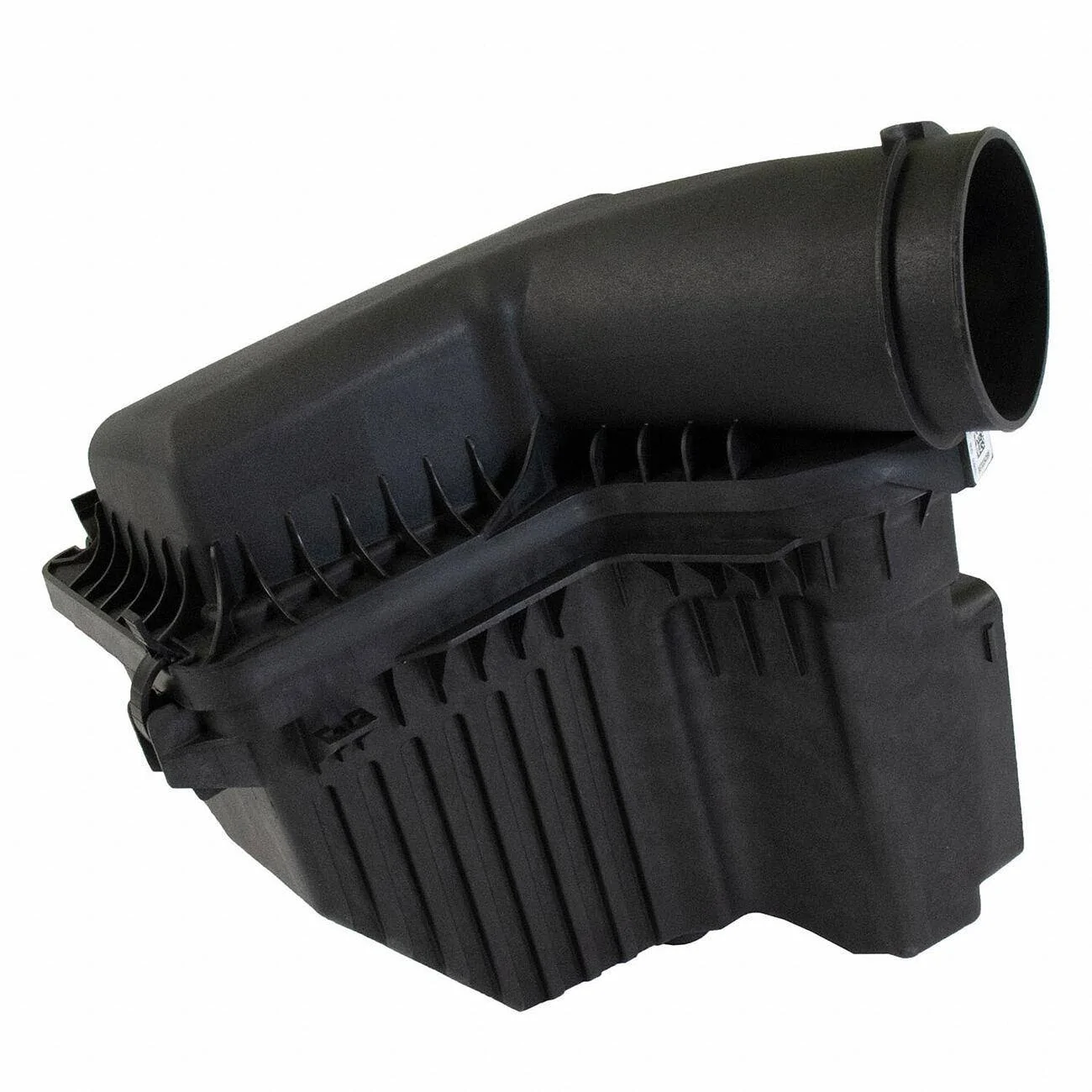

What is the ford part number for the stock air cleaner lid on the 18-21 Mustang Gt 5.0, please

I did a quick search, "coyote 5.0 2020 air cleaner lid assembly", resulting in the following:
https://ford.oempartsonline.com/v-2020-ford-mustang--gt--5-0l-v8-gas/engine--air-intake
https://parts.lakelandford.com/a/Ford_2020_Mustang/75080213__6703363/AIR-INTAKE/JC15285.html#1
https://www.ebay.com/itm/186478187396
I do not think this type of assembly, you can buy the lid only. You'll buy the upper and bottom sections as one unit. Two examples above are new, the other, used on eBay.
I did not Google for the Eco parts. I suspect same: buy upper/lower together is the only option when attempting to source an upper.
Edit,
This is a similar thread.
https://www.mustang6g.com/forums/threads/part-question-upper-airbox-lid-for-18.123313/
It seems for the 5.0, it's the entire assembly.
The Eco cover was referenced in the other thread.
I also found references for the GT500, 5.2 liter, top cover.

well I got one from a guy from Florida that said the lid was from a 18-21 5.0 mustang and here is the ford part number on the lid FR3C 9643-BD. The problem with it is that the part of the lid that is connected to the the rubber coupler is too small at 3 1/4 inches and the stock lid on my car is 4 2/8 inches. As hard as i tried the clamp would not tighten up. It caused massive errors when I drove the car. when I reinstalled the original lid all was well. so did he send me one for the 4 cylinder mustang?
