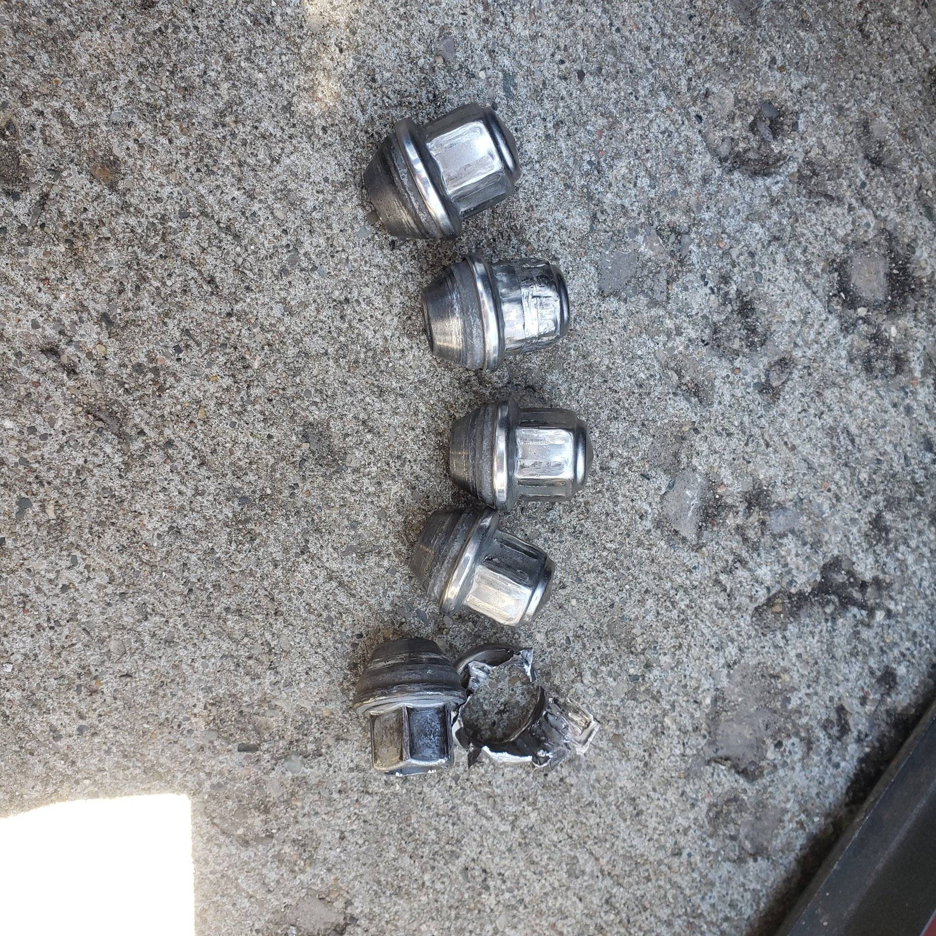

It shouldn't be this hard to remove 5 plug nuts. Simple brake job turning into more than I wanted.

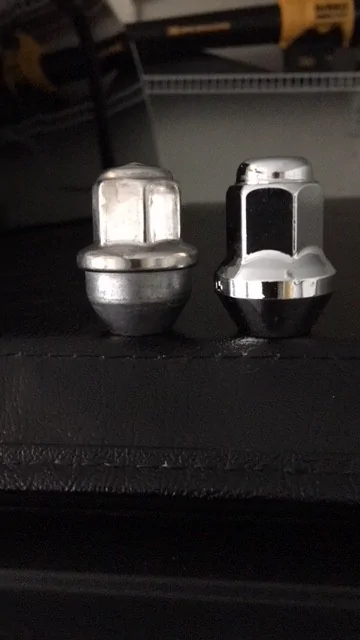

They look identical to my 2018 F-150. Read horror stories about them, so replaced them right away with Gorilla 61148CXs, which have an even greater surface area (very important). They use the same socket/wrench (13/16s). Here is a photo of both:
Thanks for sharing the part number and photo!
