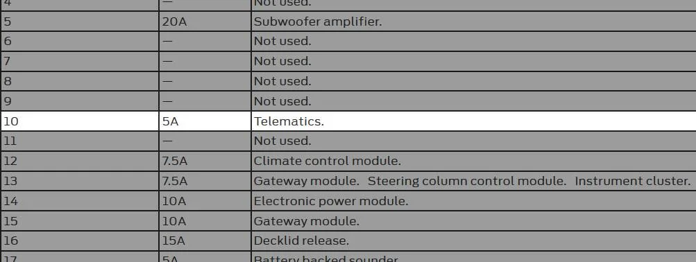

Right side of the passenger foot well, there is a triangle-ish shaped panel - lift up, swing it towards you, pull out. Fuse panel is right behind that triangle.
I'd wager your owners manual is the same as mine as the fuse chart i used came from the base 2019 Mustang owner's manual, not the GT350 supplement. There are two fuse boxes - engine compartment and passenger compartment. Passenger compartment fuse 10 is listed as telematics:

Sorry, I meant to address that. I don't know how they're all equipped, but someone else has stated that it is a 2019 and up thing. My 2019 Mustang owner's manual lists that fuse as telematics, and I've confirmed that pulling it shuts off the modem. If you do not have a modem, the only other feasible way of collecting data would be through Wi-Fi, so it would appear you are clear :thumbsup:
