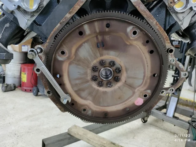

I bought a flywheel locking tool, however, it didn't work for me. Kept slipping off no matter what I did. In a search for other options I found this pic which worked for me. I didn't get a pic of my actual usage for it on the Mustang, but this did the trick! Figured I'd share for anyone else doing a clutch.

That is an idea I will be using when I do my transmission and clutch this winter. I will make a dedicated tool for the job.
