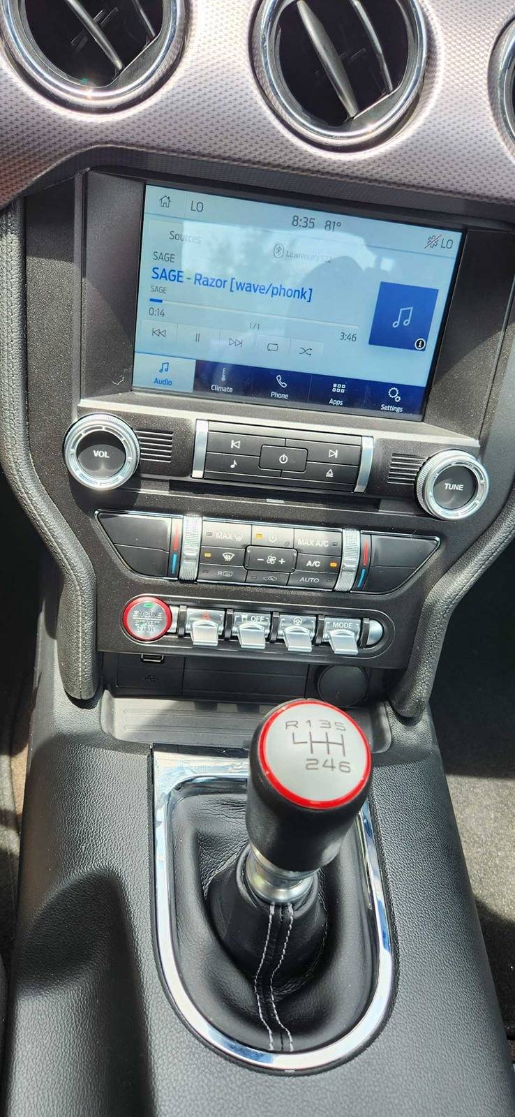

  2. Bought a 4dtech Sync 3 upgrade kit and replaced the base stereo with it - which also fixed my vent control issue. Added drive modes as a bonus.

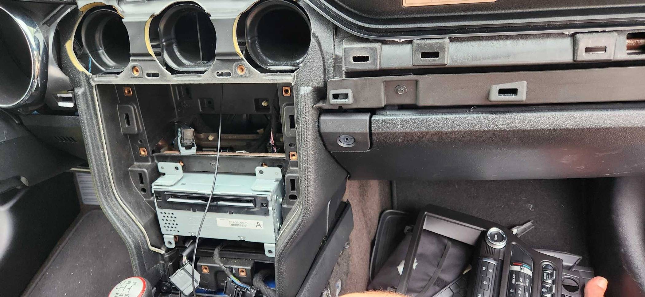

Taking apart the dash for the Sync 3 upgrade. 4dtech did a good job with the harnesses and installation videos. Though Forscan still shows some DTC codes I can't clear. I read about it in some other threads and will just live with it. Everything works properly.

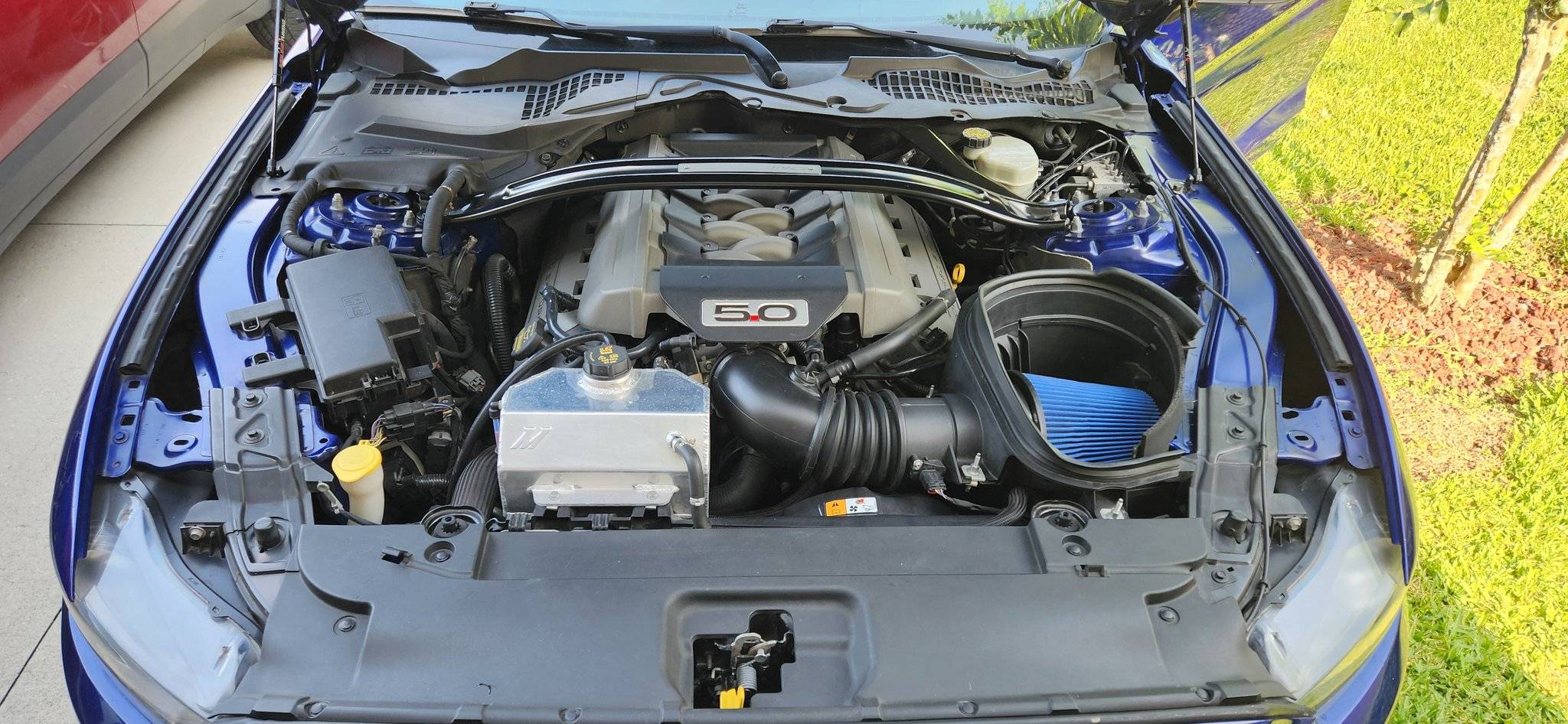

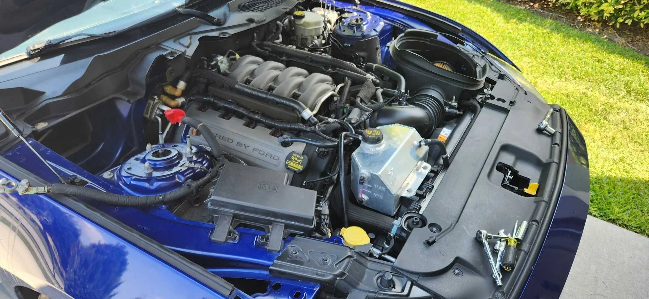

Taking apart a bunch of crap in the engine bay to get to the valve cover bolts. Side note, if anyone ever has smoke coming out of the engine bay, check these valve covers. From the factory, every other bolt is really a piece of plastic, and the bolts can come loose easily. Then the gaskets lose their seal, and oil starts to drip on the exhaust manifold, creating the smoke and smell. The gaskets were too far gone in my case, so I needed new ones, but if you catch the problem early enough you may just be able to tighten the bolts. Like $50 though so no big deal, aside from the time needed to get them out. I replaced one of the plastic clips with an extra bolt where I saw it had come loose. No more smoke.
Also replaced the air filter after this - I have the power pack 2 (GT350 intake and throttle body + canned tune). Needed the GT350 air filter.

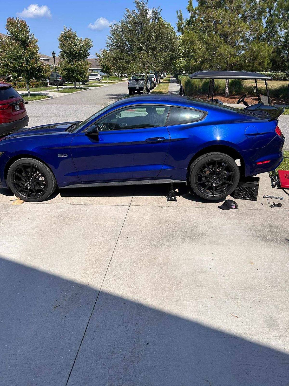

Replacing the exhaust. MBRP Street. You can also see some of the roof paint oxidation in this pic. Had to respray it. The Florida sun is merciless on your paint.
