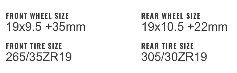

Does anyone know if this setup will work? I know that the rears will poke which I'm okay with, just curious if anyone has thrown a setup like this on their car and had rubbing issues or needed spacers? The car will be lowered on Eibach Sportlines. Thanks!

Front is fine, kinda conservative actually.
Rear is about an inch of poke. Clearly not designed for this chassis. Would probably hit the fenders if you’re lowered.

Need at least a 50 offset on the rear to get it flush or to get tuck a little depending on run width and tire selection.

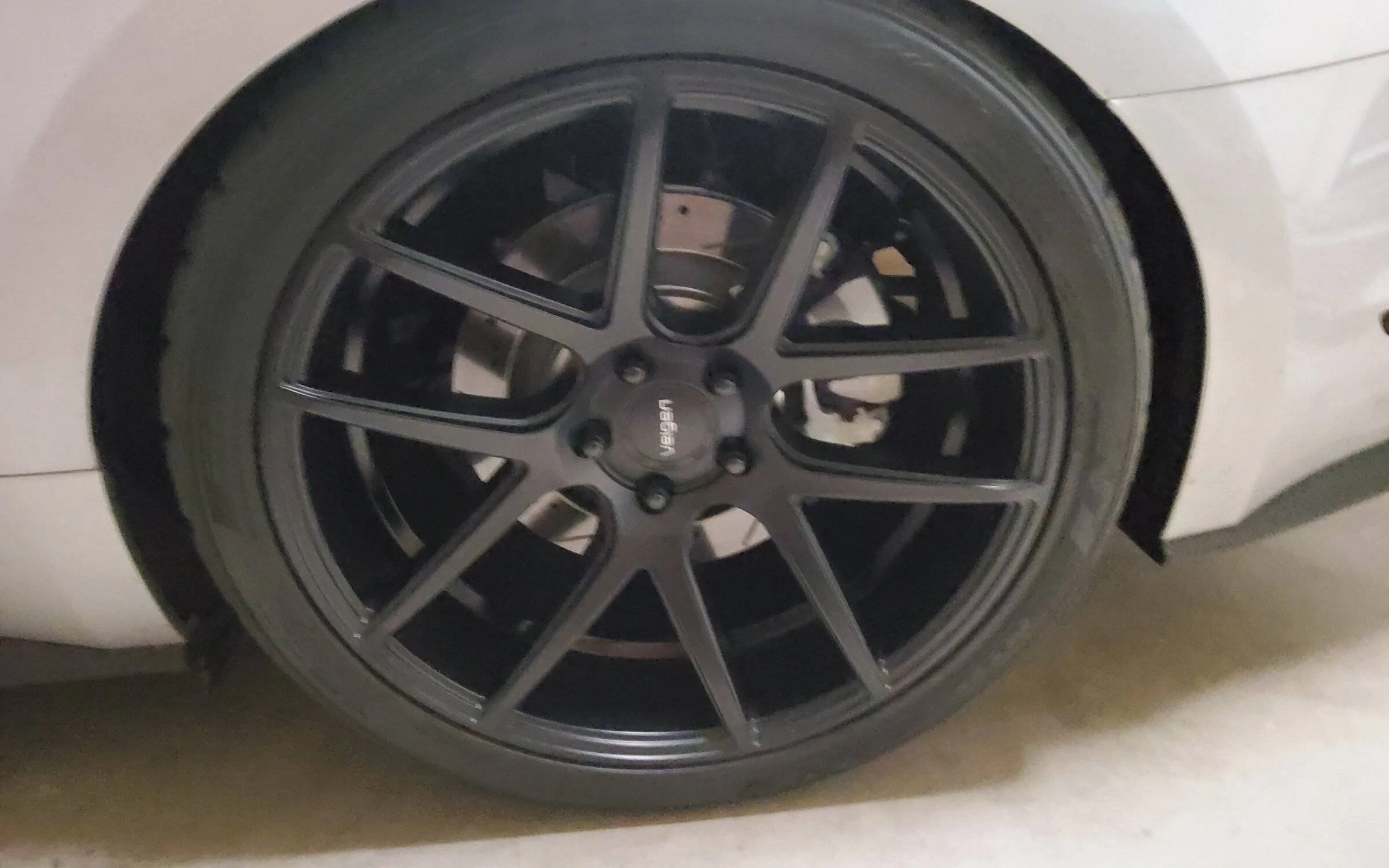

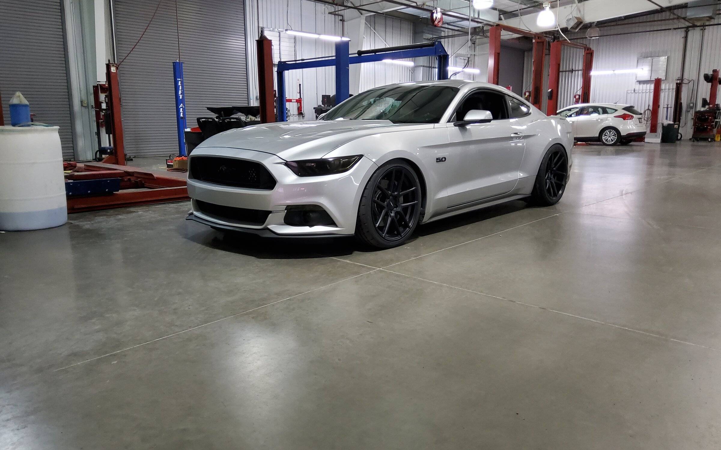

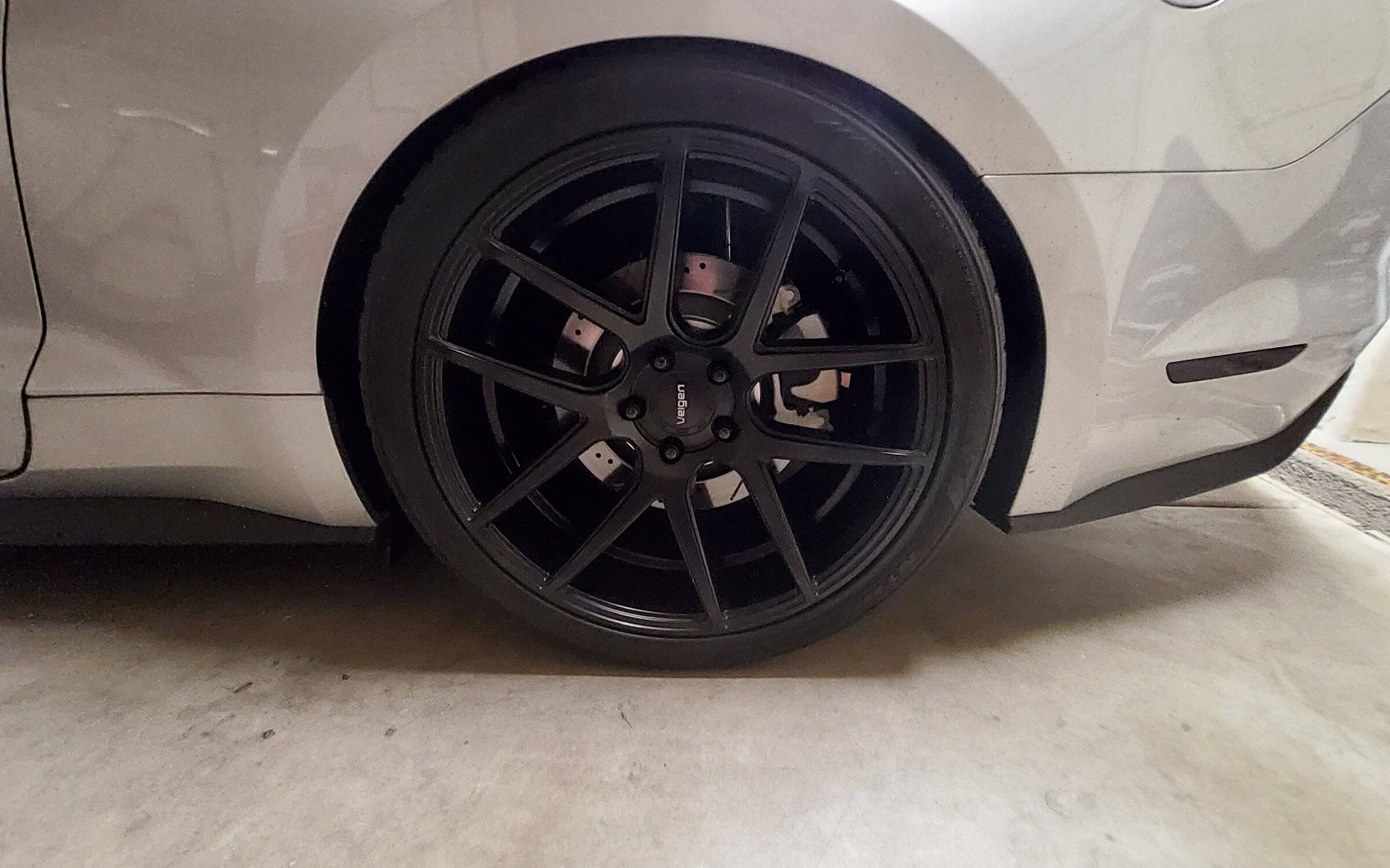

Going to throw my 2 cents in , the rears are out ........my set up . Granted 20 not 19 front 20 X 9.5 +35 255/35 rear 20×10.5 +45 305/30 . Lowered on sport lines , alignment set at stock . No rubs .

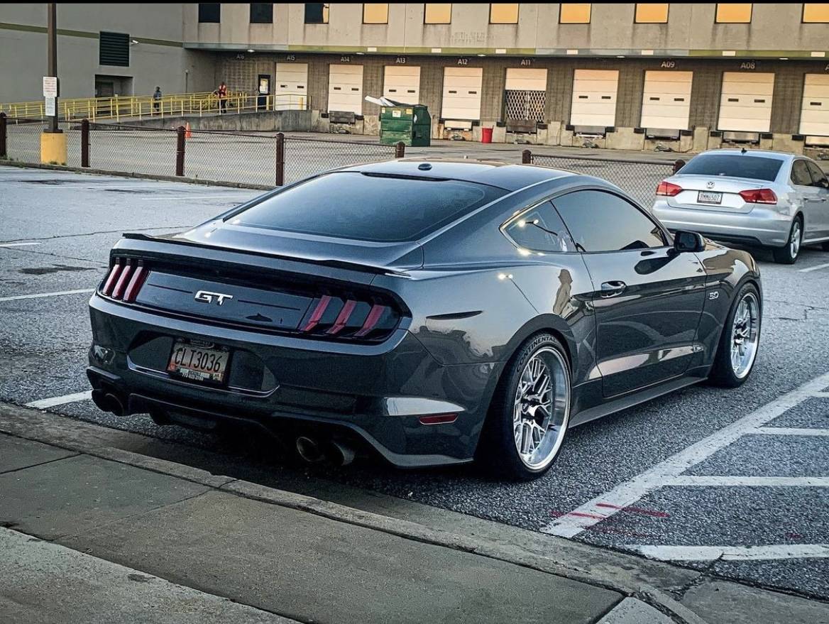

This is the car I am basing it off of. I love the look and didn’t think it looks like much camber at all.
