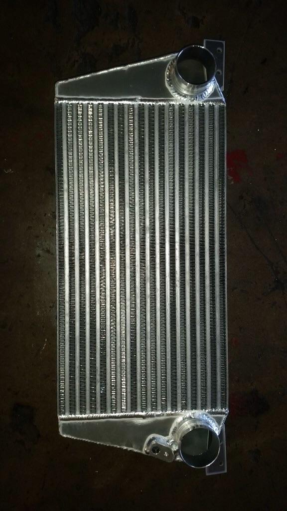

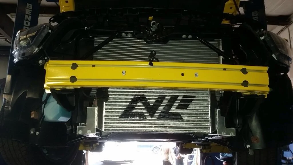

Here's another vote for Nik at Levels Performance. The quality is just as good, if not better, than Full Race plus it's easier on the wallet. The LP is a direct bolt-on replacement, utilizes a bar and plate core (Vibrant), is hand TIG welded, uses all the OEM sensors and fittings, and can be used for applications up to 600 hp. His kit also uses high quality silicon adapters with t-bolt clamps (which is much much better than worm gears).
On a WOT 3rd gear pull, my charge air temps (CATs) have never gotten over about 15° above ambient. The CATs will actually start dropping during the pull and only slightly go back up towards the end of the pull (but never gets over 15° above ambient).
In short, I love the LP FMIC and it was worth every penny spent on it. If you contact Nik, tell him your from the forum and Justin sent you. He'll usually do forum and Facebook group members pretty good!
Plus, like Evil said, he's doing charge pipes very soon and those are very nice too.
Here's a review I did of the LP FMIC. Check it out!
