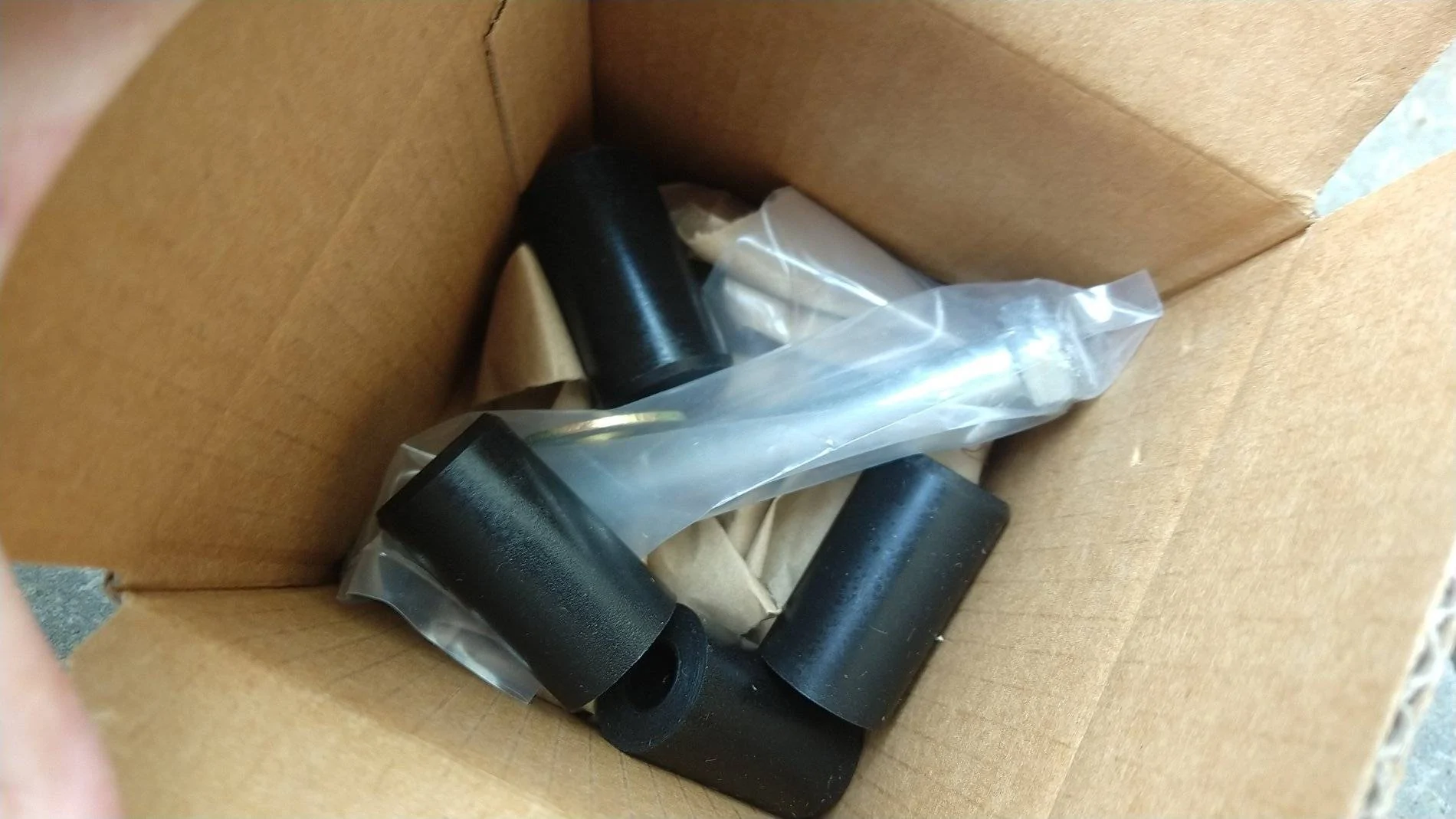

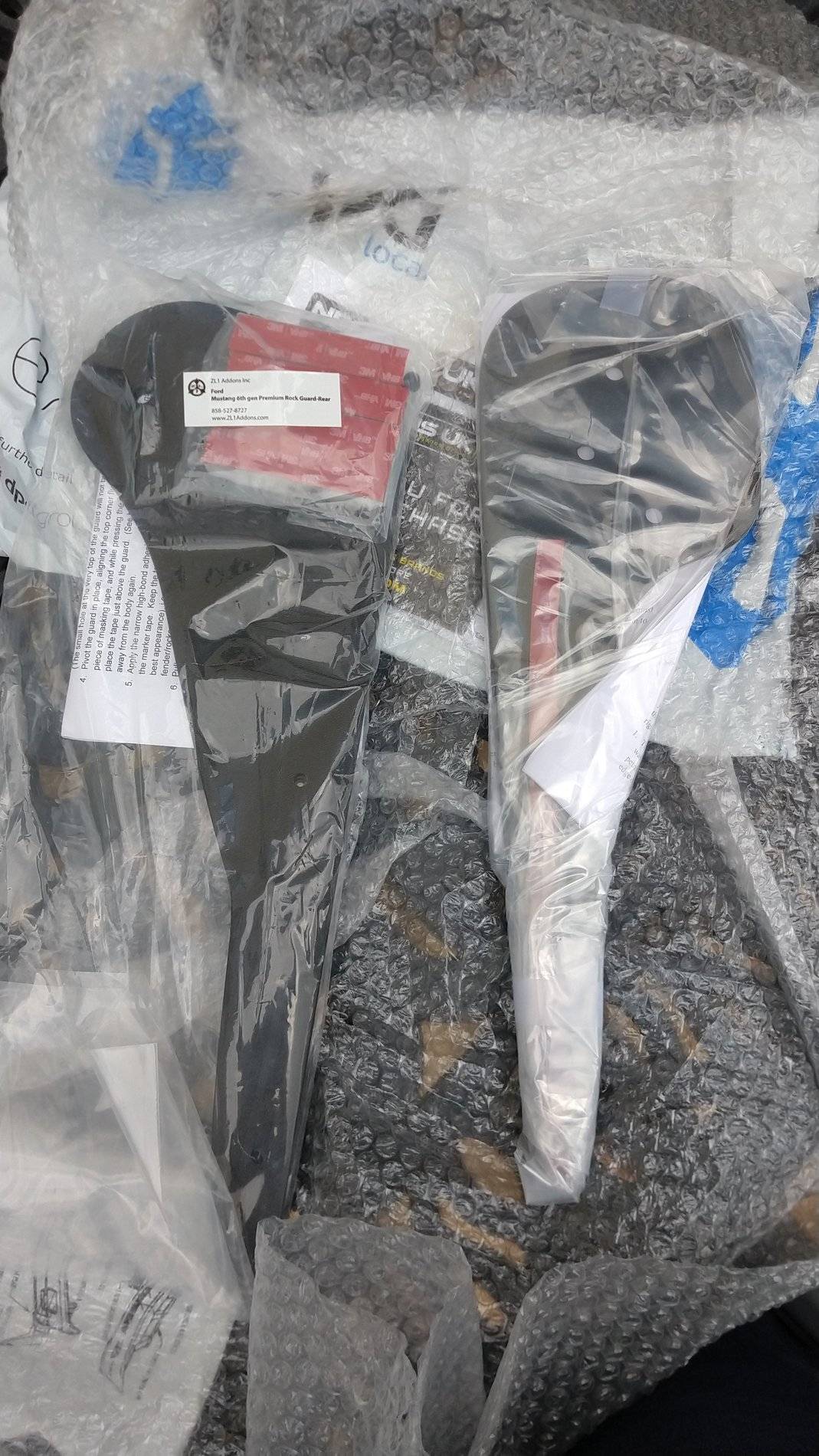

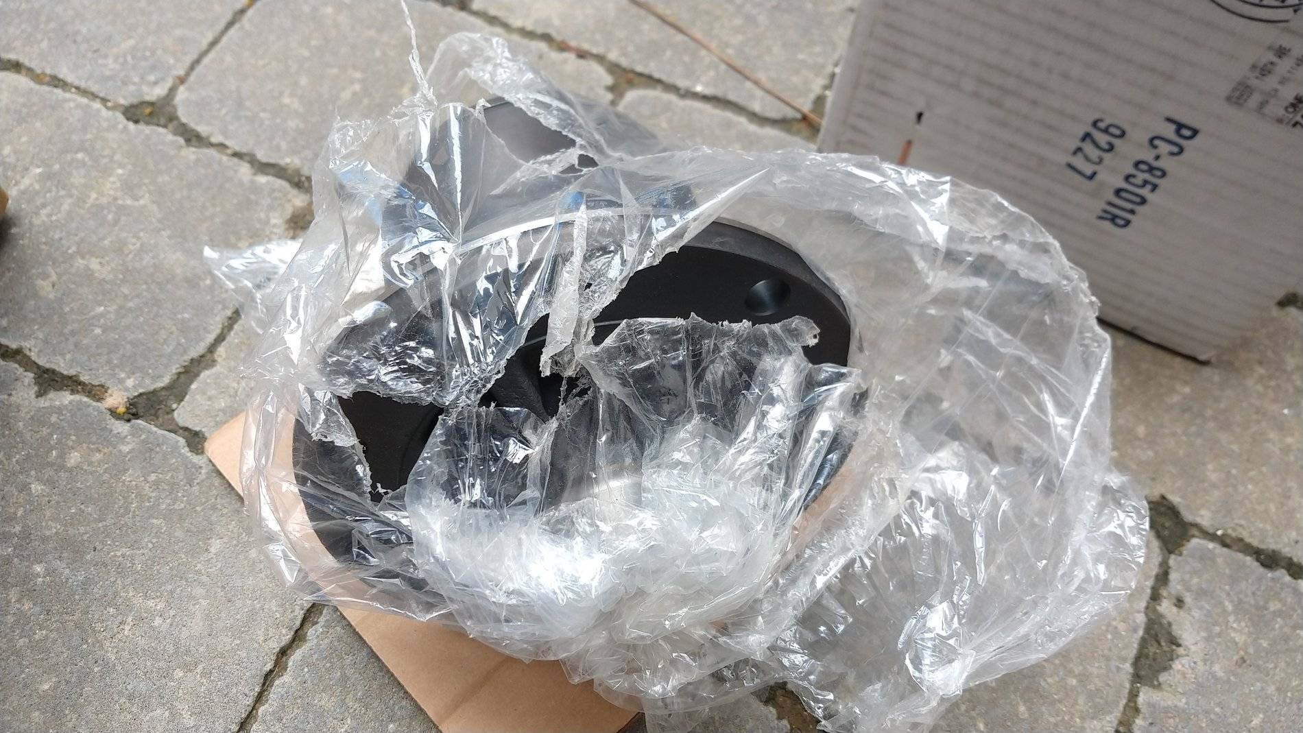

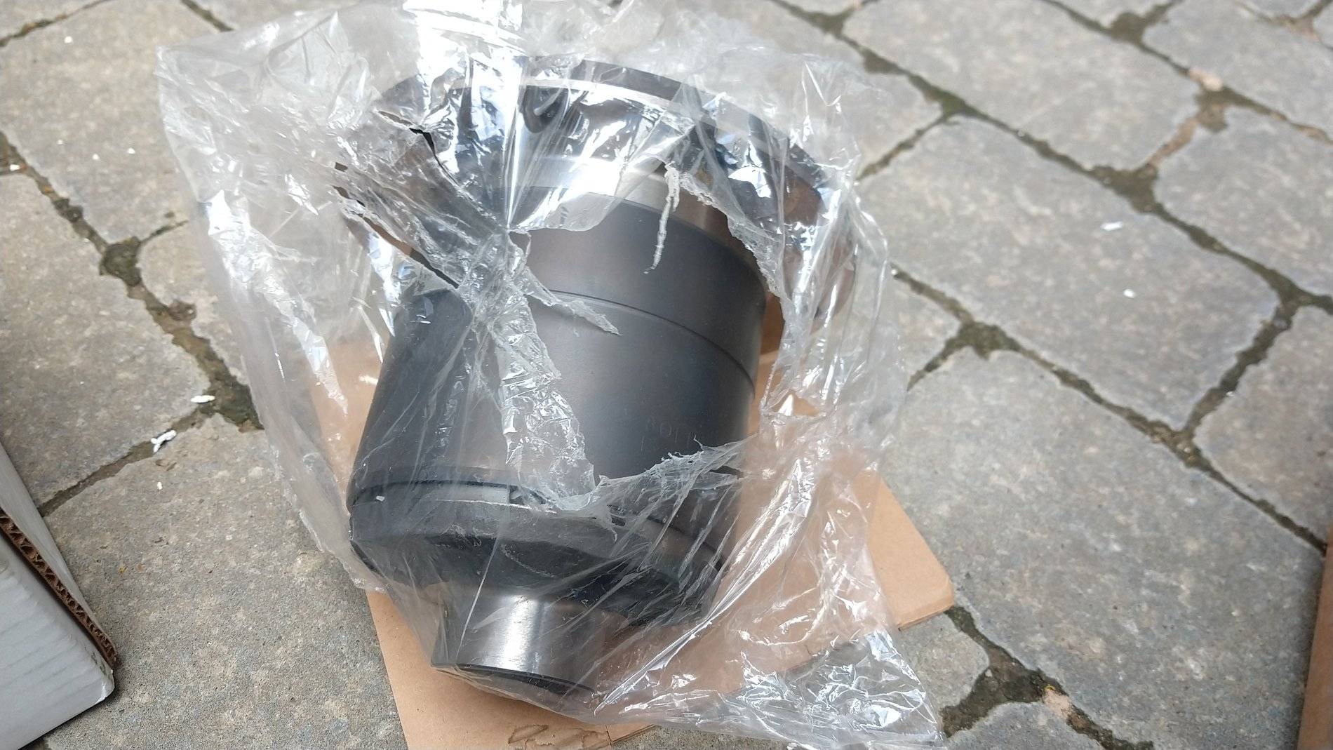

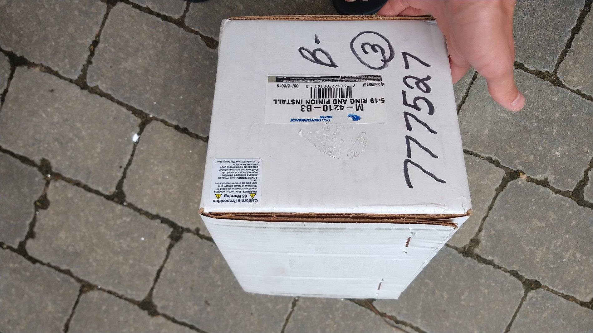

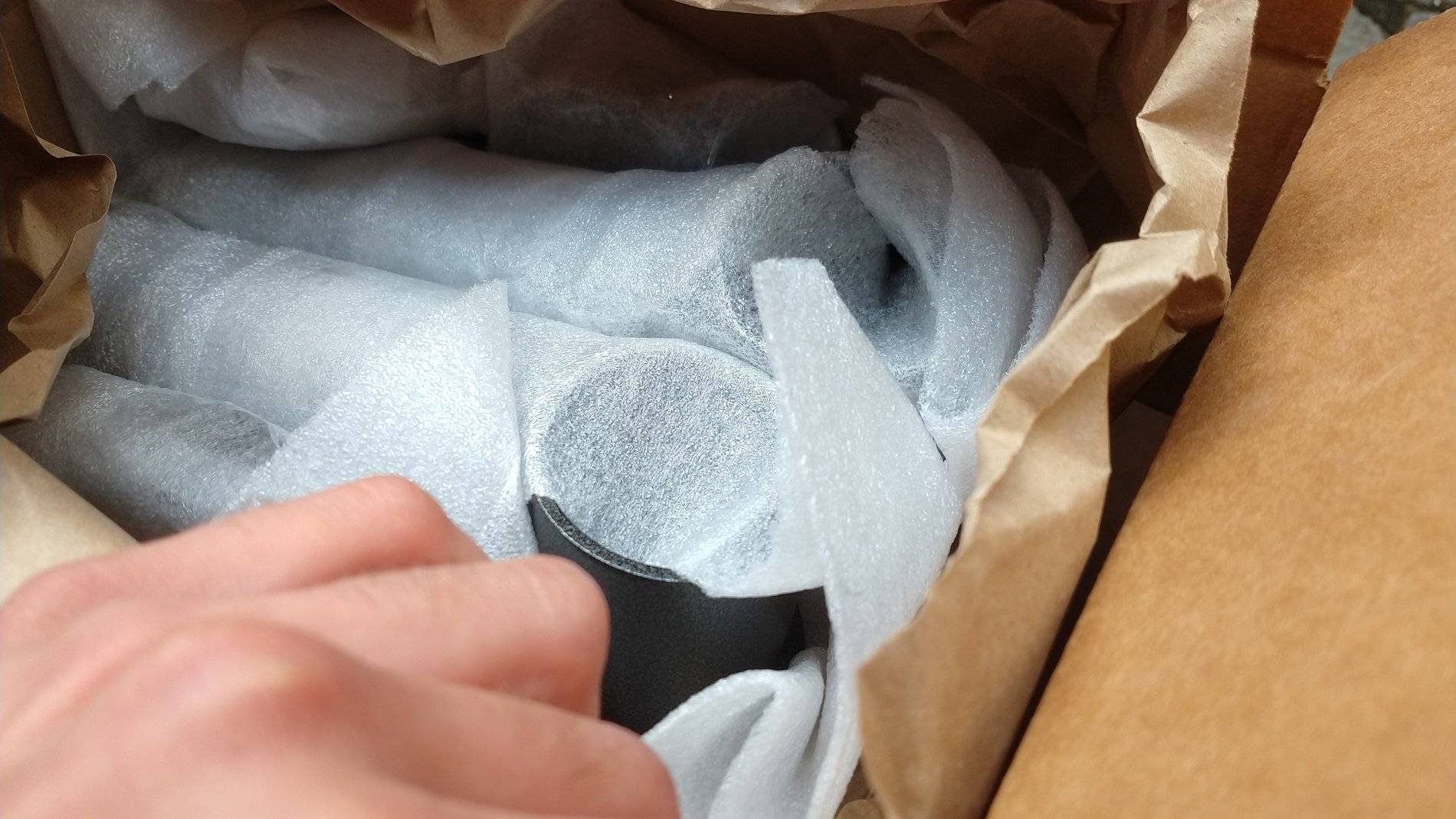

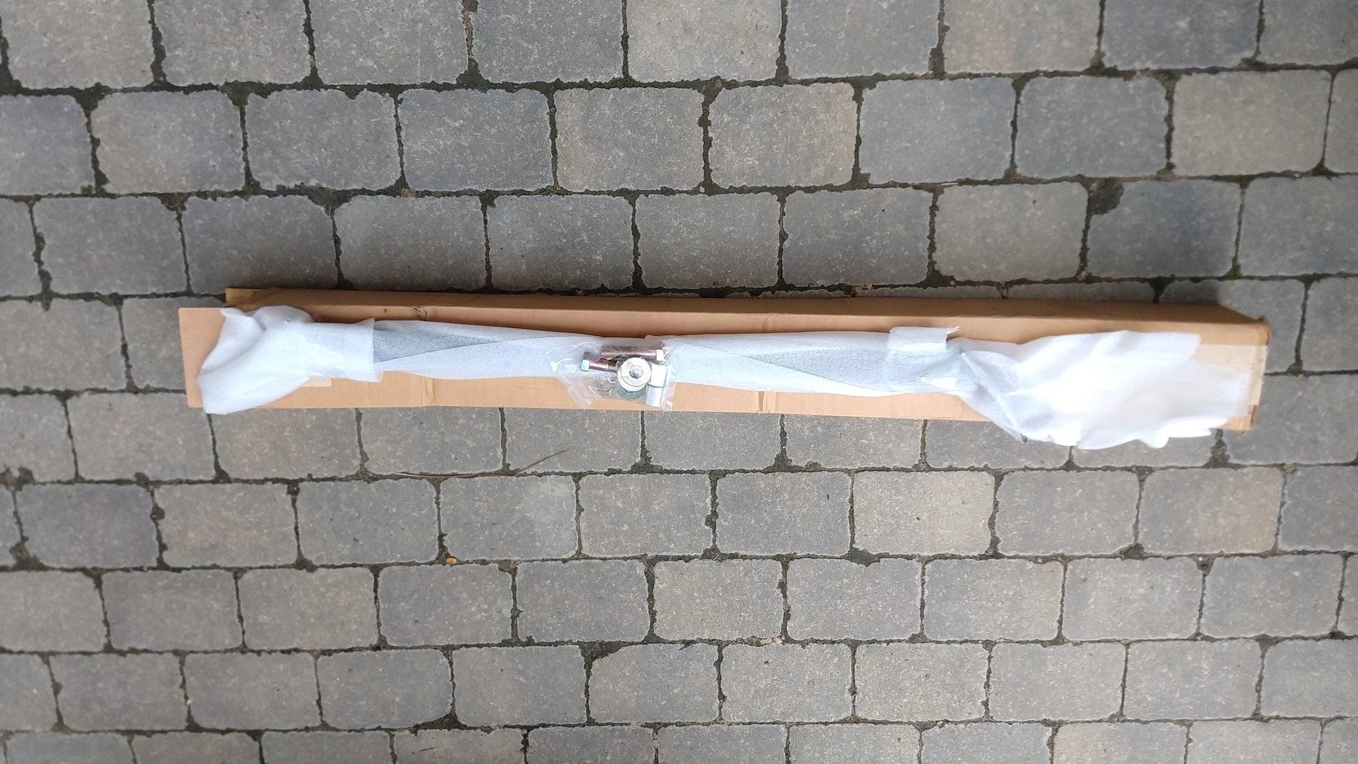

I have all of this for sale. Brand new.
Ford Performance T2-R Torsen Differential - £900. Standard on US PP1 & PP2 GT, GT350 and GT500. Unavailable on UK Mustangs. Will last the life of the car and is more predictable than the factory diff which wears out in 15,000-30,000 miles.

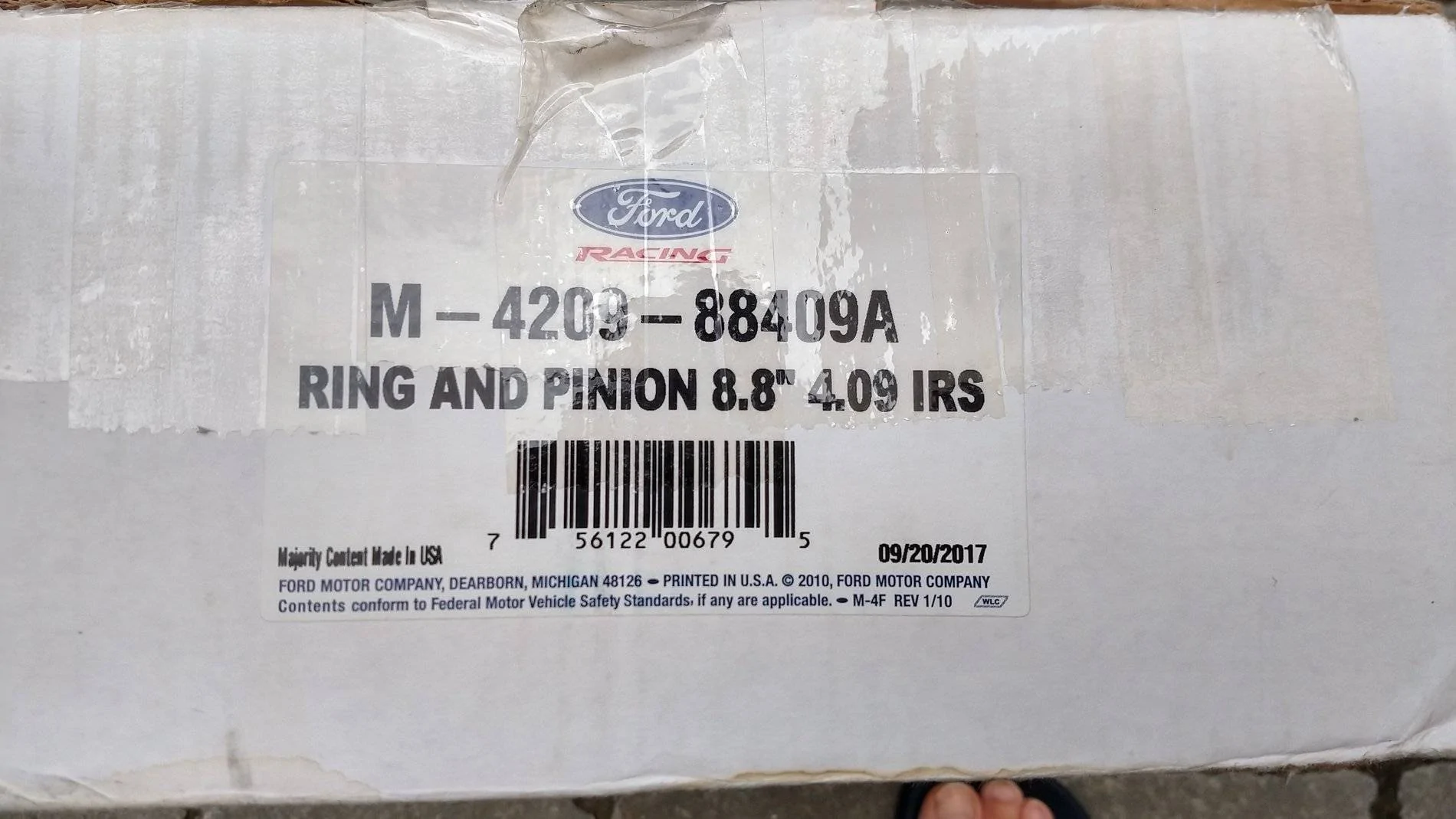

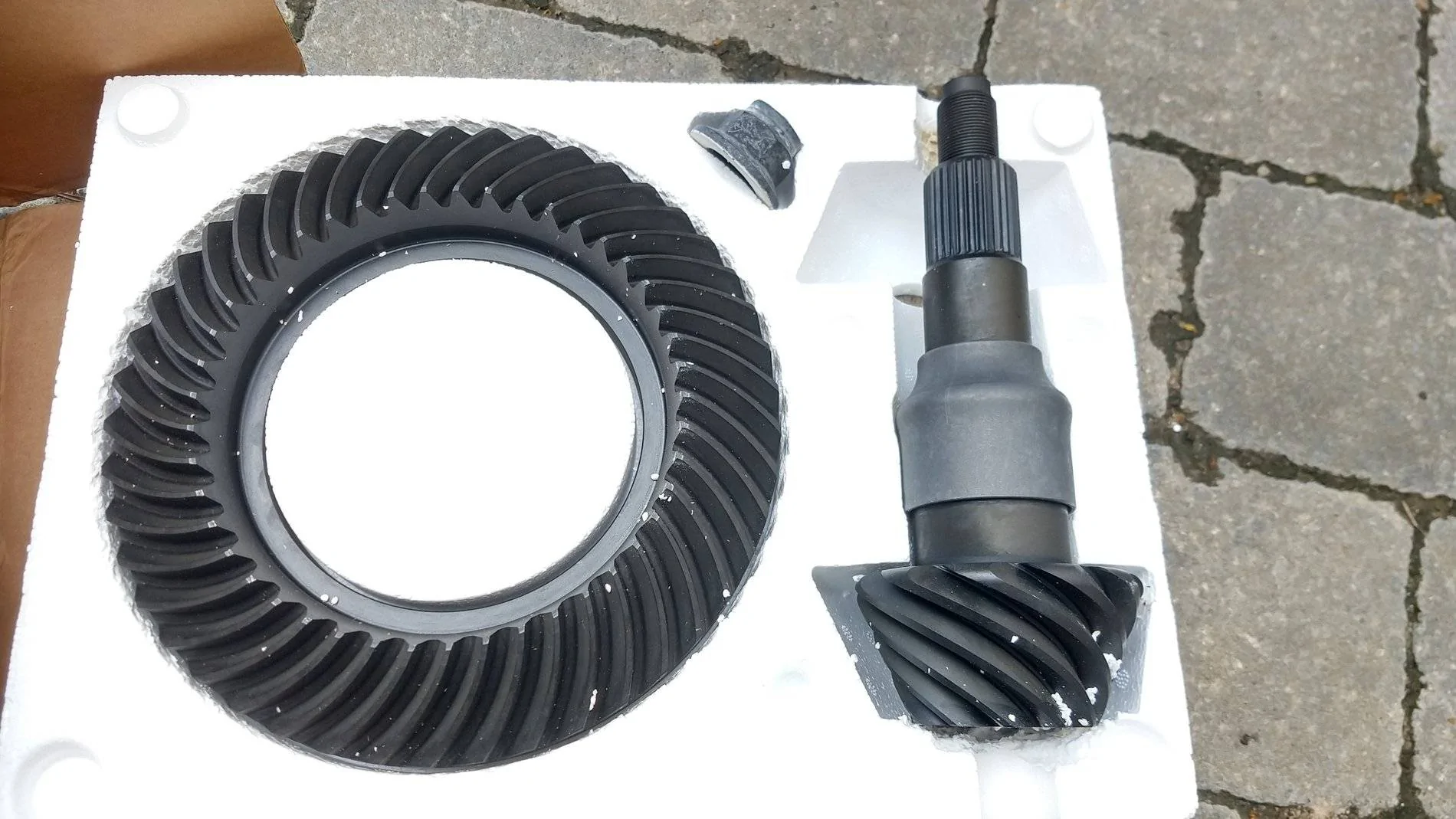

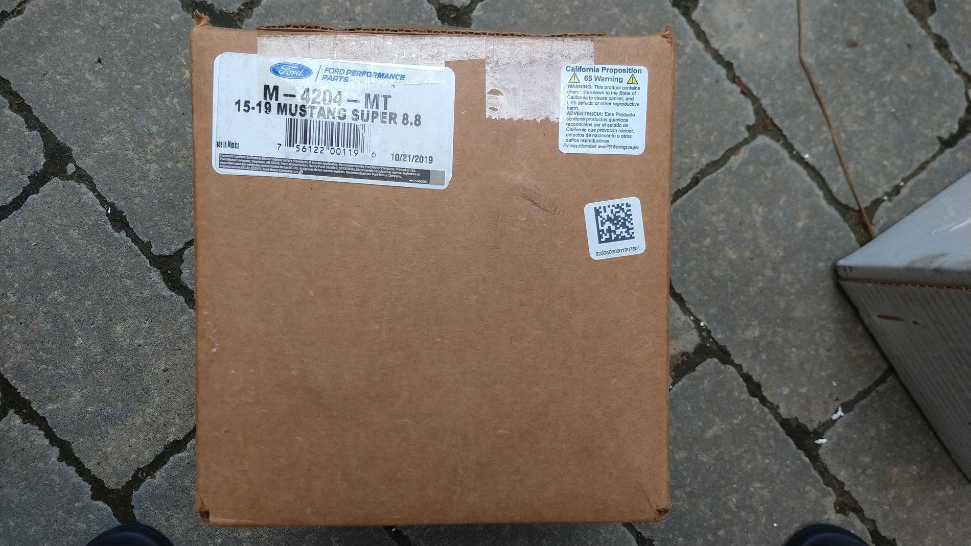

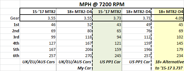

Ford Performance 4.09 Ring and Pinion w/ Ring and Pinion Install Kit - £475. 2018+ Manual GTs are annoying with 2nd gear to 80 mph and 3rd to 120mph. It makes them slower until triple digits than the 15-17 cars. This fixes that and makes the car more engaging at more legal speeds letting you enjoy the upper RPMs in 2nd through 4th before going too fast. It will also improve acceleration and feel like you gained 50hp/50tq.

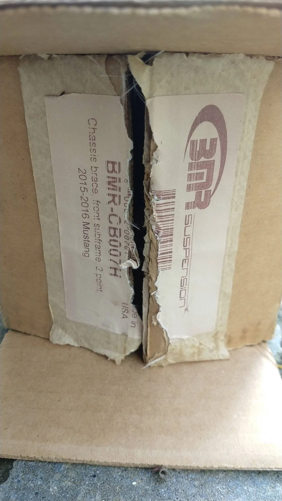

BMR CB007H 2-Point Front Subframe Brace - £100. Better connect the front end to add more feel to the steering.

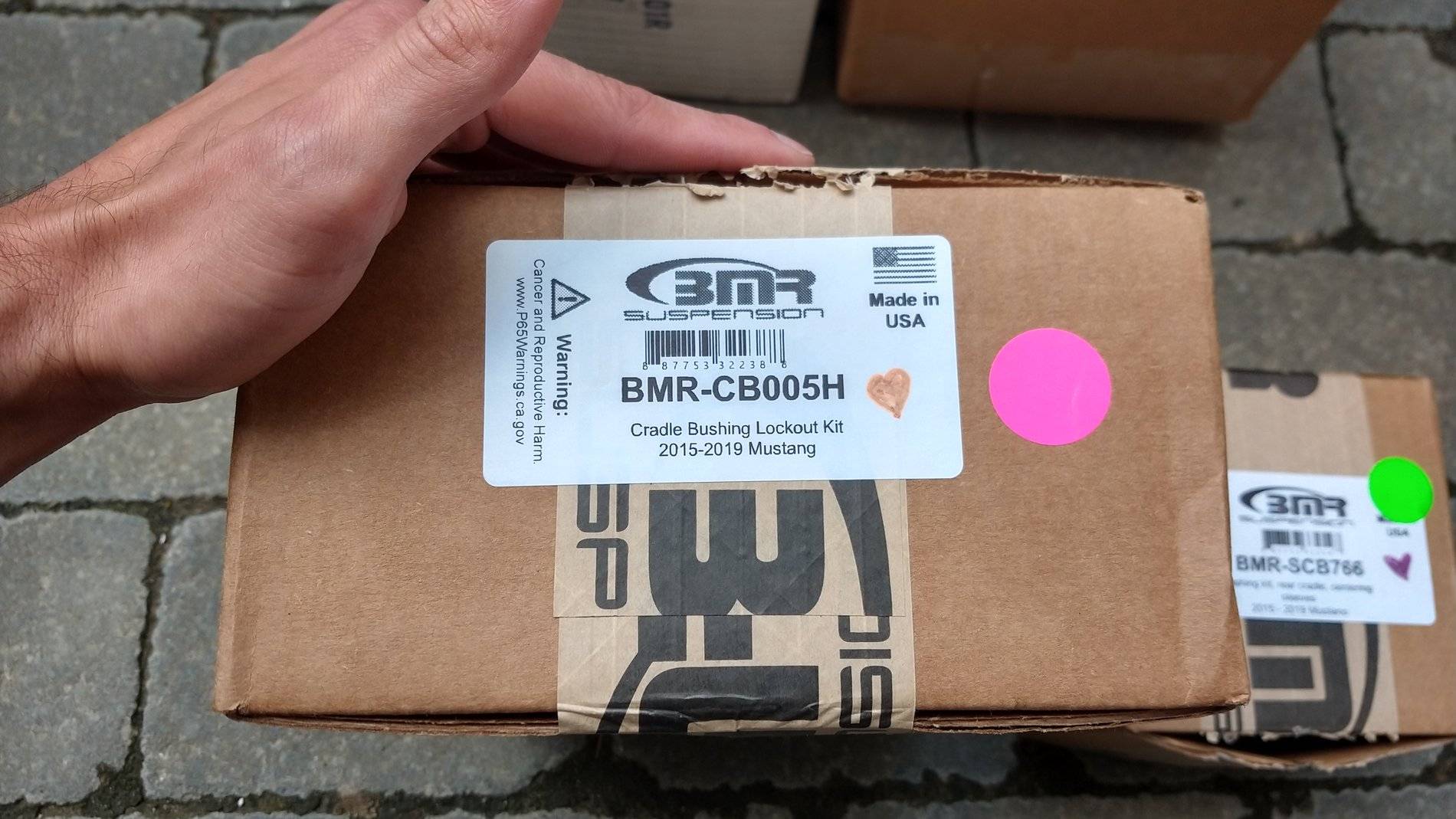

BMR CB005H Cradle Bushing Lockout Kit - £185. Best kit to stop wheel hop without going nuts on other parts that add NVH.

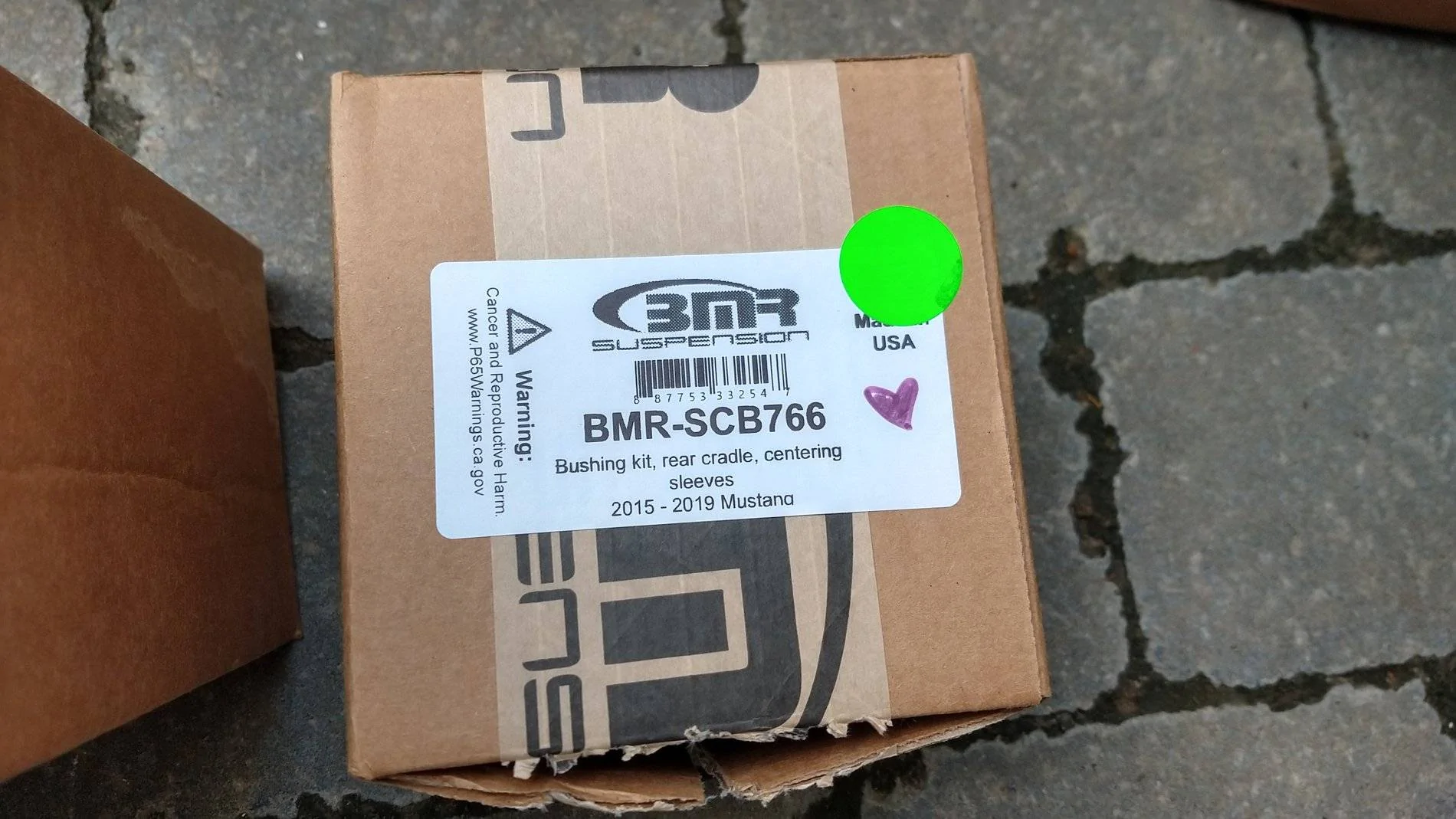

BMR SCB766 Rear Cradle Alignment Bushings - £25. Great compliment to the CB005H.

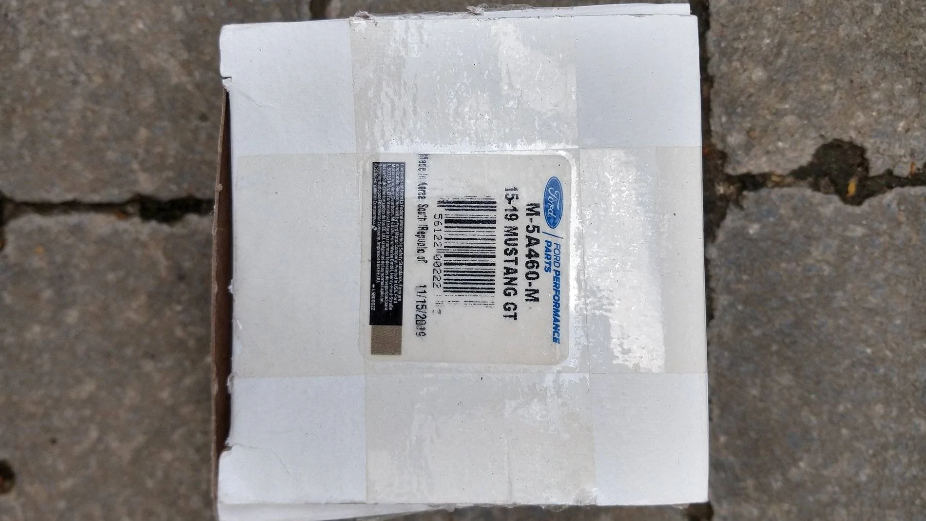

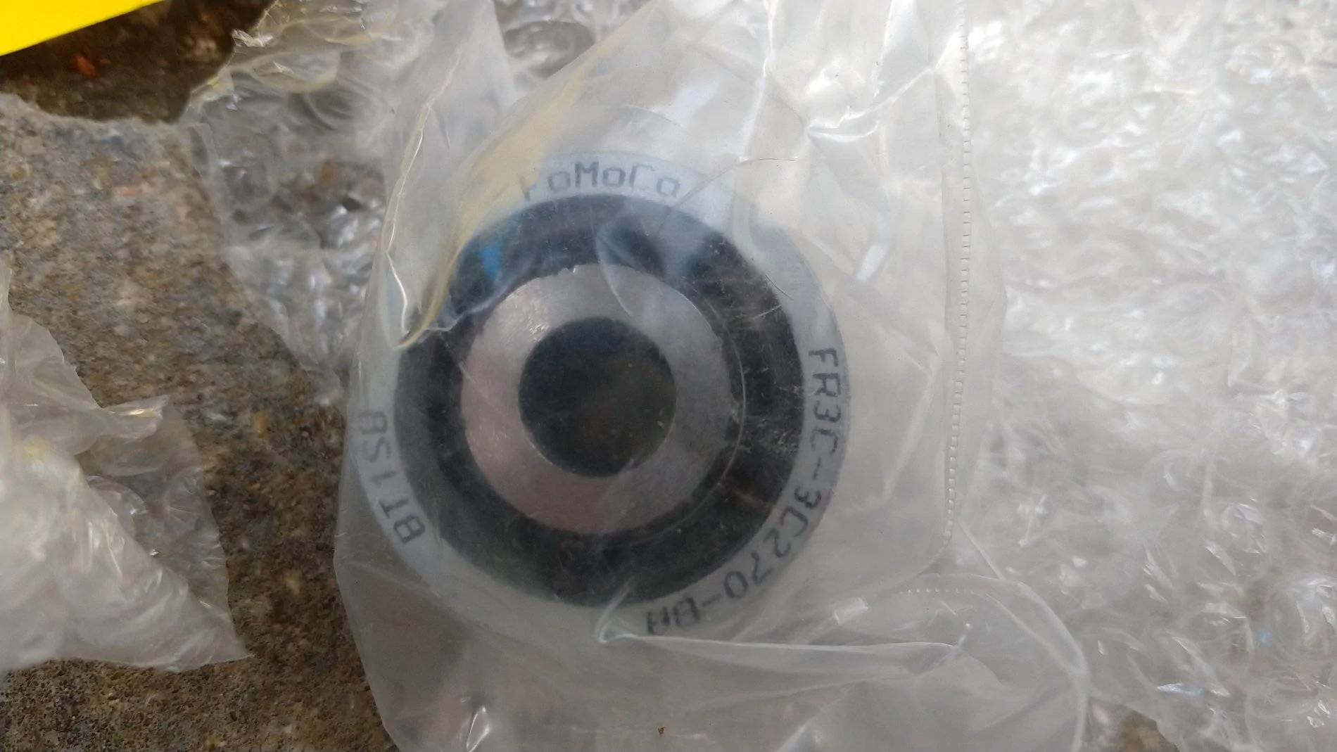

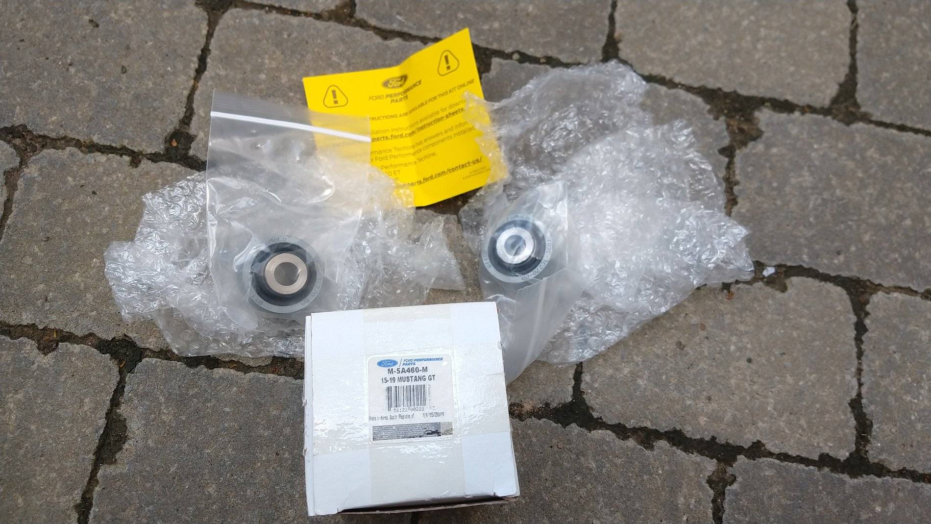

Ford Racing Toe Knuckle Bearings - £70. Standard on the GT350. Better rear end precision when cornering and particularly when coming out of a corner on the power. Also compliments the CB005 in reducing some wheel hop.
ZL1 Rock Guards - £80. Protect your wheel arches, doors and rear quarter panels from stone chips.

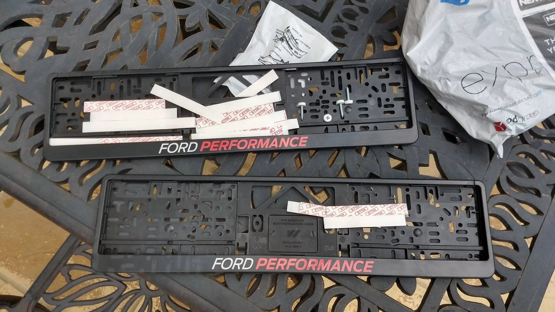

Ford Performance License Plate Holders - £20.

By the way to others. Difference with the 4.09s on a 2019+ GT. Gears 1-4 are improved dramatically and you still have such long 5th and 6th gears that your fuel economy won't suffer on the motorway.
