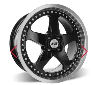

I am new here to the forum. Late life crisis buying my 2021 Ati-Matter Blue GT (non-PP) in late of 2022, just looking to have some fun rowing six gears. Current oem rims are ok 19x9, but I want to change these to 18x10 (long story reason for this). It seems finding the right wheels is very subjective and tough to find for my preference without busting the bank, my budget without tires is $3k max. Looking for options for simular rims as shown. 18x10 square set up, (+35mm front and +45mm rear?), straight barrel design. If anyone could point me in the right direction that would be awesome! Otherwise I may have to go with the Weld Ventura Street which matches all the sizing criteria. I am always open to other ideas. Thanks!

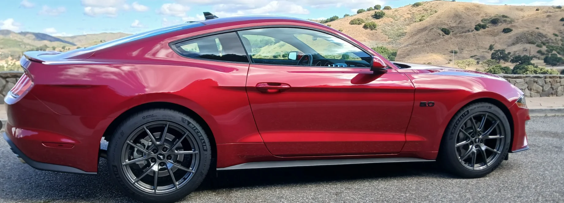

fitmentindustries.com is a great source to see what wheel options you have that will fit your car.
I got 19x10 +et35 apex vs-5 in anthracite squared (directly from Apex.com), and paired them with Michelin PS4S in 275/40zr19.
