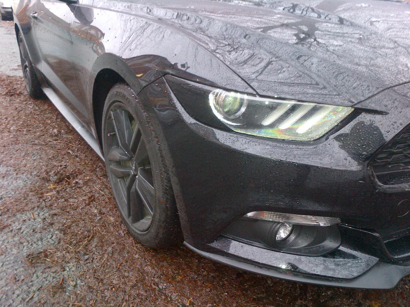

I put the condensation (is it the same as in the pic below?) just down to the really wet and damp weather. I assume the headlamp units aren't sealed and so excessive water can drain away (usually a small hole at the bottom). In the past (other cars), I've removed the headlight bulb and blasted a hair dryer in there.

The condensation is normal I think, also I thought my headlights were wrong but they were adjusted as if there was more weight in the car. Now they are on a lower setting they are fine, boot interior light doesn't come on, yet to see if they fitted a bulb lol.
