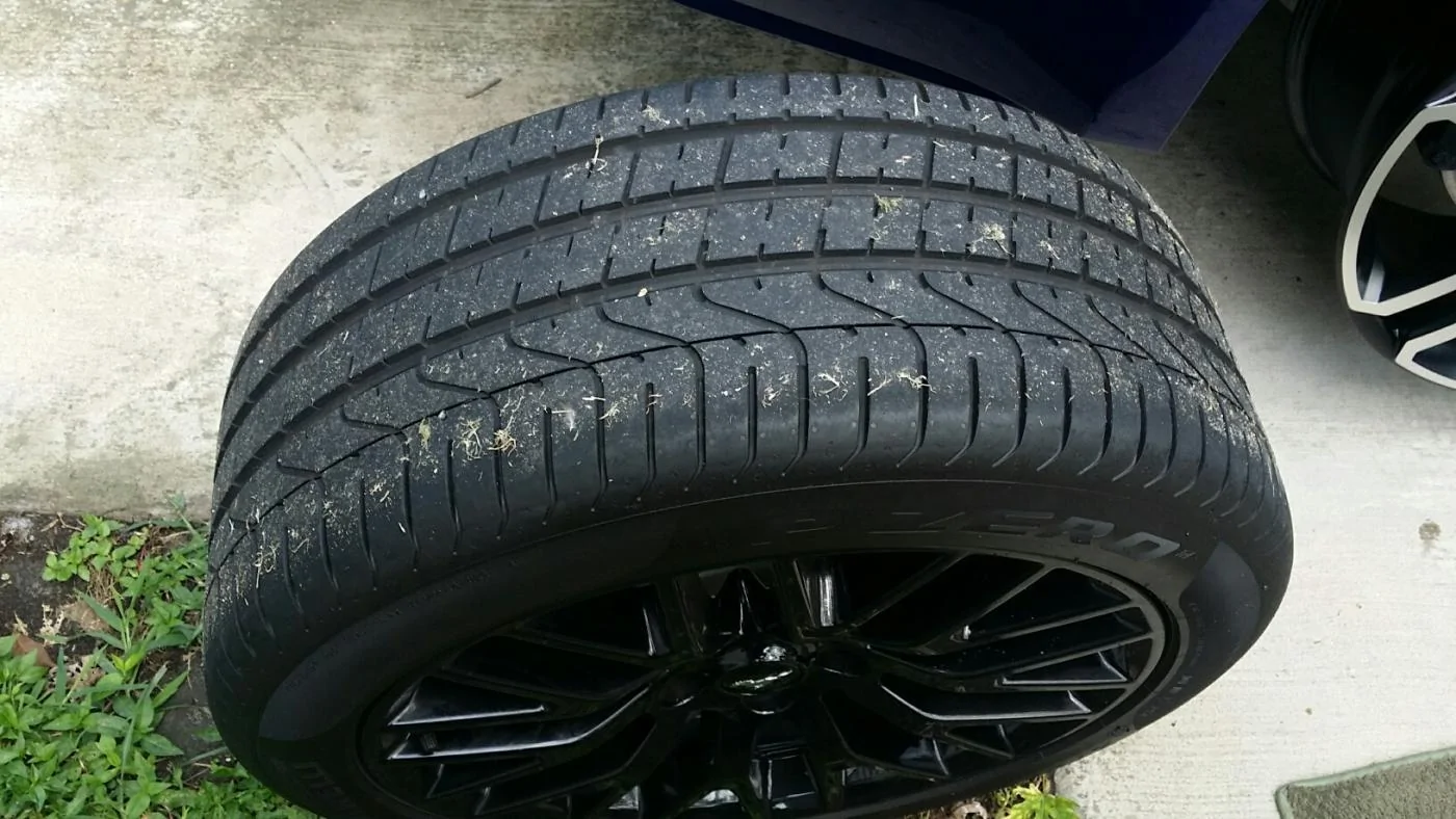

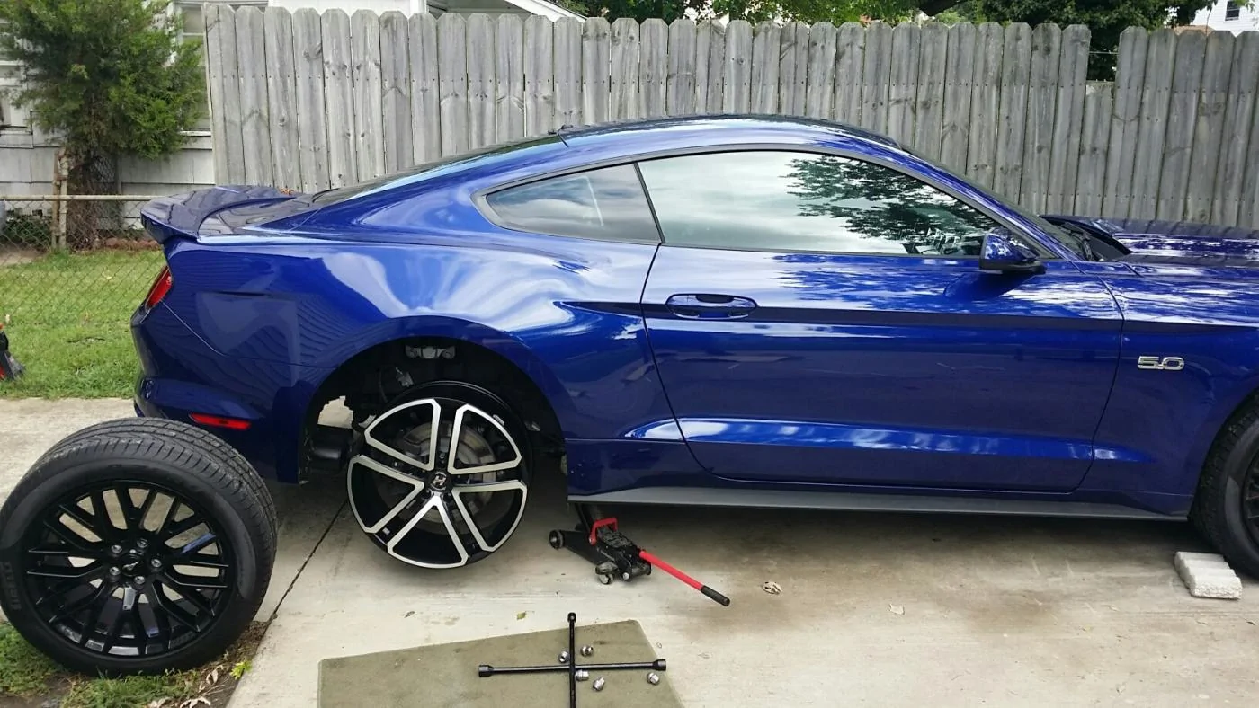

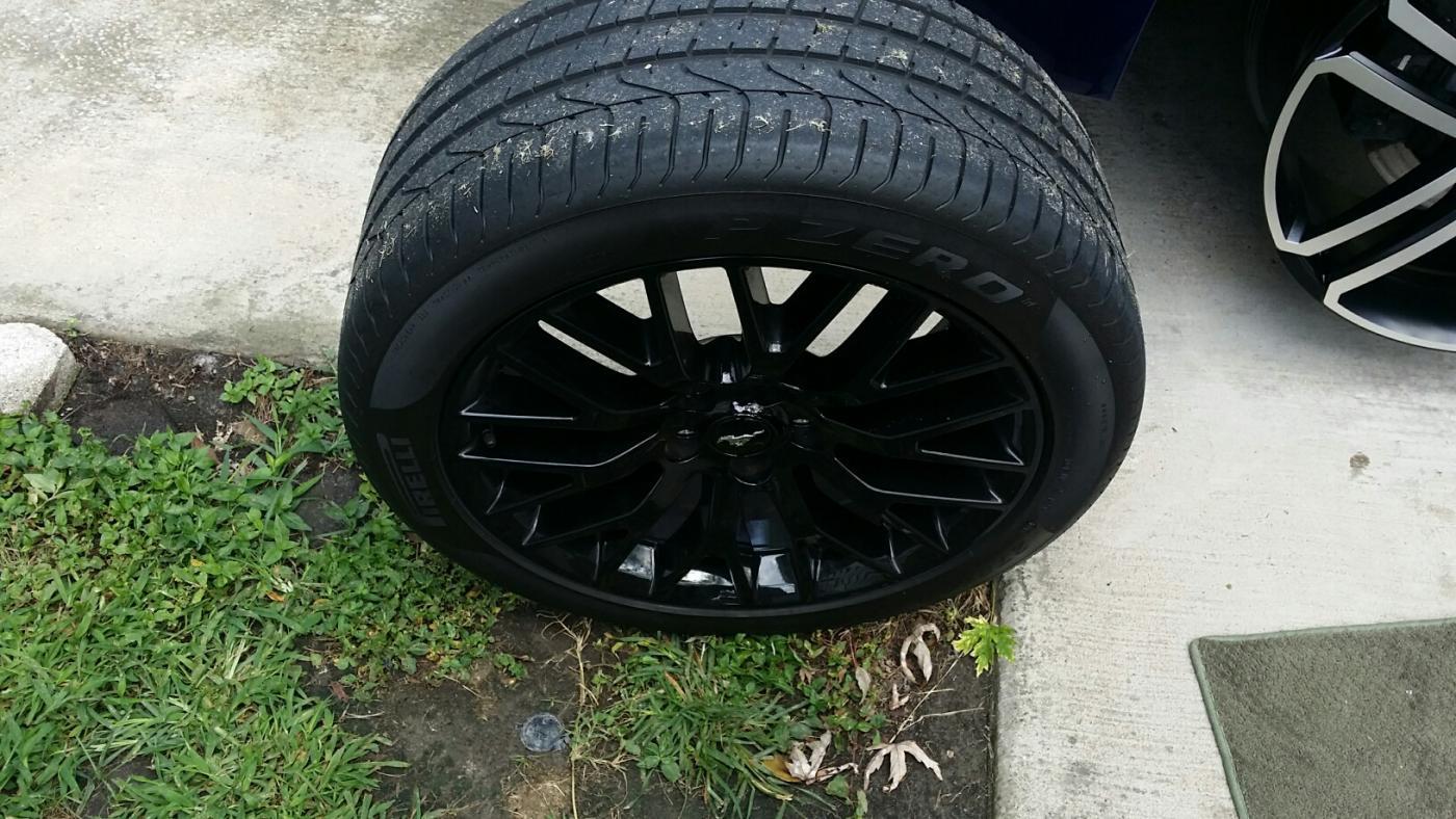

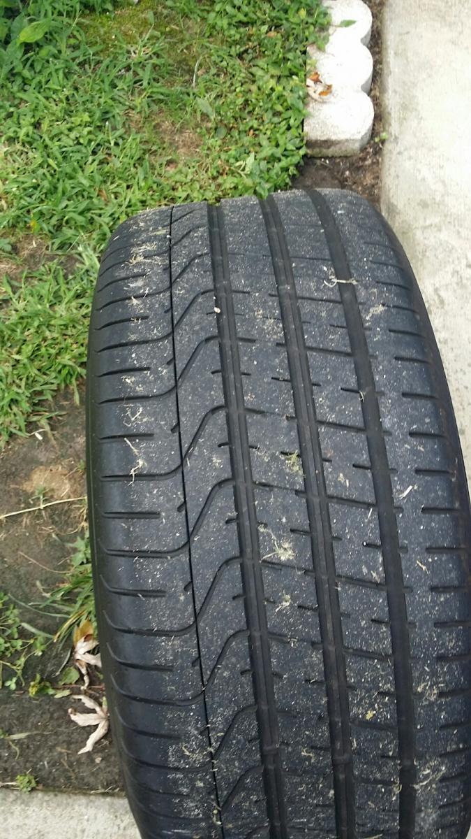

Redeemer, I do drive a teenager (sometimes) and I line locked (once) and burned the tires up several times racing. I am over 40 and this is my 8th stang . This car is special ( like all the others) but I knew what I was getting into with the PP car: no square setup so no 5000 mile rotation to save tire life and also these are summer tires..below 40 C and snow, ice ..not useful...I am in the process of testing a square setup... My car has 3200 miles and the rear wear is okay but I see trouble in my future.. I snapped a few pics of my rear tire at 3000 miles ..hope this helps ...also Pirelli will still work with you for defects in workmanship and design for at least 1 year on a case by case..until then might I suggest a good all season tire with a square setup that way you will get about 40,000 miles or more instead of the estimated 12 or 15 or so out of those stockers
