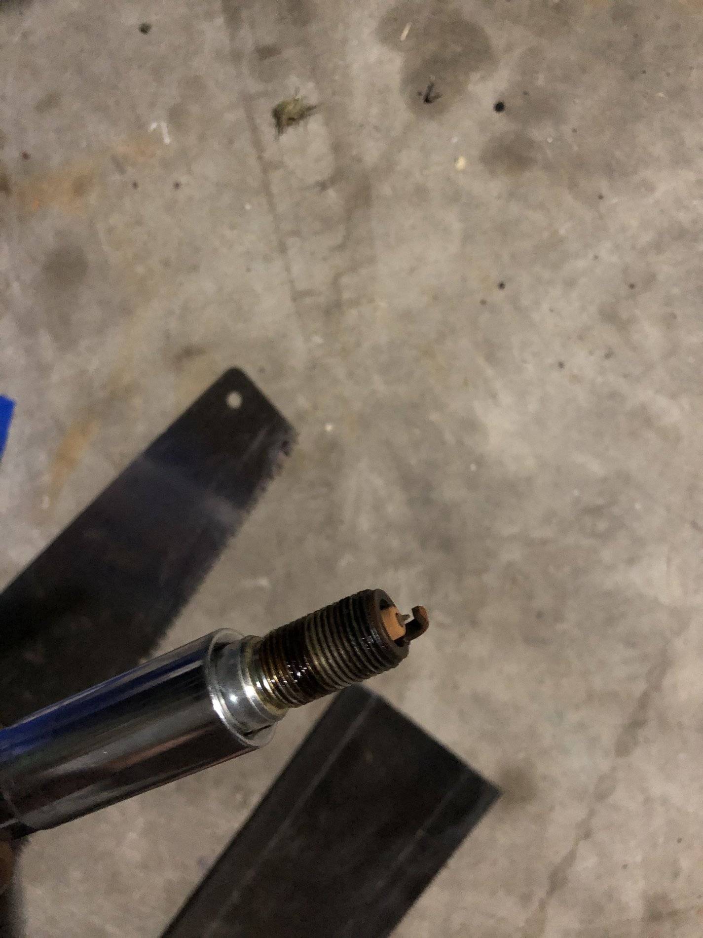

I’ll check that as well brother because I installed the ID1050X, but that shit was
an easy install and nothing had to be moved really. I’m going to check my plugs and see the discoloration.

Well.. it’s not black or damn white.

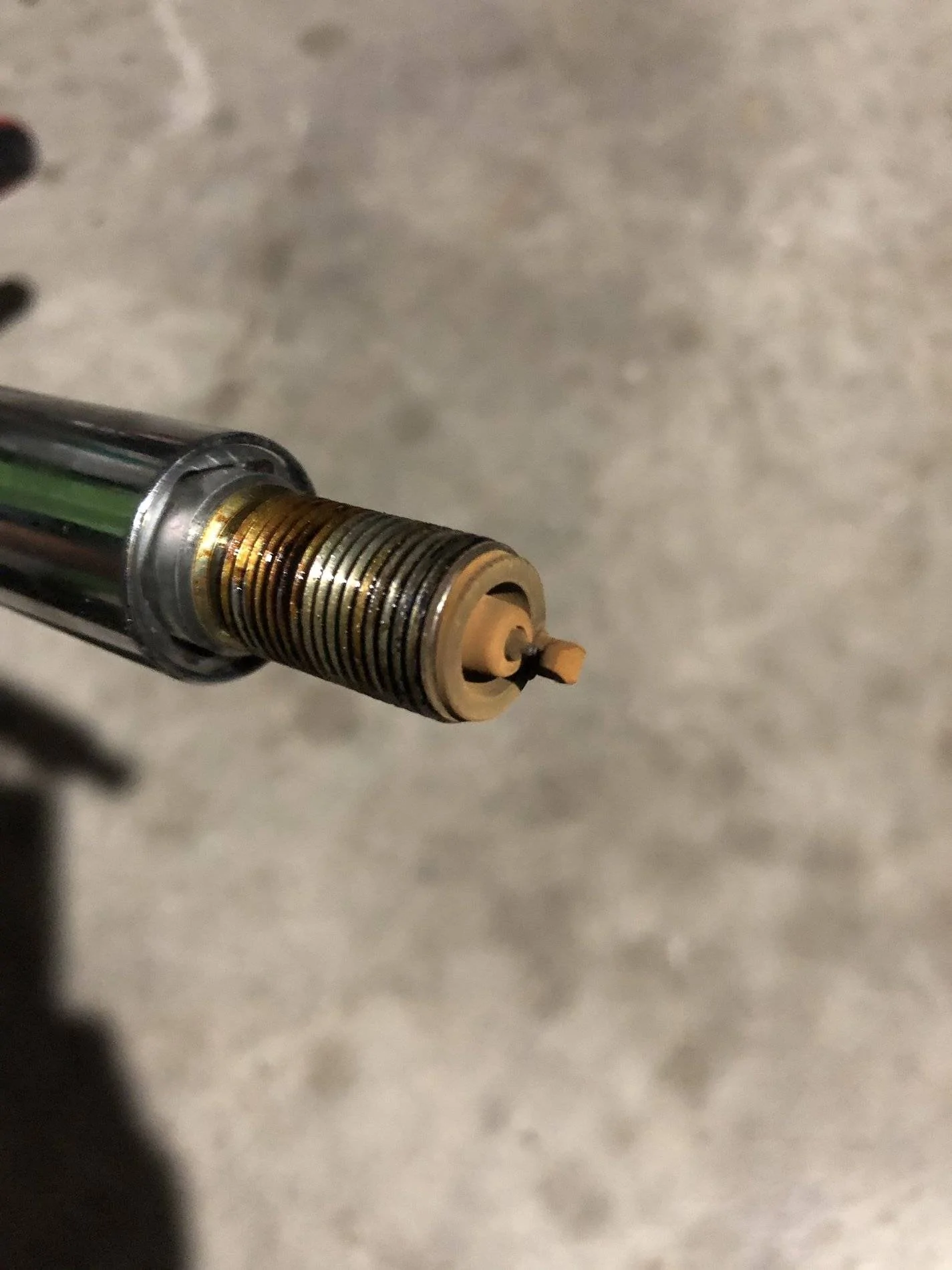

Second plugs smh.

I can see oil or something on top of my plugs so.. I guess I’m fucked!

Orange is from MMT from the octane booster. You must be running that regularly. Other than that doesn't look terrible. Who has tuned your cart?

I literally just started that 2 weeks ago while data logging the car for Lund. Brandon from Lund saw my knock sensor 9.9 max on the dyno for 1st revision and said add a bottle of octane booster. Of course I did and now I’m stock with it smh.

Looking at those pictures again says I’m leaning. What now smh.
