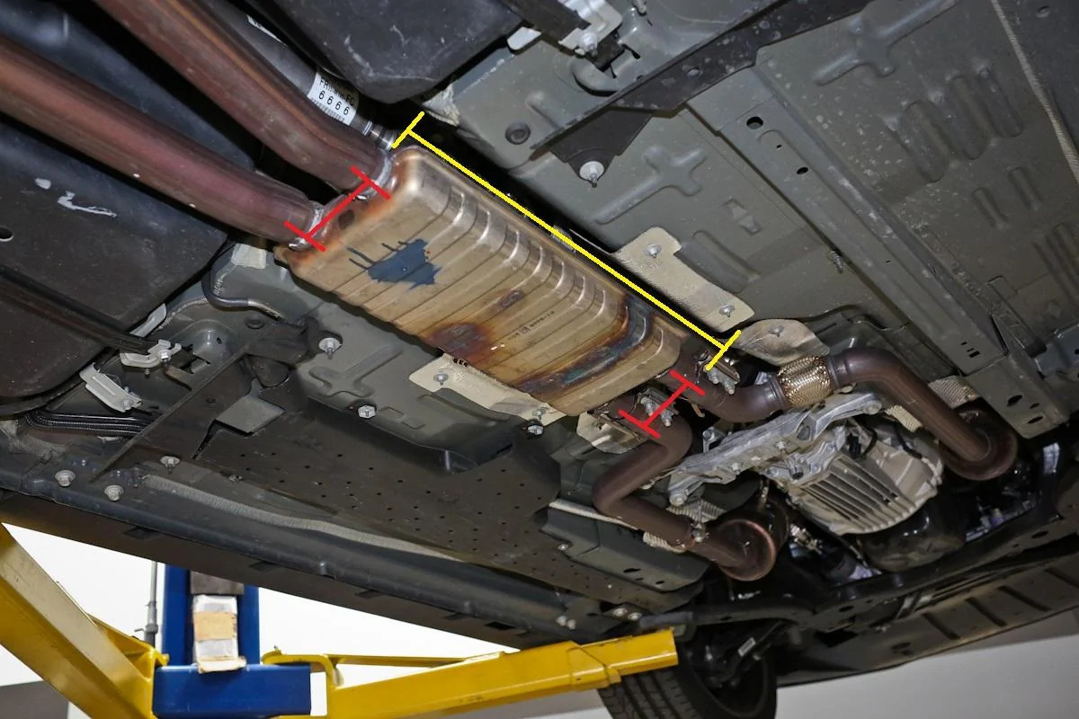

For those of you that have installed a resonator delete midpipe, could someone provide the dimensions I have highlighted in the attached picture?
Red lines: Center to center distance of the two pipes
Yellow line: Distance from front of the pipes that the factory clamps cover to the rear of the resonator where the weld beads are located.

I just measured my resonator in the garage.
Yellow line = 27.0''
Red line = 4.5''.
