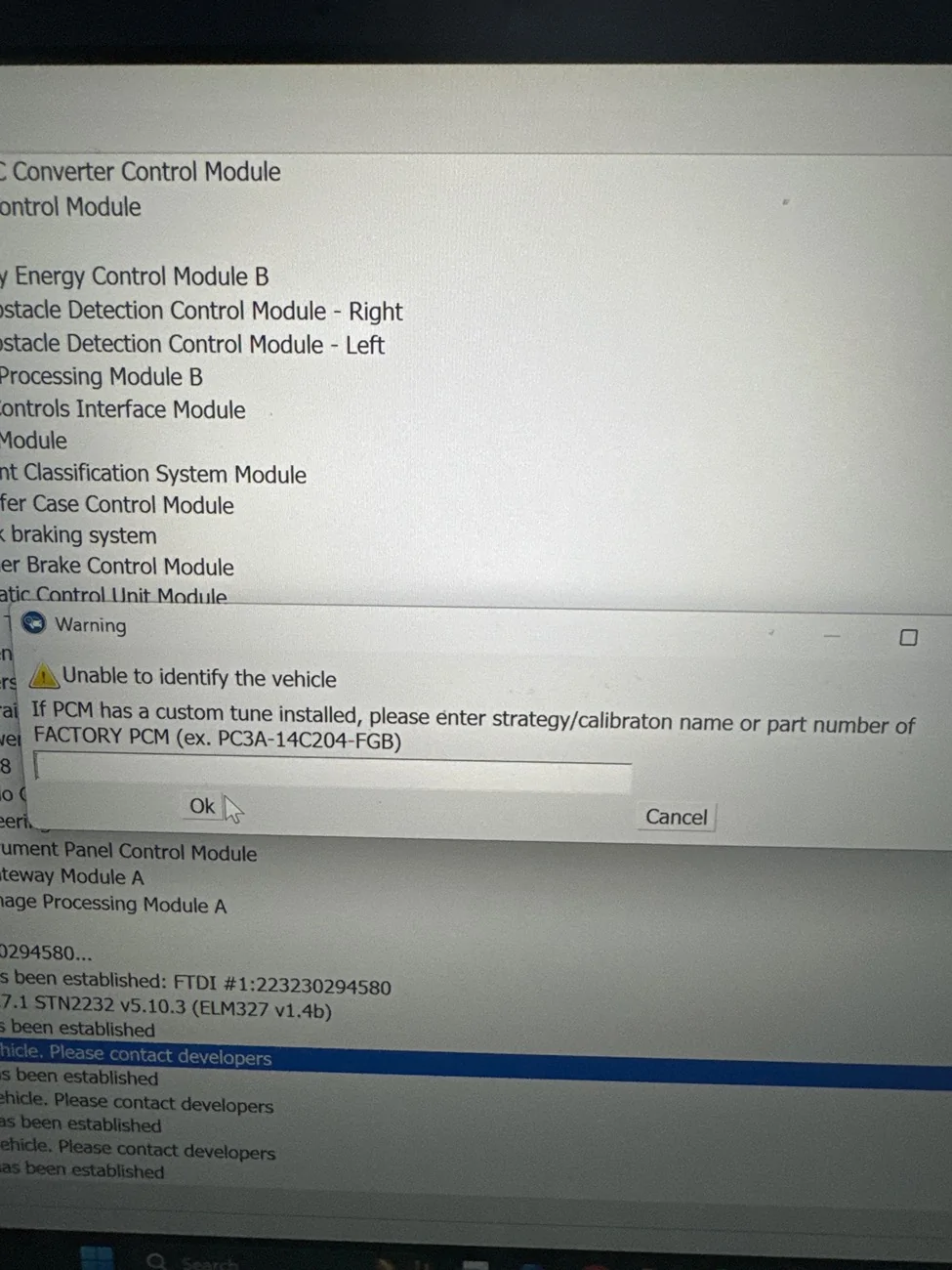

I have a 2019 mustang gt with a custom tune and i’m trying to connect forscan to my car. It is asking for the factory pcm code, but I can not find it. i checked the pcm module under the fusebox for the sticker, and there is nos sticker on my module. my obd2 scanner does not provide it and neither does the ford support website through my vin. what do i do?

I had the same issue. I removed the custom tune, setting it back to original. Made changes in Forscan then reinstalled the custom tune.
This is the answer. Had to do this when my car had the Whipple tune on it.
Or, send me a message with your VIN and I will find that strategy code from your car that it's looking for.

the car is modded. it has a custom tune from when i had it dyno’d. i purchased it used, but was stock when i purchased it. i’m trying to make a few changes to things like chimes and turn signals.
