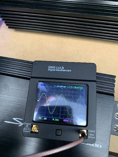

For anyone wondering, checked with a scope today and the factory 8inch head unit at max volume with the EQ settings flat put out an unclipped signal at volume 30. Nice to know for sure I had a clean signal coming into the amps, and was then able to scope the amp outputs to eliminate any clipping as well. HU was tested at 40 and 1000Hz as is standard and I also went through a wide range with my signal generator using a 0db signal.

I flattened the EQ with Forscan to get rid of the digital processing as much as possible. A lot of people say that’s an immediately noticeable change for the better. No other changes and I verified no clip with a scope as pictured. I would imagine it would be the same for you on the regular drivers, the LOC may affect your subs however, as your taking a factory amplified signal at the LOC and sending it to be amplified again and then to your subs. I would assume perhaps the LOC accounts for that but I’ve never used them so I can’t speak to that.

You just saved me some cash. I was wondering what to set the volume at to tune my amp gains.
