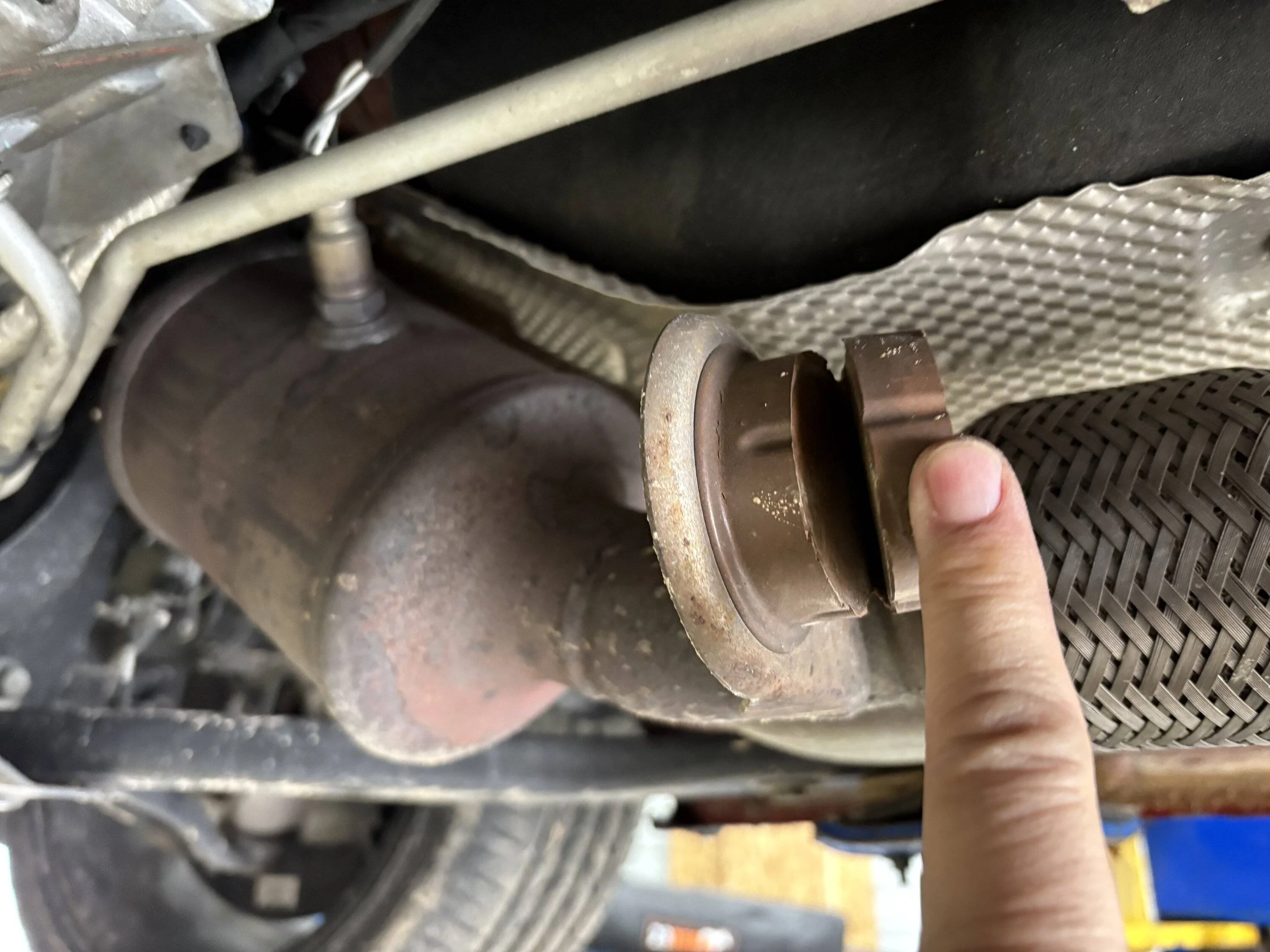

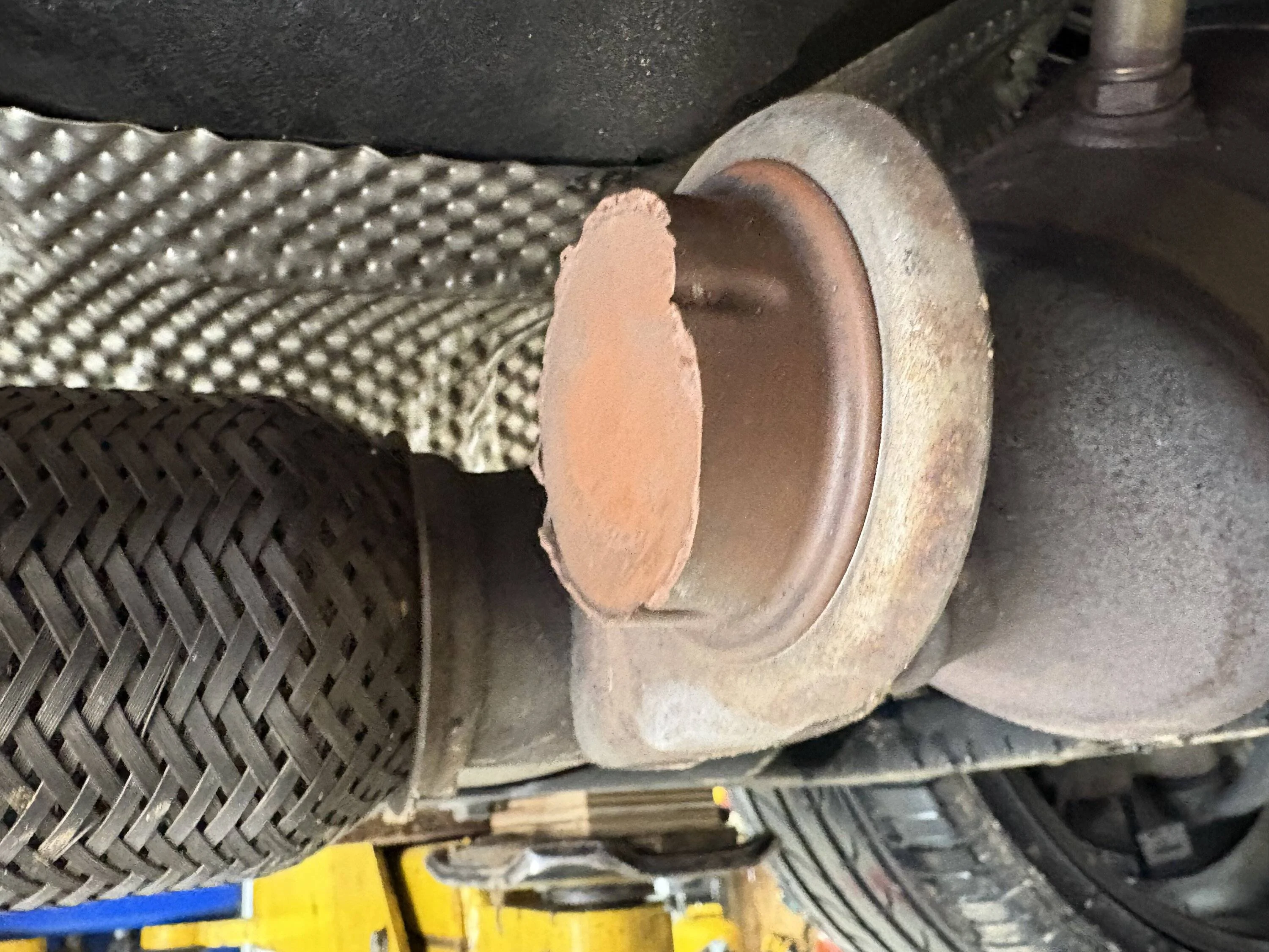

Are these serviceable? Ones cracked and the other one is completely broke in half.
They are not serviceable. Either need to replace the entire catalytic converter assembly, or go with what The Chairman posted above.
If you're still under powertrain warranty, you might have some luck getting Ford to replace. They did so for me with no questions asked.
