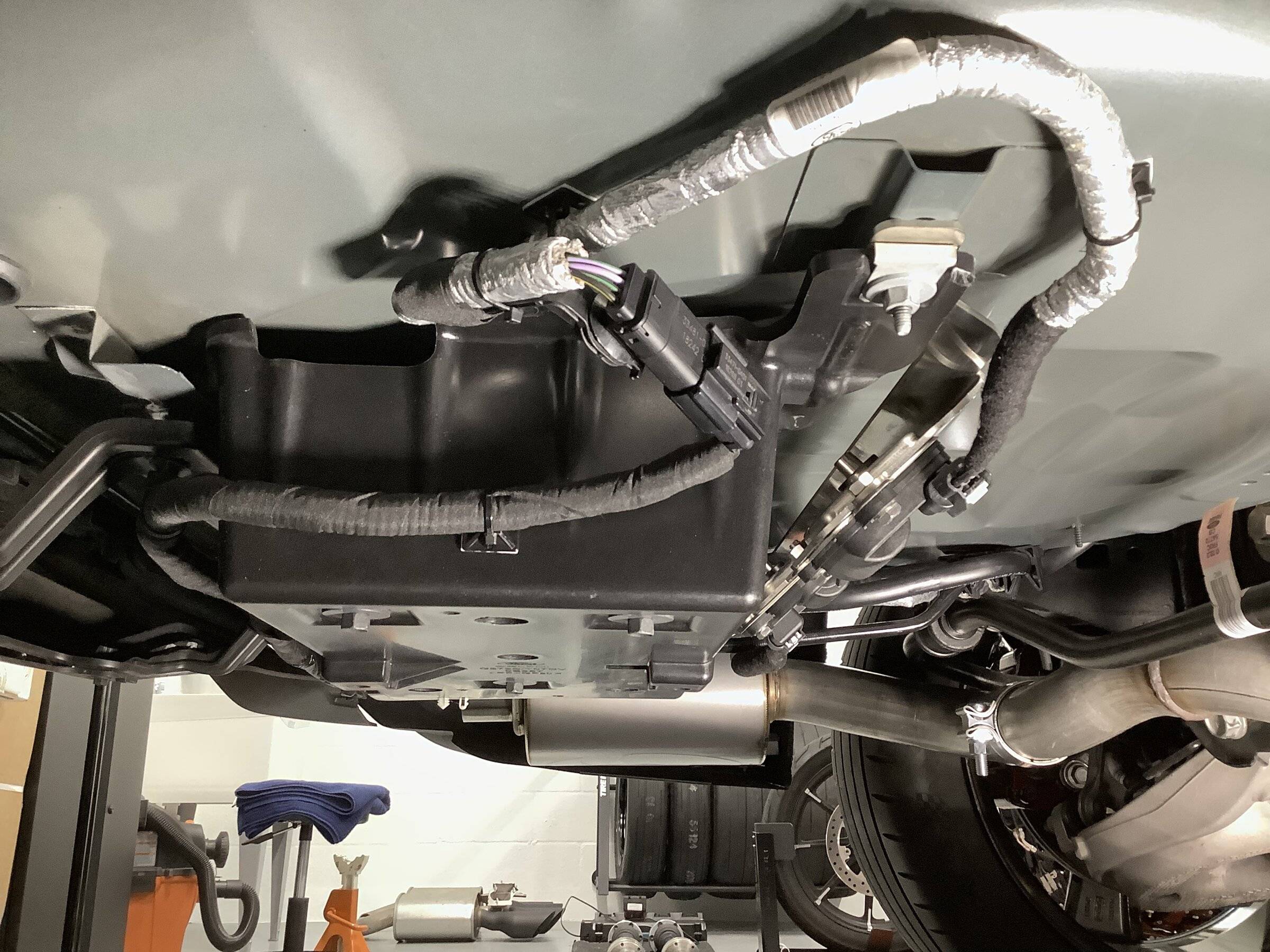

I cut the AE mufflers off of my 2019 Bullit’s exhaust and if memory serves me correctly, they weighed around 19.4 lbs each.

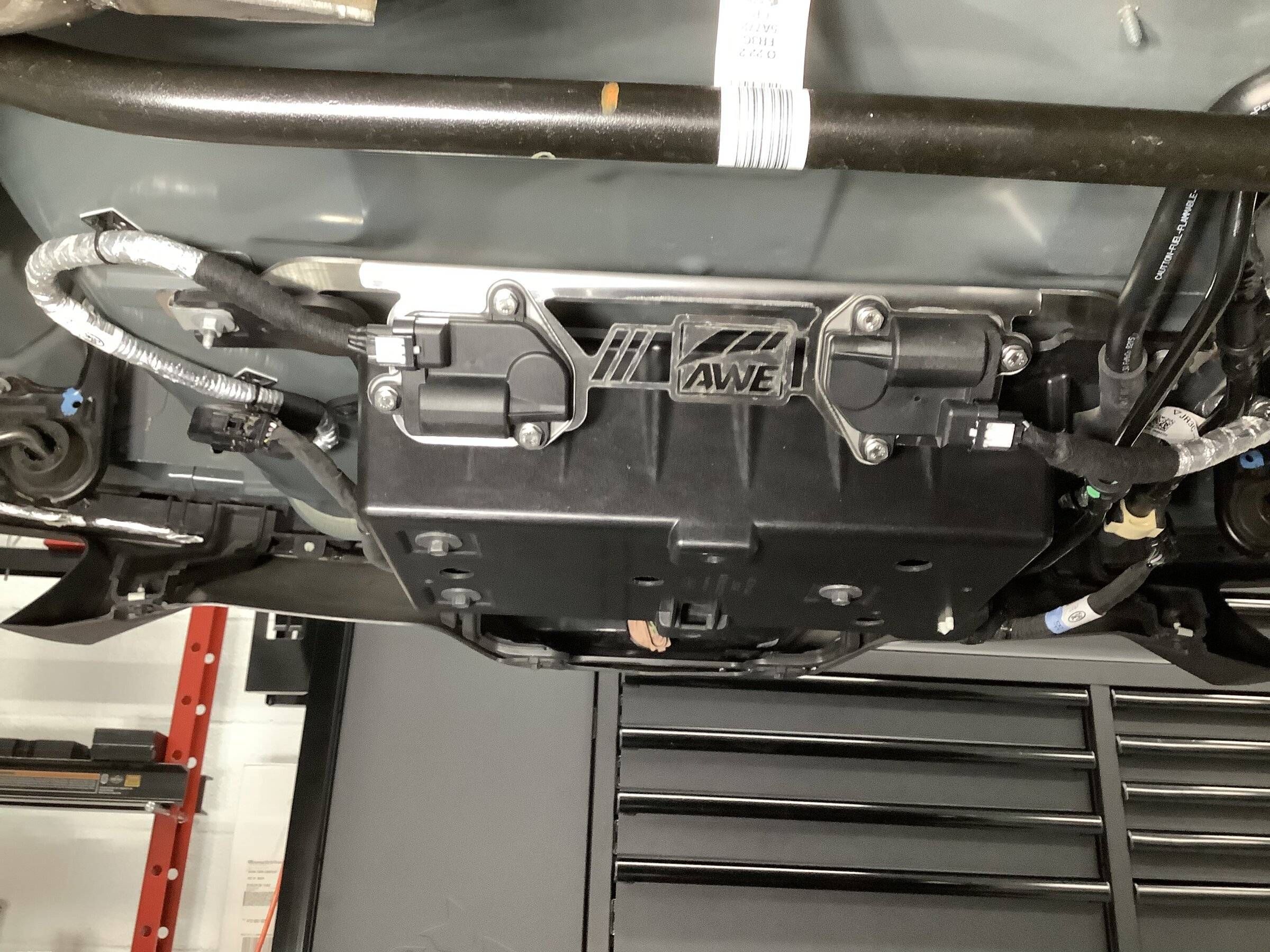

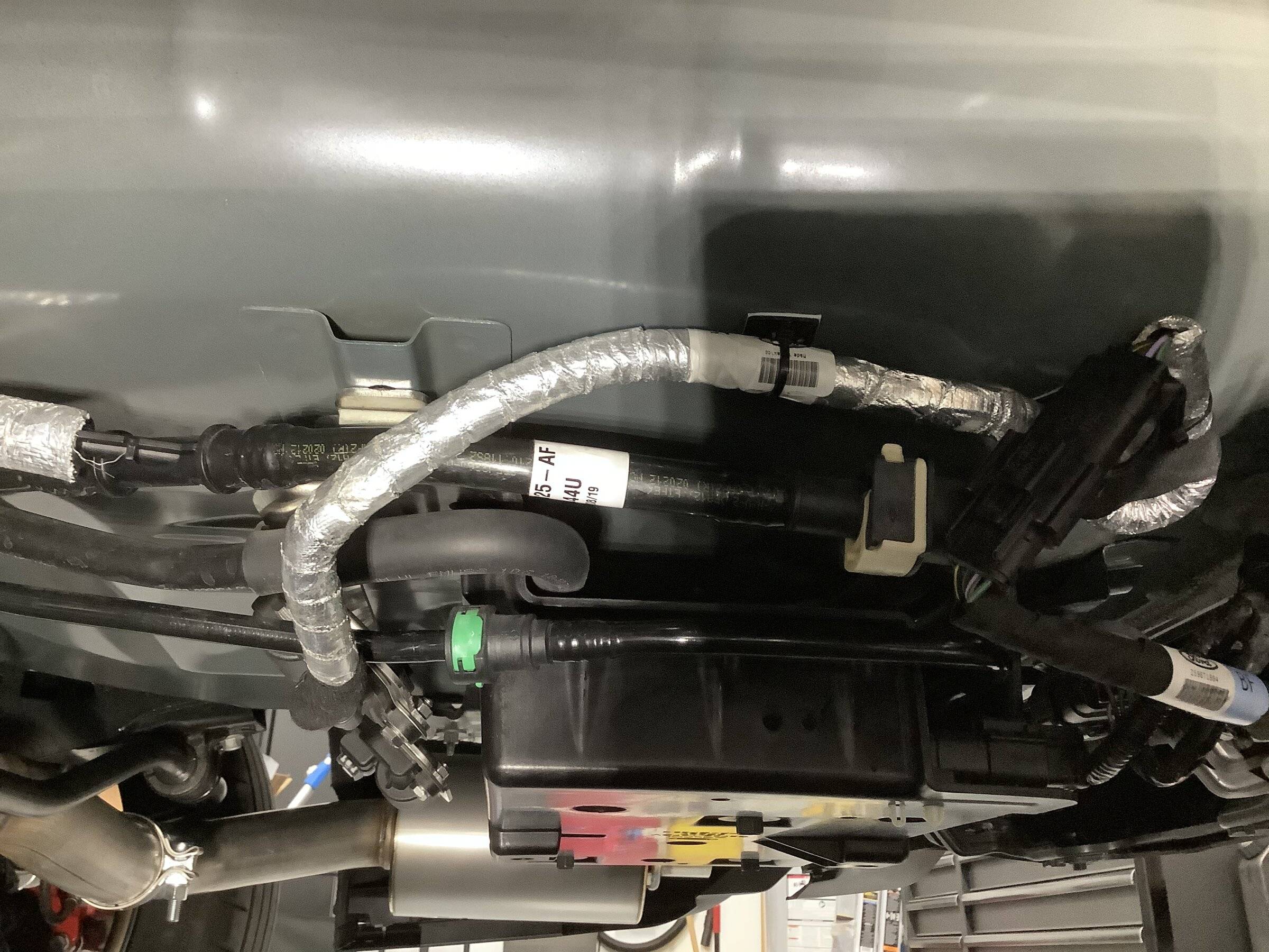

No, because I relocated the actuators to an AWE bracket and kept them plugged up to avoid the error message on the dash. I did have an error message (before relocating the actuators) at one point though and I had to fix the passenger side harness because it rubbed on the pinch weld and shorted out.
