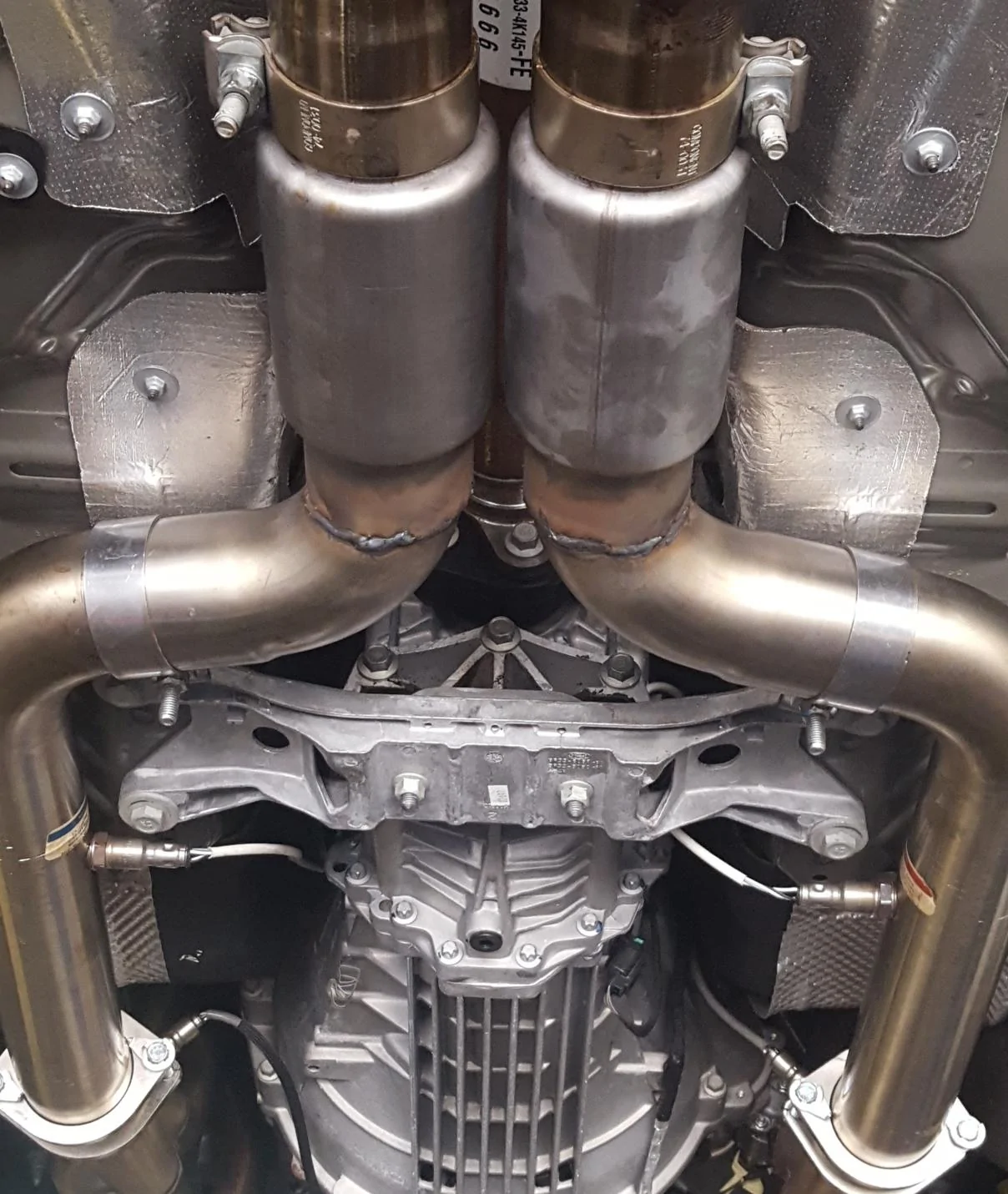

Think i finally got it how i want it. I was trying to get as close to the gt350 as possible. I have kooks off road long tubes on with corsa extreme catback. I loved it but did not like the sharp rasp at certain rpms. I also wanted the system to be full 3" and get rid of the neck down as i think that contributes to rasp as well. I have since did some searching for what i wanted. I found mini race bullet resonators in 3" these are only 6" resonators. I installed them in place of where the neck down is. So there is now no restriction in size and a small resonator to clean up the sound. Results... overall the system sounds deeper and cleaner in tone. not as tinny. still very crisp sound. It tamed the noise level very minor. Still loud and lots of volume. It got rid of probably 85-90% of the rasp. In case anyone was looking for similar setup.

yup, still ridiculously loud..lol the magnaflow mid muffler solved my catless headers issues, i couldnt stand how loud the car was at WOT..

It's still quieter then it was.

catless and corsa is the loudest setup besides straight pipes, those mini bullets didnt do much
i loved my car for about an hour then i needed to quiet it down, and im kooks and 3" borla s types and it was still stupid loud..not to mention the rasp..ugh it was terrible

Is a gt350 louder than an extreme with headers?

no it it not. the gt with extremes are louder. theres a video out comparing both
