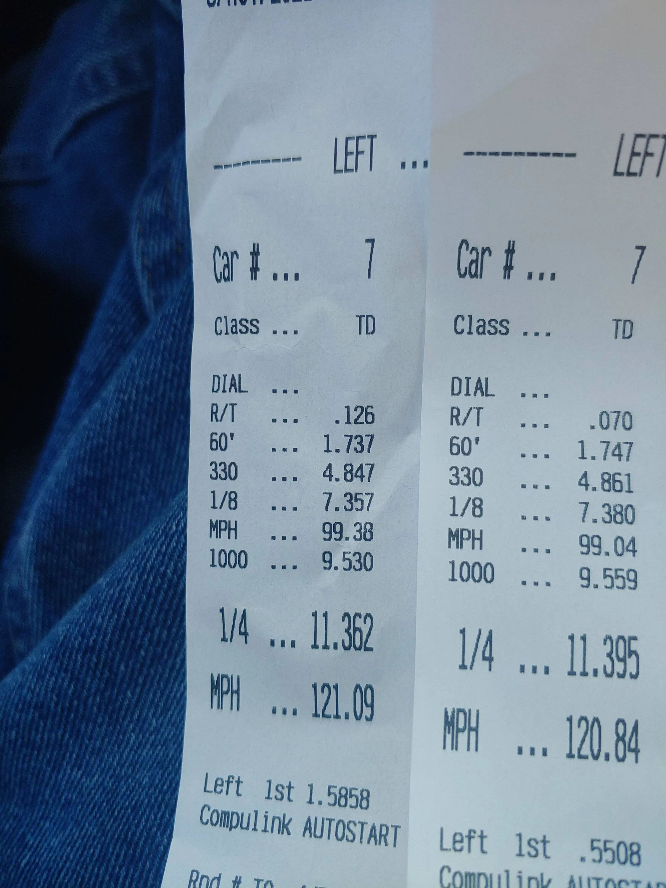

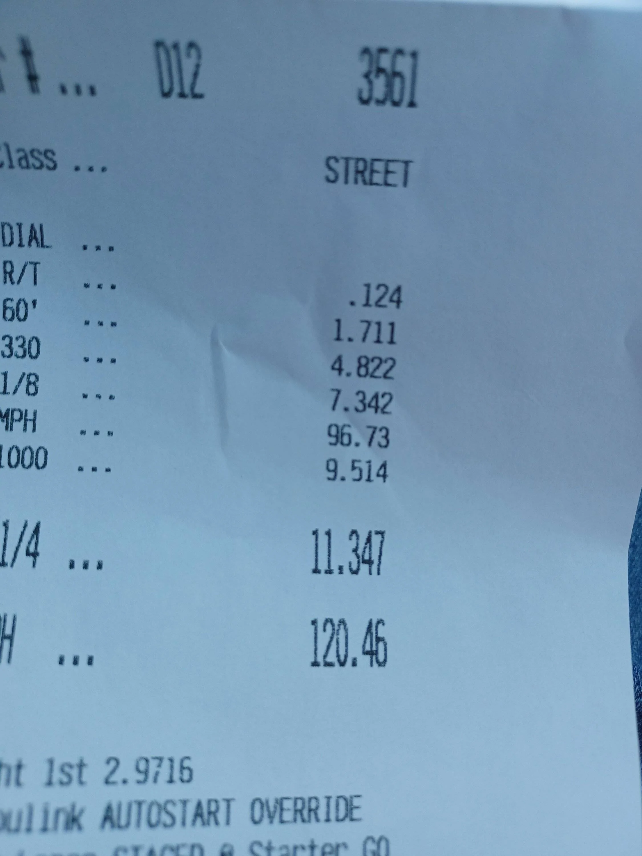

Based on what I’ve seen at the track, I’m gonna put you around 11.30 - 11.40 ET range.

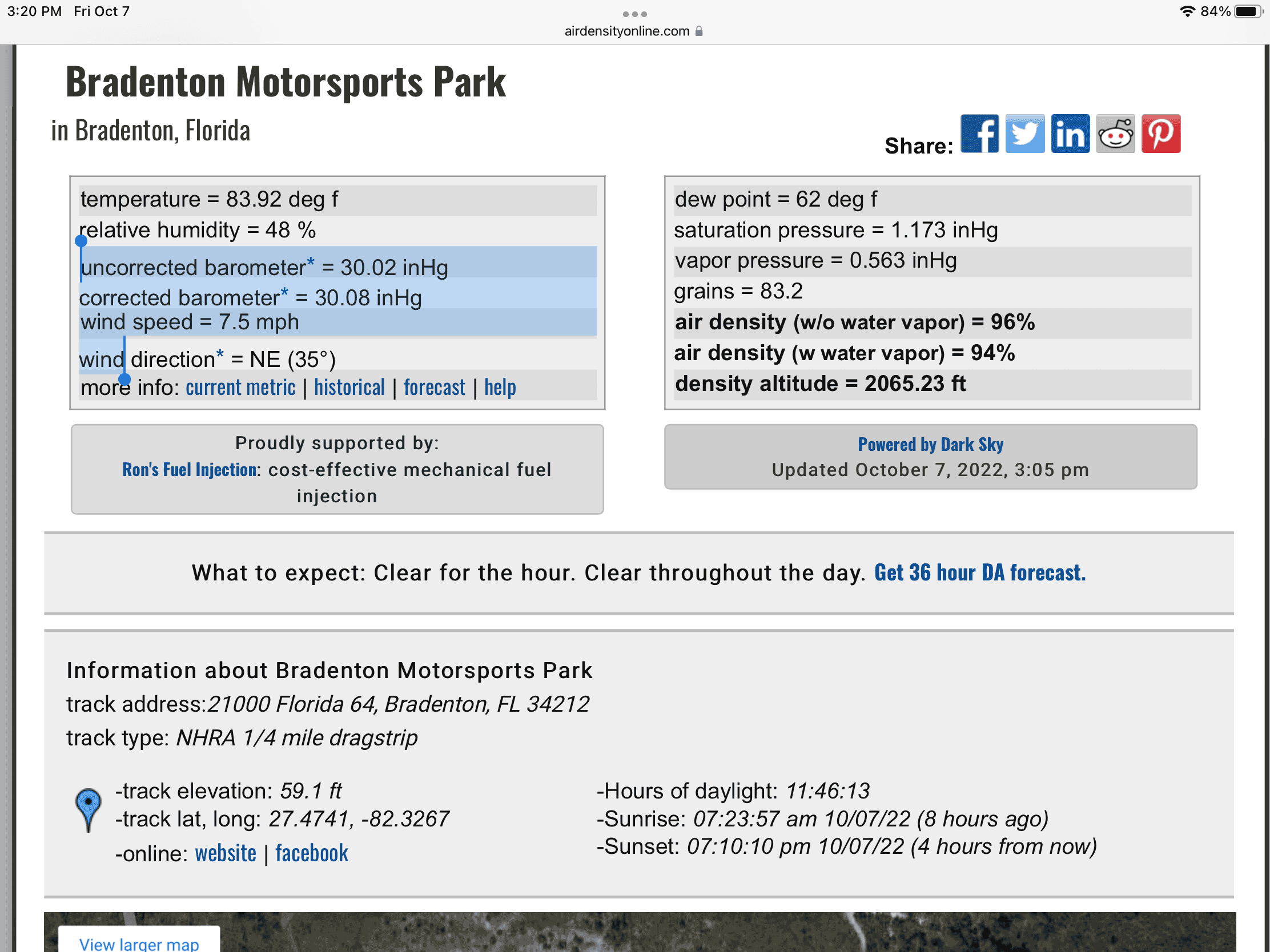

That would be great. Since 11:50 is cut off for no rollbar, a little ballast would put me where I want to be. What average Density altitude are you seeing where these numbers are run? We average 1800 to 2400 on decent days, 4000+ on the wurst days.

Here’s a quick screen shot for today. I would imagine the times will be a little better going into the fall.

I ran the car there in Feb of 2020? Spent a winter at North Fort Meyers. Normally I run at Brainerd intl, in Minnesota. 1210 elevation, or Rock Falls Raceway, Wis, el 810. At Bradenton I got to watch the then new GT500 (modded) run a nine!
