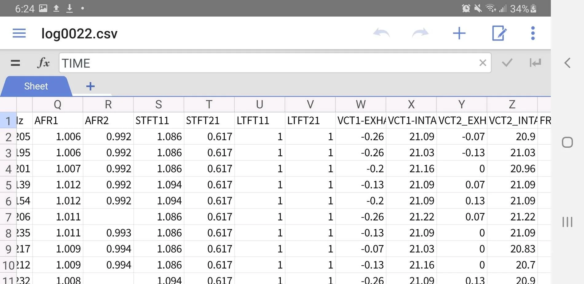

hey everyone. Recently installed vmp odin kit. At first it ran ok, ran into some throttle body issues, bank 2 o2 sensor stuck rich, etc.
I am now on my third twinjet 69 throttle body and it seems good so far. However, i have codes p0556 (brake booster) and p050A (cold start idle). My Short term fuel trim bank 1 stays around 1 at idle..bank 2 starts at around 1 then goes down to around .6 (while bank 1 is still 1). My AFR seems fine..both stay around 1..as does my LTFT. My vacuum at idle is right around 18 or 19.
Any thoughts? The car idled fairly rough but didnt stall, i also saw some fluid under the car which could be water..but im fairly certain its fuel. Im about to start taking things apart to check my fuel connections and injectors..any other ideas what to check?
I can try to attach an idle log if helpful

never seen an AFR of 1. do you mean lambda? first off I wouldn't worry about montioring any PIDS until you address the leaking concern. you have a current mechinical issue that needs to be addressing before trying to diag the vehicle. what are you using to datalog?

Hey, did you make any progress on diagnosing what was wrong with your set up? I had some issues with the supercharger lid gasket. I was wondering if you went down that route yet?

i did, one of the bolts from inside the supercharger came out and lodged itself in a valve. Fortunately it doesnt seem to have done any damage, it knocked the rocker arm off and essentially made that valve stop working, which kept it from chewing up that bolt and i was able to remove it.
did a compression and leakdown test, everything seemed fine.
have been driving it for about a month now and all seems well. knock on wood
the p0556 code (brake booster) was due to the bolt being out, it left the hole open. Thus causing a vacuum leak inside of the blower. that, and the valve being stuck slightly open made my fuel trims go crazy as well.
on my third throttle body currently, and all seems good with it as well.

probably going to make that bolt into a necklace. But yeah, all cylinders showed 240-250 on the compression test, and it has been driving well and Lund said all my Datalogs look great. None of the stems or anything seemed damged, even the rocker arm wasnt really damaged, just knocked off.
