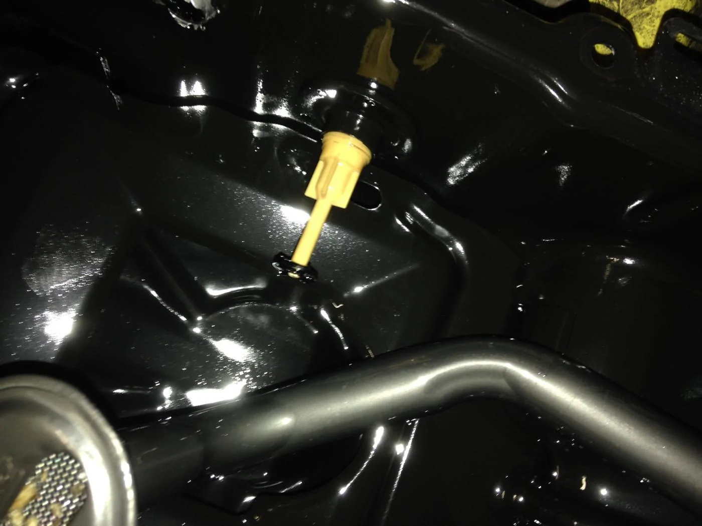

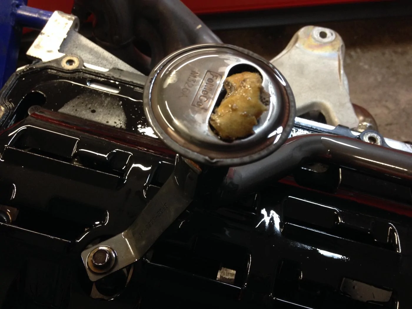

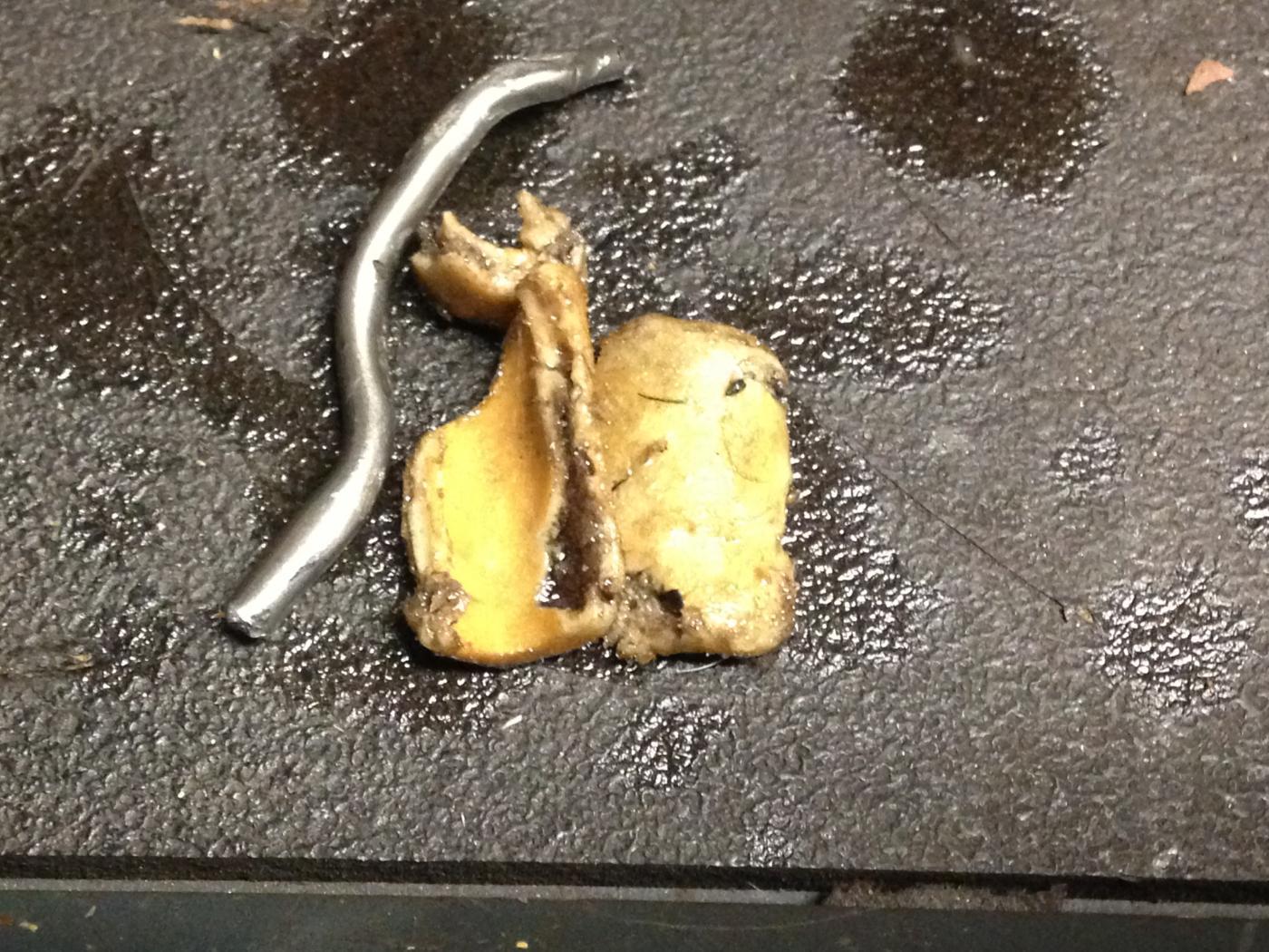

Left the sensor out and plugged the hole, had to get the cams and journals polished, mmr squirter deletes, installed new bearings and rings. Been good ever since, think this happened when i taped the pan for the turbo drain or possibly because it came from a wrecked car.The guides are black with the actual friction material is a yellow color on mine anyway.
which sensor did you leave out, was it the oil level sensor,if so how do you get around the low oil light staying on.Left the sensor out and plugged the hole, had to get the cams and journals polished, mmr squirter deletes, installed new bearings and rings. Been good ever since, think this happened when i taped the pan for the turbo drain or possibly because it came from a wrecked car.

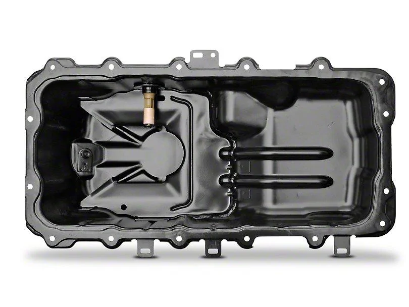

Leave it out, light wont come on.Reason I ask i just did a dumb thing, jacked the car up on the front cross member and the jack slipped and hit my oil pan, pushed it up about an inch. I bought a new oil pan but there is no hole for the sensor so i was thinking of leaving it out.

Yes oil levelwhich sensor did you leave out, was it the oil level sensor,if so how do you get around the low oil light staying on.
ThanksI have the GT350 Pan on my 16 GT, And it does not have the provision for the sensor. I never got a " Low Oil Level" light. Send It!!! P.S. This is a sick build I have been following since the tear down for the swap!
