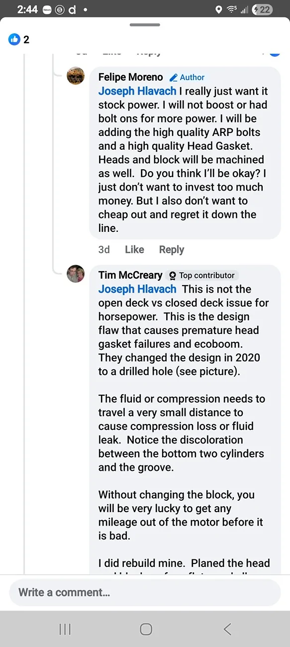

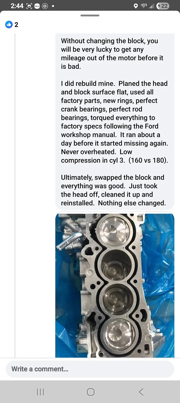

I have the old 3.7 but I hang in an ecobost group in Facebook. Google list the head gasket and turbo problems from 2015-2017 and not in future models. I was telling them I always wanted a turbo and was t thinking about upgrading to the newer s550. I was informed just because t they got rid of the v6 doesn't mean the new cars have problemsof their own. There are several post where people have talked about head gasket engines and a few complete engine failures. Ecoboost Mustang is the name of the group if you are interested. I hate to pass this information on to you but figured id share the group because engines are a hot topic there. I haven't herd about anyone putting the newer 4s but im sure someone's done it and it will be a hot topic.
From what I understand old heads wont work with the new and improved 2020 block.
