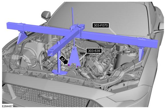

I am not at the car right now so I was hoping for some pre planning help.
I need to lift the motor up to remove the engine mounts and brackets to install my 4 into 1 Hellion manifolds. According to Alldata the lifting points for the Engine support bar are underneath the intake manifold. Are there any other places to lift up the engine without removing the intake. Thanks.

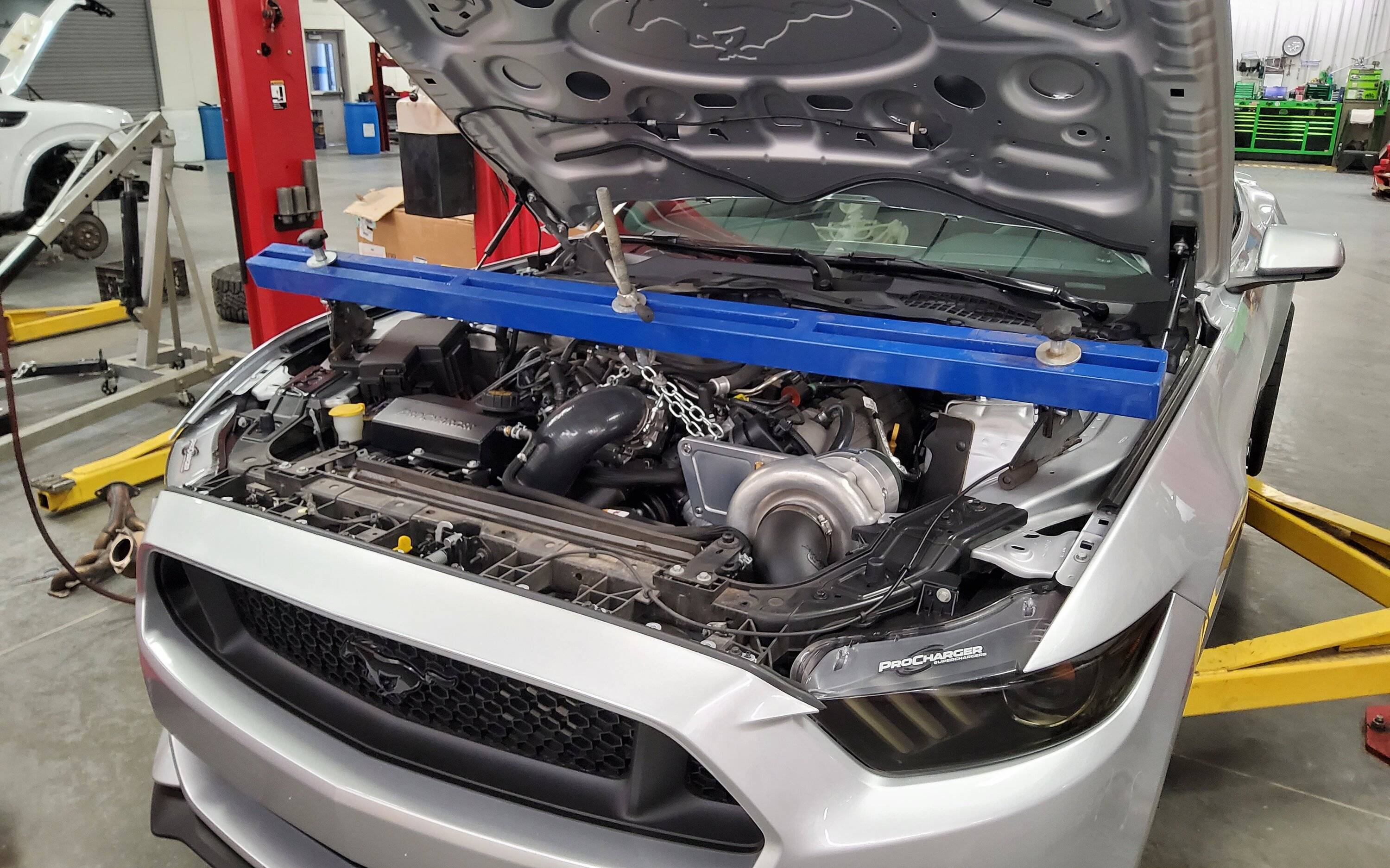

When I did mine , supported the engine with a cross brace ... I have installed some more for customers , used a screw jack . With engine support it was easier.
