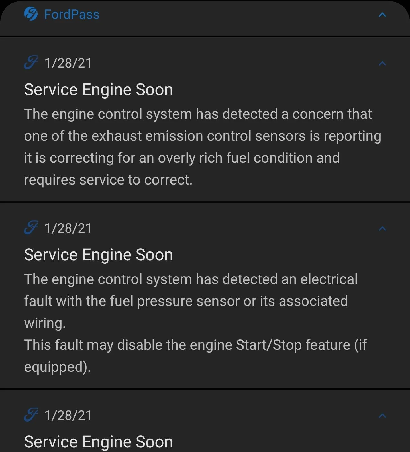

Hey guys, I have a 2018 Ecoboost and for the last month or two whenever I'd fill it up it would have slight rpm dips after filling up and then stop after a minute or so. I thought maybe it was being filled too much so I started under filling to 3/4 tank, didn't help. Also I run only Shell V-Power 91, tried Chevron and it didn't change anything.

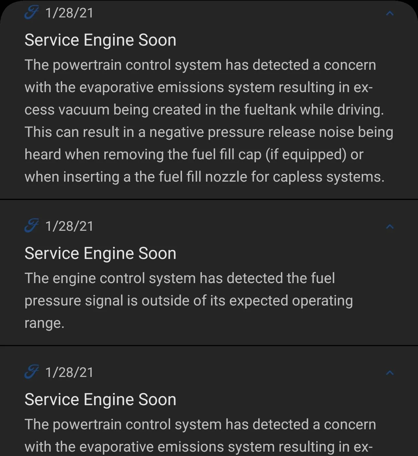

Yesterday I got a check engine light and received the messages on my phone from Ford Pass right after (attached photos). Then later that night after filling up (slightly under filled) the car struggled to start and when it did the rpms went all over from 400-1,200rpms and the entire car shook bad, it smoothed out after a minute or so.

Something easy and simple to try would be a evap purge valve. The purge valve opens when the computer wants the engine to burn the evap fumes from the charcoal canister. When you gas up the tank has to vent fumes as its fills so it vents them through the charcoal canister for emissions. If the purge valve is stuck open it will just suck all the fumes from the charcoal canister when its not supposed too, causing a very rich condition. I don't know where its located on the ecoboost, but on the gt's its right by the throttle body.

Thanks for the reply, I took it to Ford today, was able to get the work covered under warranty, was the Evap purge valve and fuel psi sensor. They're being replaced and I'm getting the car back in the morning
