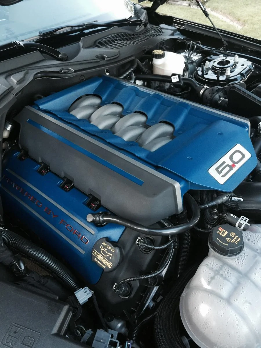

I painted my coil covers and engine cover with high heat engine paint (with ceramic). I used the gloss that goes with it. On the engine cover I did the center section only. Didn't separate the pieces to paint things, and carefully masked around the badge. I used a tiny screwdriver to tuck tape down between the cover and the badge. Then I simply masked the heck out of the sides and it came out perfect. Looks good even close up.
Have plenty of light in the shop when painting. There are some places that you can miss.

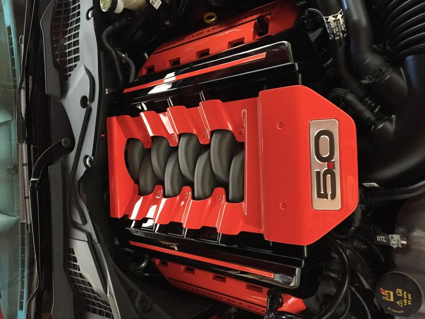

got mine from RPI designs

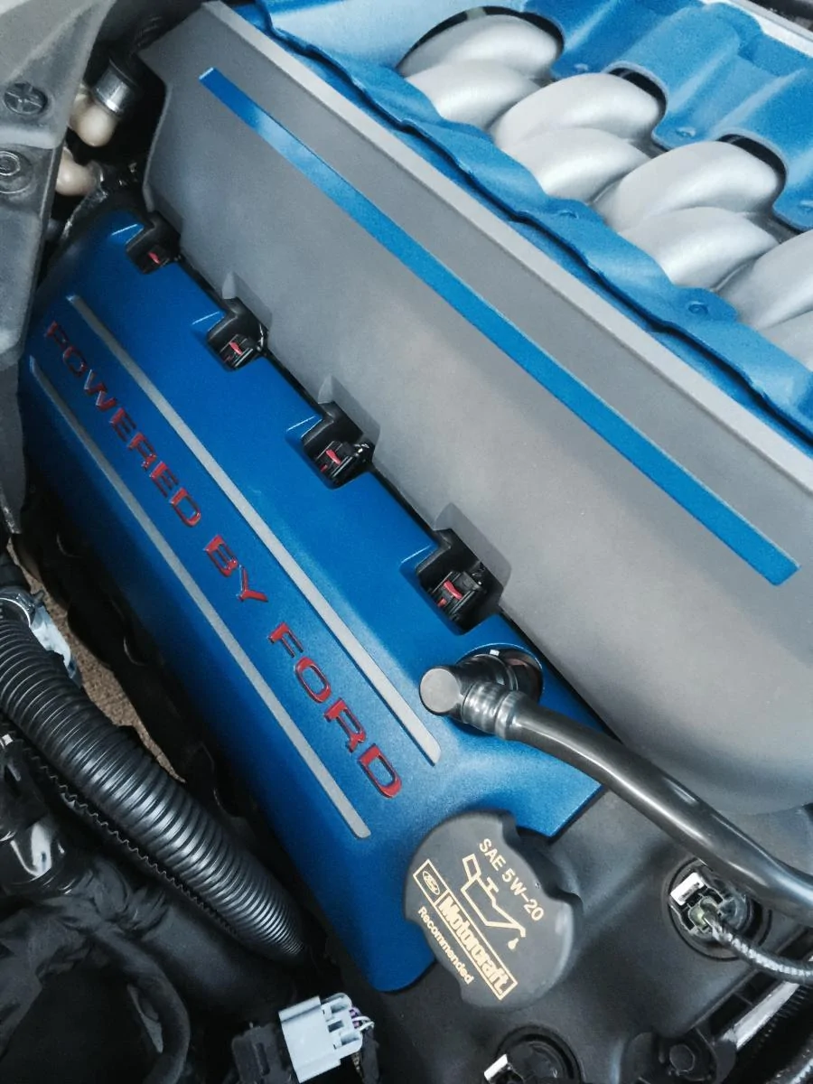

So here's up I did, went to auto parts store and bought a can do the old ford blue engine spray paint, and a can of red spray pain, and a roll of blue painters masking tape, spent a weekend putting primer on first then spray painted 2 coats with drying time inbetween. Then I put blue blue masking tape over the letters and using an exacto knive cut out the letters this takes time and patience. I then spray painted the letters red, 2 coats

I went with Ford Blue as well. If it's good enough for the Boss... And besides I wanted some thing besides the car color. If only this website wasn't weird and would let me post pics from Flickr!
