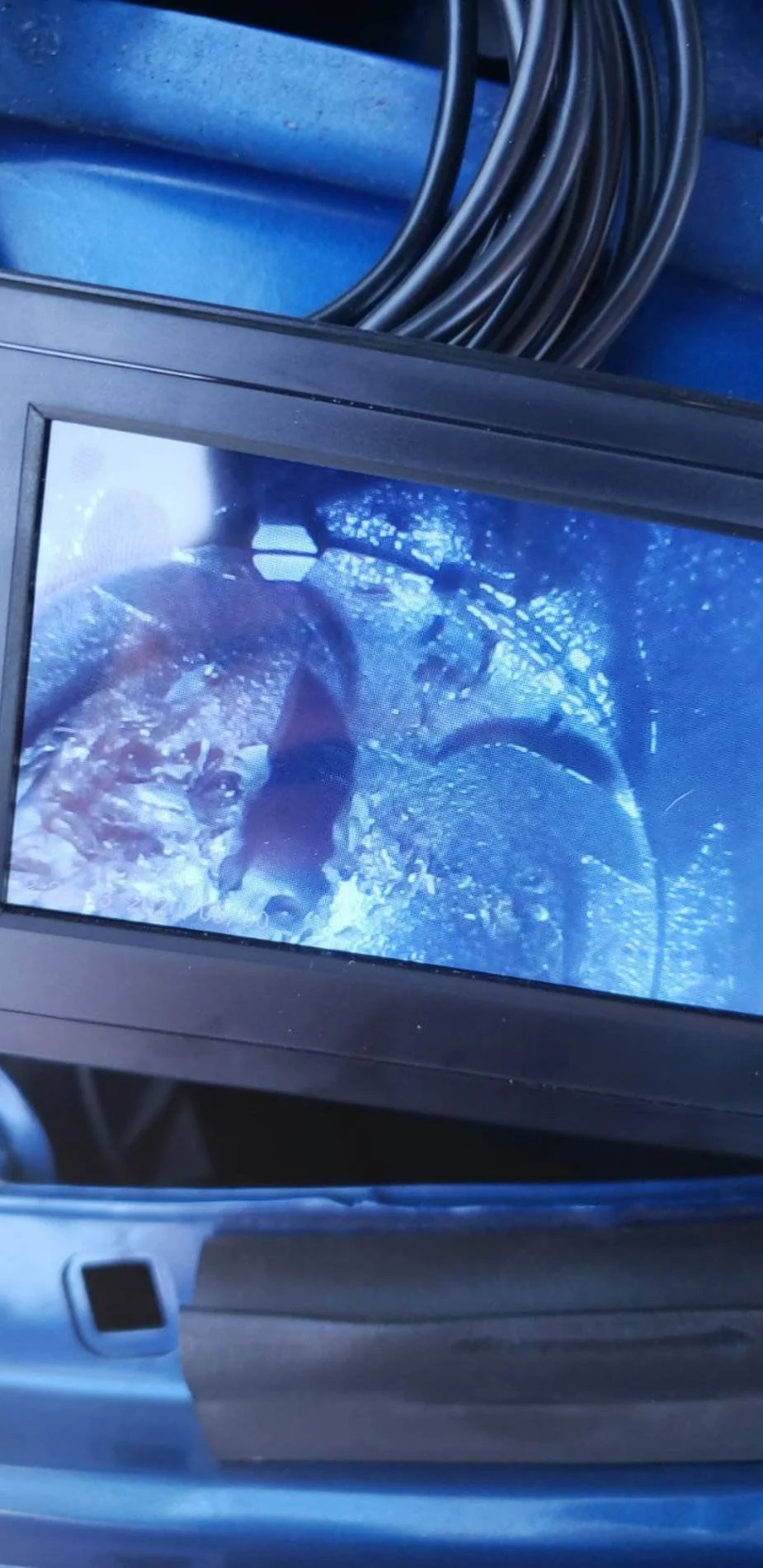

The piston looks cracked when installing the manifold are you sure nothing went inside your cilinders? Maybe it had a lean mixture.

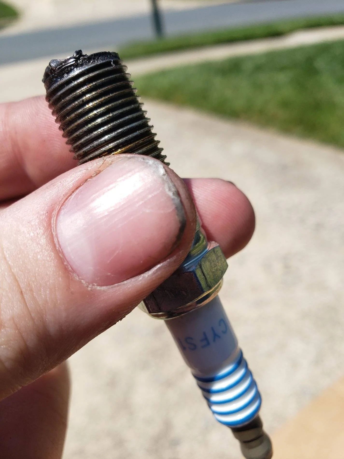

That's some serious detonation to do that to the spark plug. Maybe some of the debris in the cylinder if from a valve?
I saw there were some track guys dropping exhaust valves...maybe that's what happened to my engine. I only ever got a look at the intake valves, both were in place with one having some scoring
