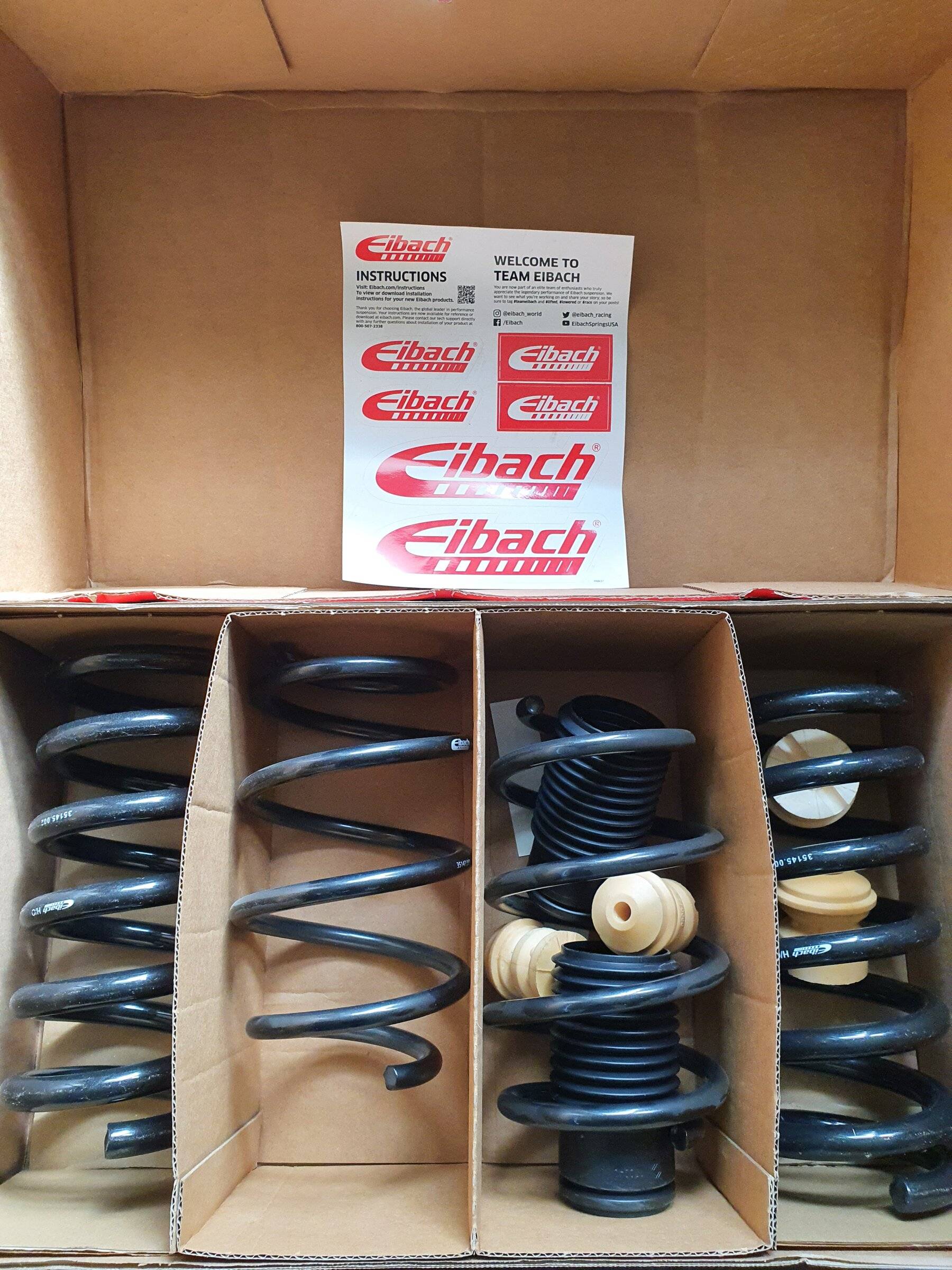

Hi,
Just had some Eibach Pro-Kit suspension springs delivered, just wondering if anyone had any experience with these on a 2.3 Mustang. I have heard the Pro Kit still drops the car about an inch and has an overall improvement
Eibach also have the Sport line springs with a more aggressive drop but was worried about the ride quality of these, especially with how poor UK roads can be.
Does anyone have any opinions or photos with the Pro Kit before I actually get these installed in a couple of weeks?

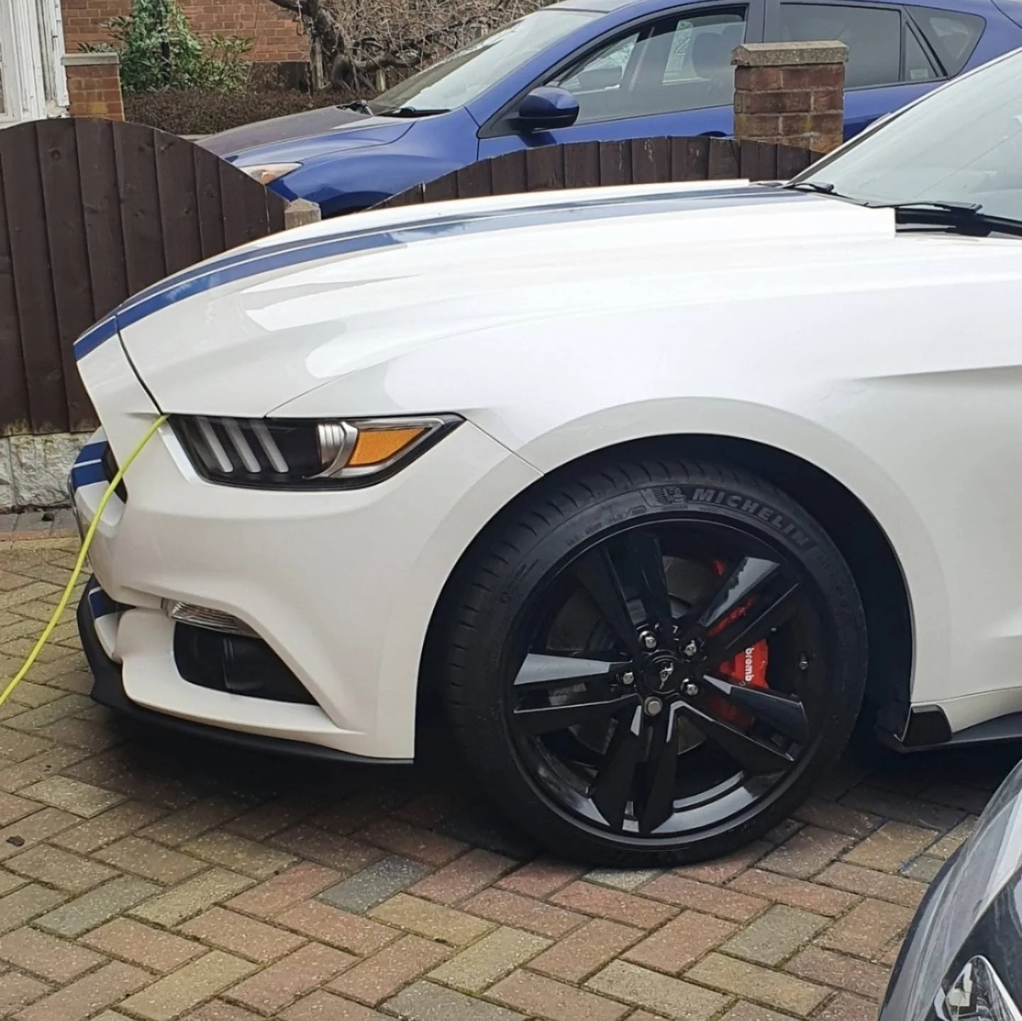

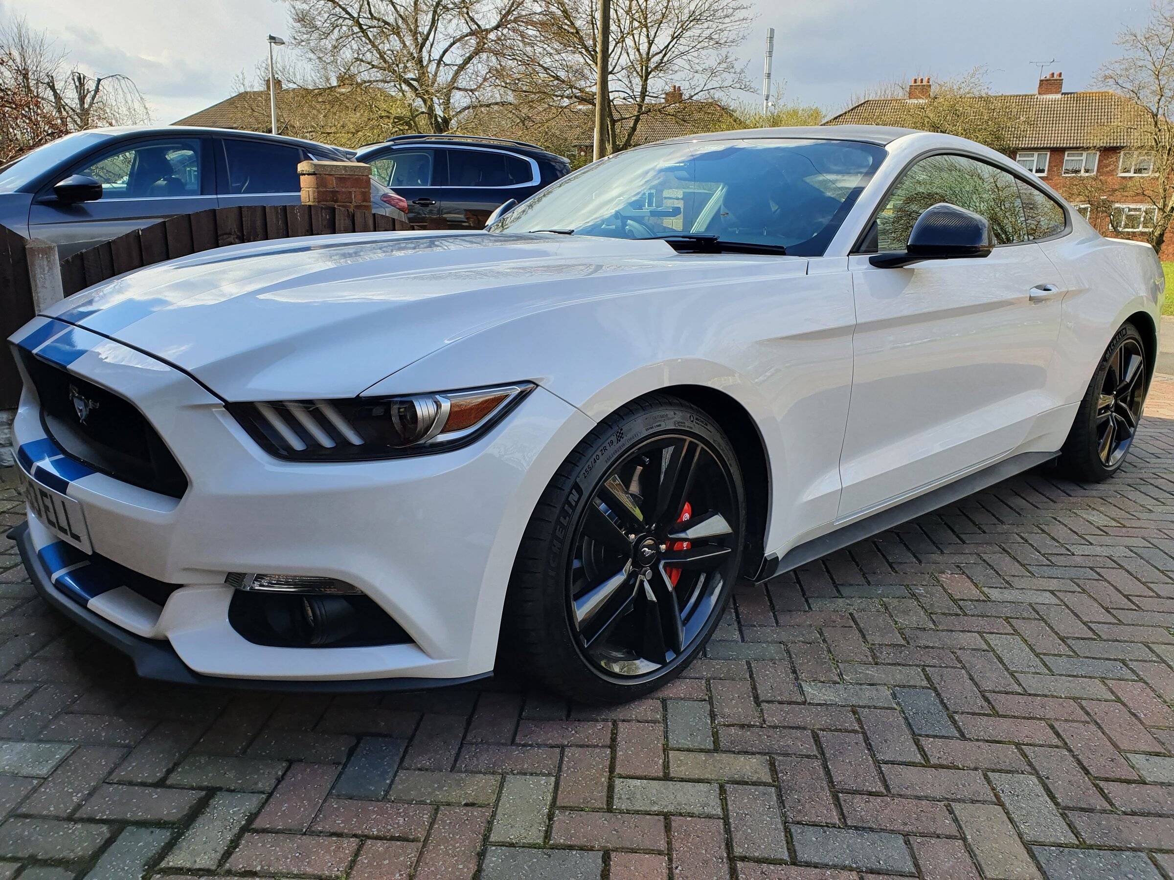

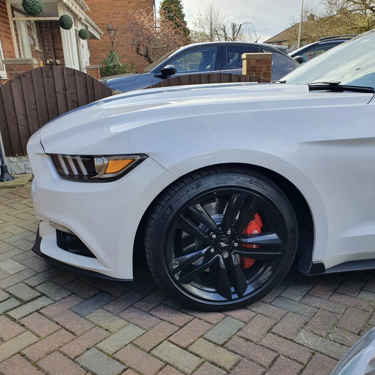

Pro kit springs are now on and its a noticable difference to stock, much less body roll in corners, firmer, sportier ride but not harsh at all. Springs are still settling in pics as it's just after the install, but I'm very pleased with the results. Thanks for the input.
Before:
After:
