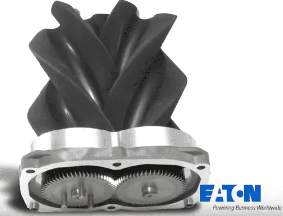

Are you sure you're not hearing the gear interaction behind the pulley? The eaton blowers are driven by a gear set right behind the pulley that causes them both to rotate at the same speed in opposite directions. I think they might generate some noise.
I’m not too sure. I know that my 2009 GT500 did not make this kind of noise.
