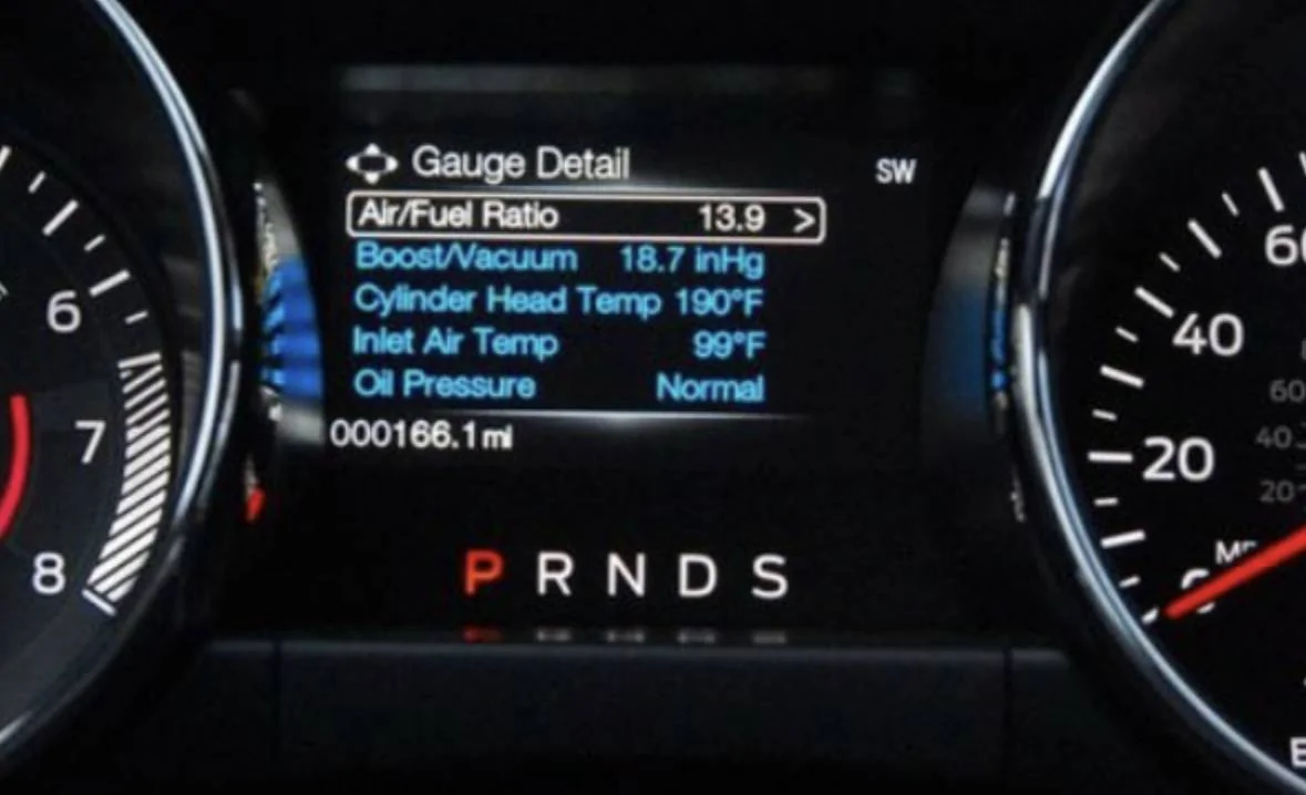

do you have the boost/vacuum turned on? you probably need forscan to turn it on

you need the boost/vacuum turned on. do you have a boost gauge on the cluster

did you have a boost/vacuum gauge on the cluster or just a vacuum gauge? if you only have a vacuum gauge in the gauge cluster then the data is not turned on and none of the factory gauges will show boost even if you add a ecoboost boost gauge

if your car has the data turned on then it's plug and play. if not then you need forscan so you can turn it on. one way to know if the data is turned on is to check your gauge cluster. if it can read boost/vacuum it's on. if it only reads vacuum it's off

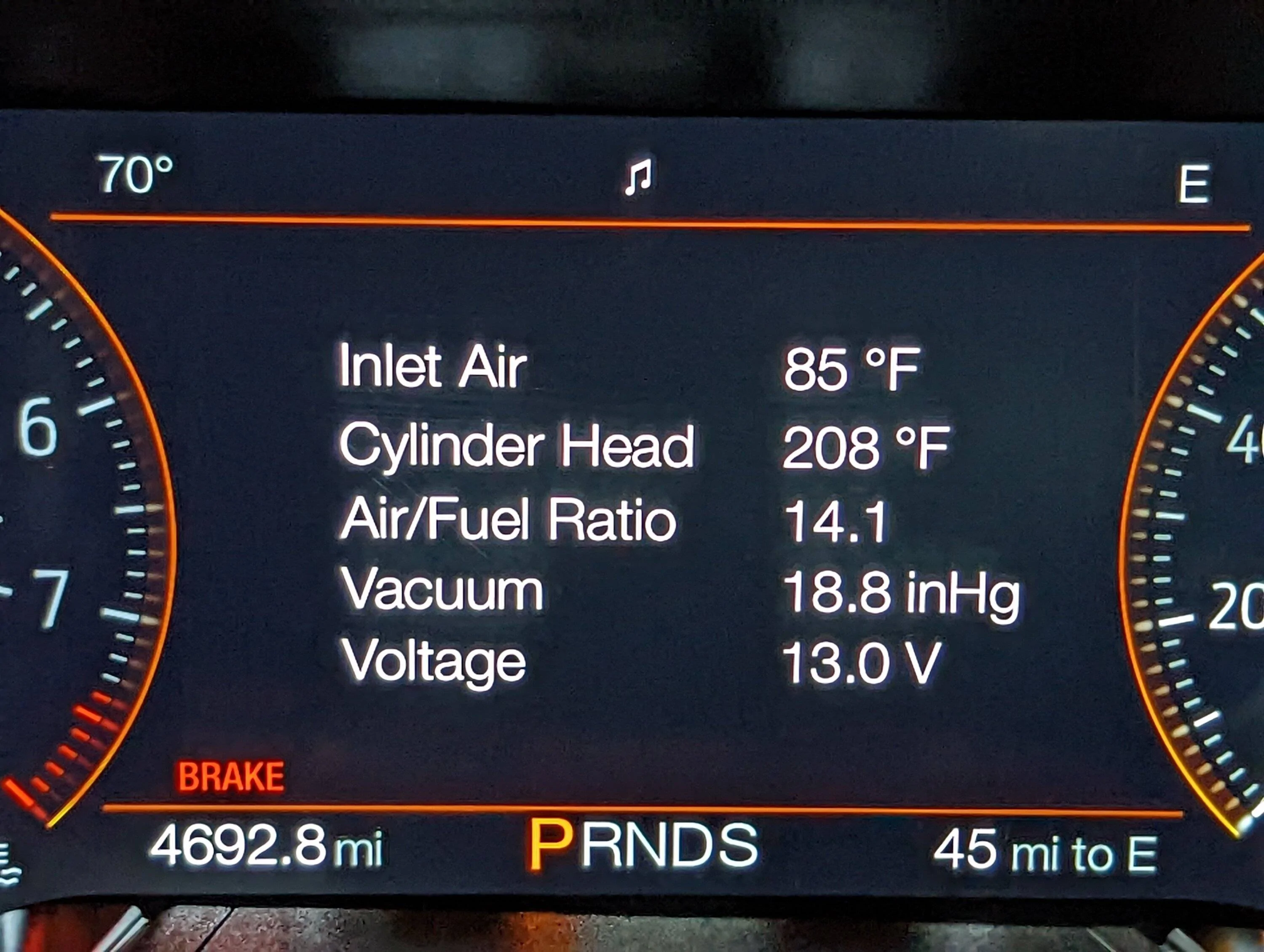

There's no vacuum gauge in the cluster. 19' base with pp1. The only vac gauge was the pp1 gauge in the center of the dash.

Maybe it has something to do with the digital dash because I have a vacuum gauge in the cluster.
