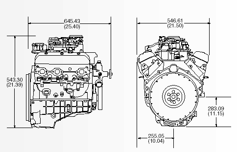

I've looked quite a bit, but haven't found what I'm looking for. I want to retrofit a ecoboost mustang into a spare 350z I have - so I'm game planning a bit. It's obviously a large project so the more information I can have before starting ... well, probably will still mean the same amount of headache. I've attached images of what I'm looking for. Really need the length of the engine and pretty accurate dimensions for the oil pan.
350's use front sump oilpans, but there is quite a bit of space between the VQ's head and the first (false) firewall - so I may be able to push the engine back far enough to manage with the current rear sump pan.

i did some searching around and found this (too big to attach as jpeg). since dimensions are given you can extrapolate any dimension you need. you could either use CAD or print out that picture and use a ruler/caliper to scale a given dimension to a unknown one. i can help with the cad if needed.
https://www.mustangecoboost.net/attachments/m-6007-23t-png.4585/

Thats absolutely perfect and all I need. How in god's name did you find that!? I'm SO STOKED. Thank you so much man!
