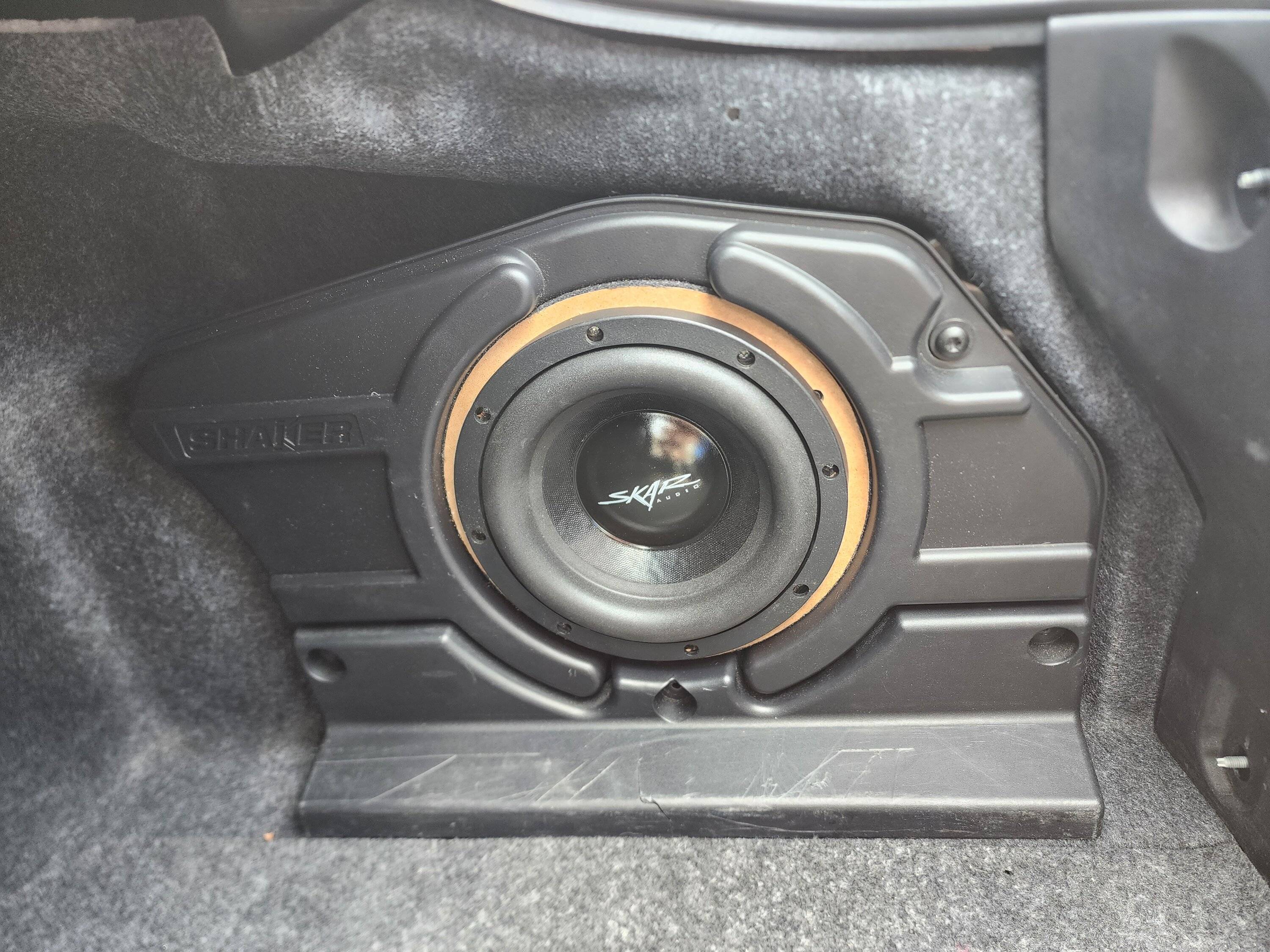

I'll add my aftermarket sub and amp soon but did a quick upgrade on the stock setup to get by. Just a cheap sub with a spacer ring and polyfil.

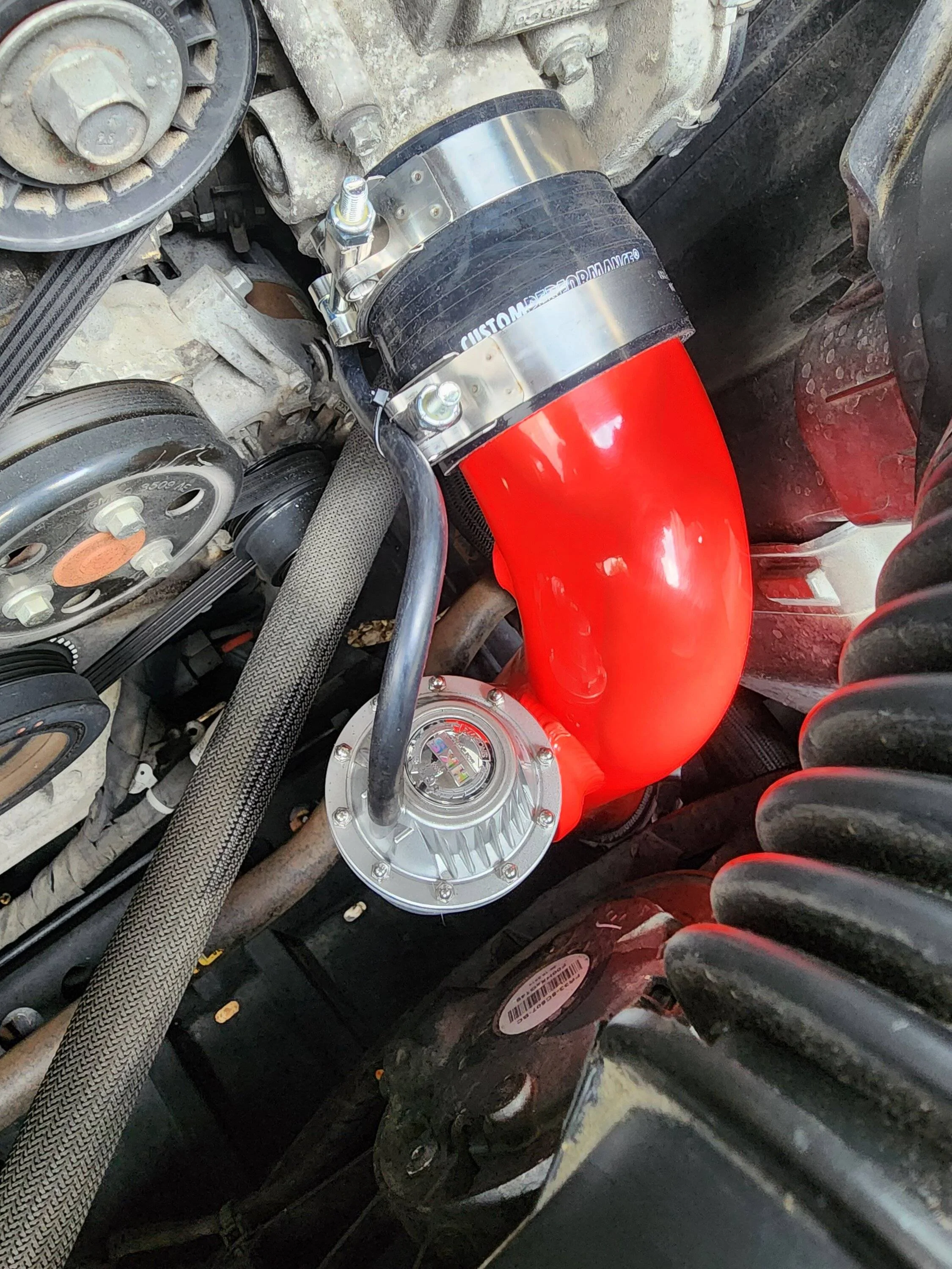

My first real mod is pretty much just just a way to convert money to noise. Cp-e piping with HKS BOV. I do plan on picking up a big ole honking intercooler.

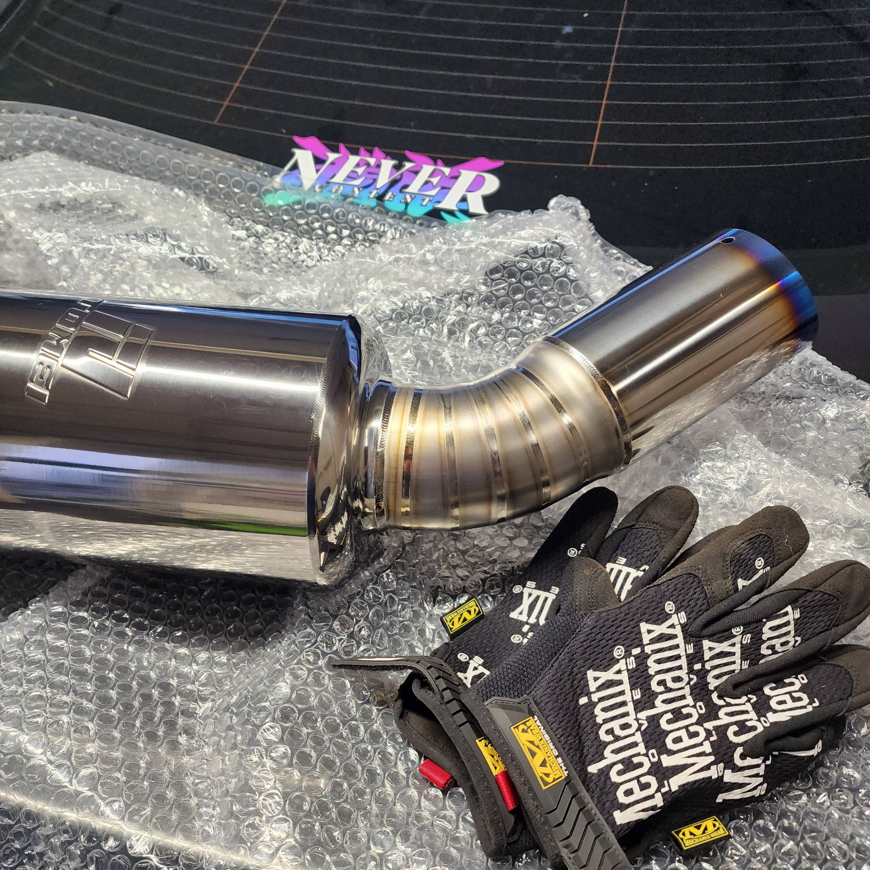

car was way too quiet so I grabbed a Tomei titanium cat back. Single exit for maximum weight reduction and to piss off the purists.

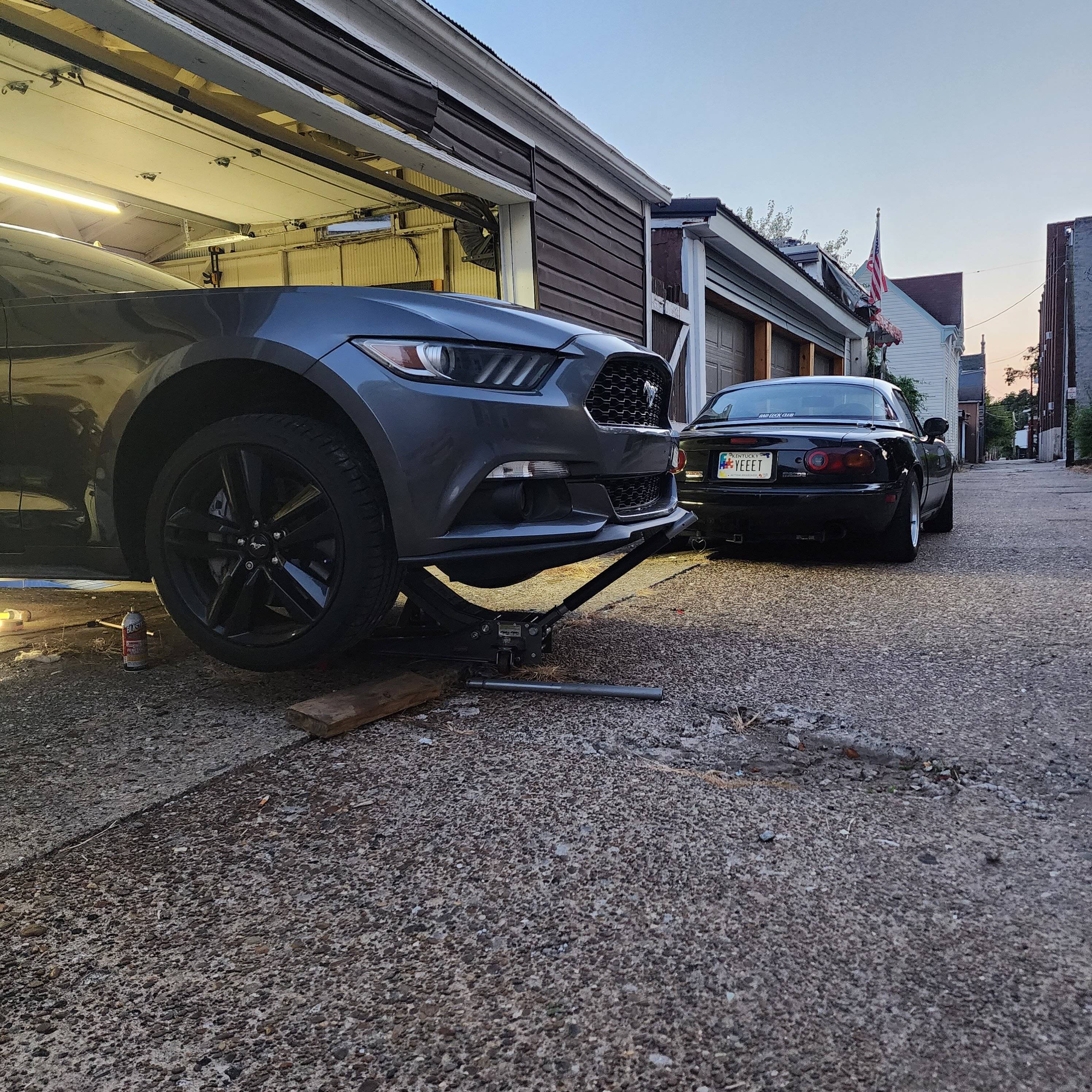

had to kick the Miata out of the garage to have room to do the exhaust.

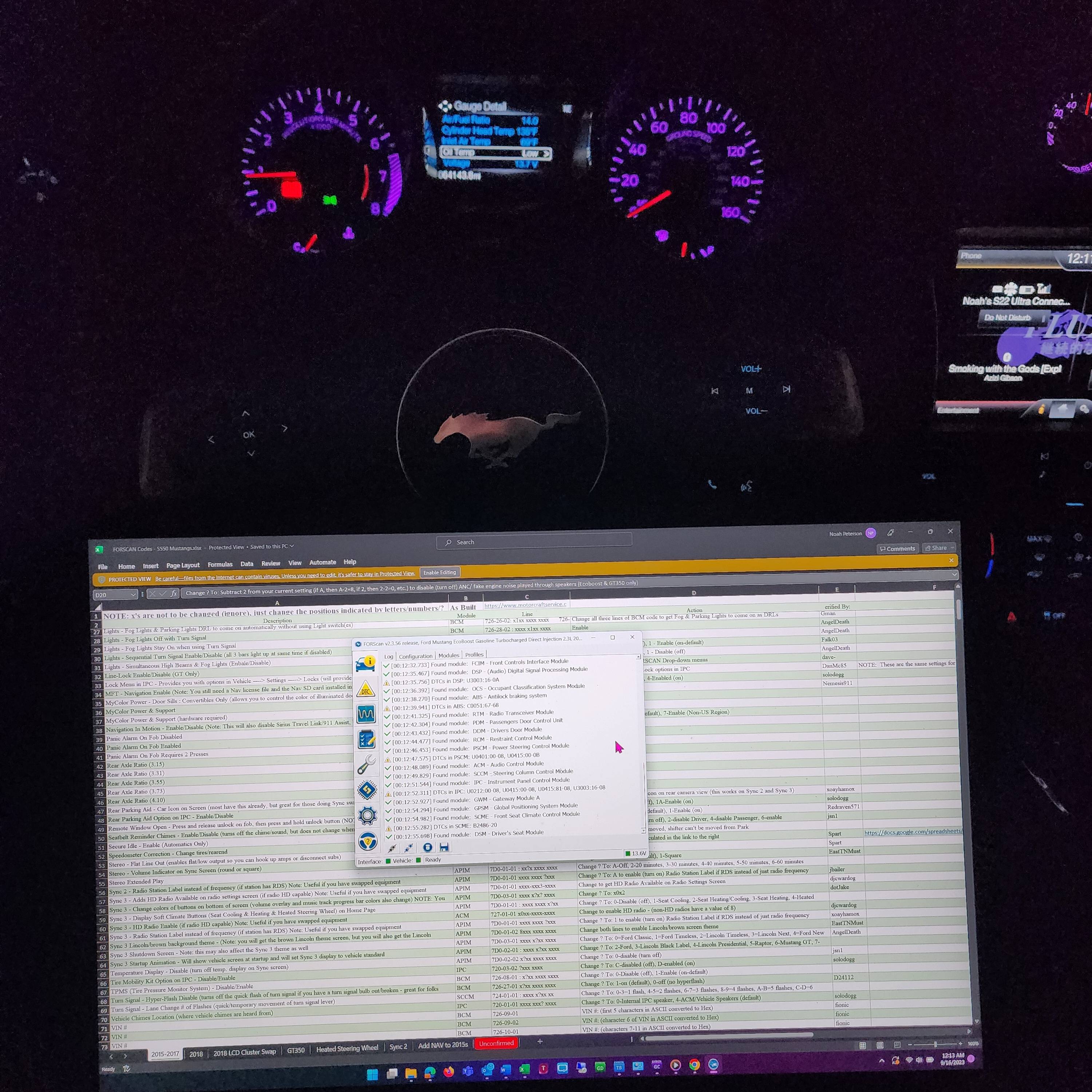

After adding the exhaust I realized the car was amplifying engine/exhaust sounds. It was extremely noticable going from normal to sport+ or race. Picked up a USB OBD adapter and used forscan to disable that crap. Sounds much better. The Tomei is surprisingly mellow.
