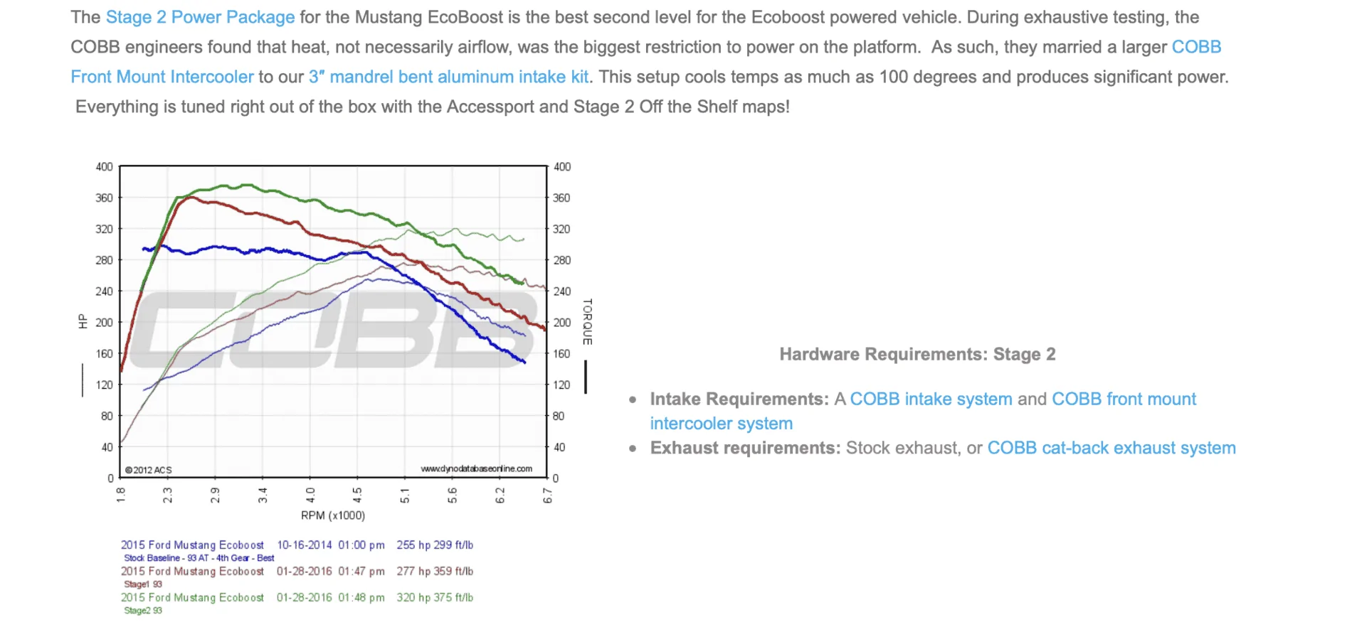

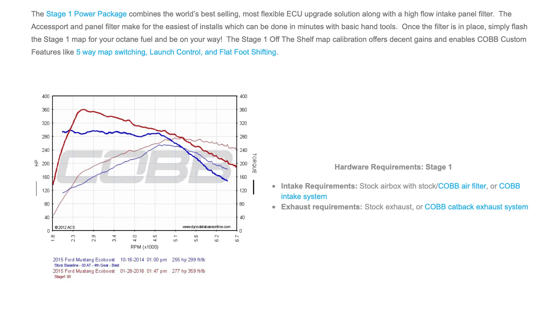

stage 1 is just a drop in filter
stage 2 is filter+intercooler upgrade

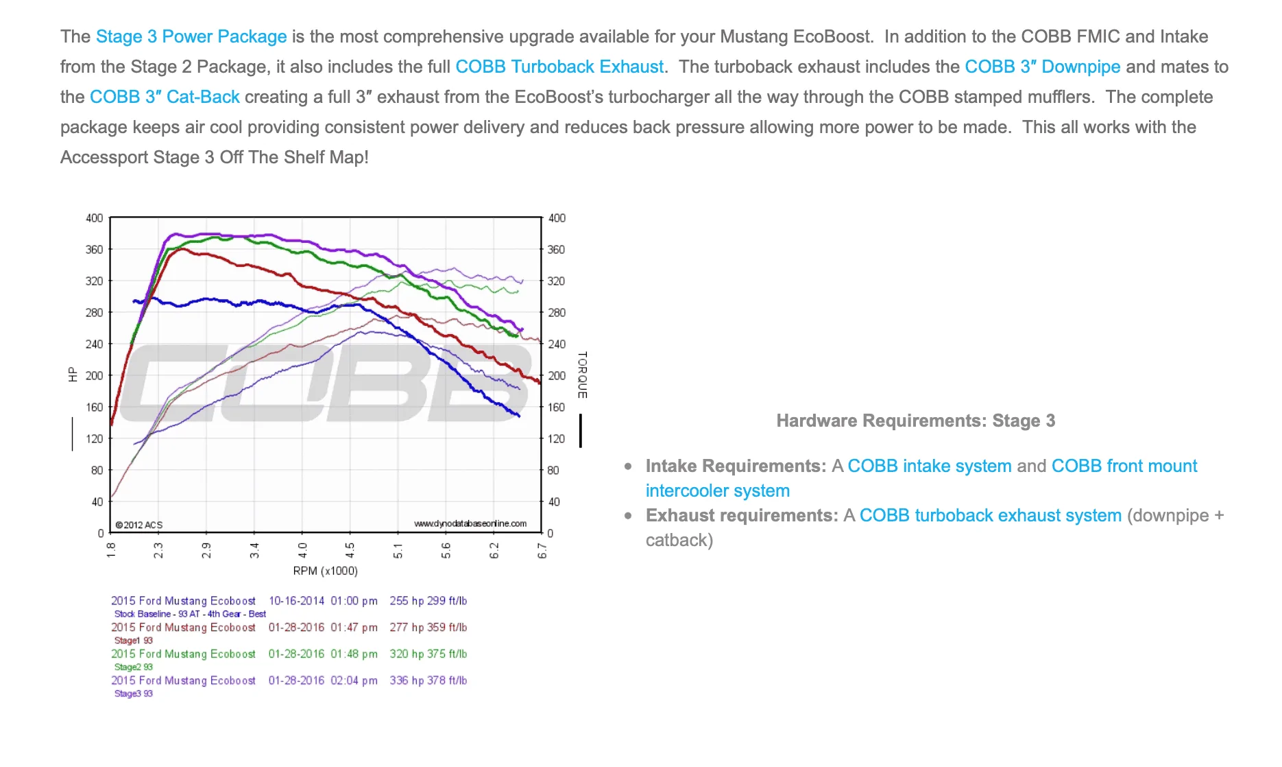

stage 3 is filter+intercooler+catted downpipe (200 cell) oem is 400 cell, so aftermarket catted downpipe is double the flow. catles downpipe is 0 cell.
you need stage 3. clearly it is to push the power a little more each stage. 3rd stage is optimal because more flow out of engine, due to catted/better DP. but you are hatless, should run protune or stage 3.
