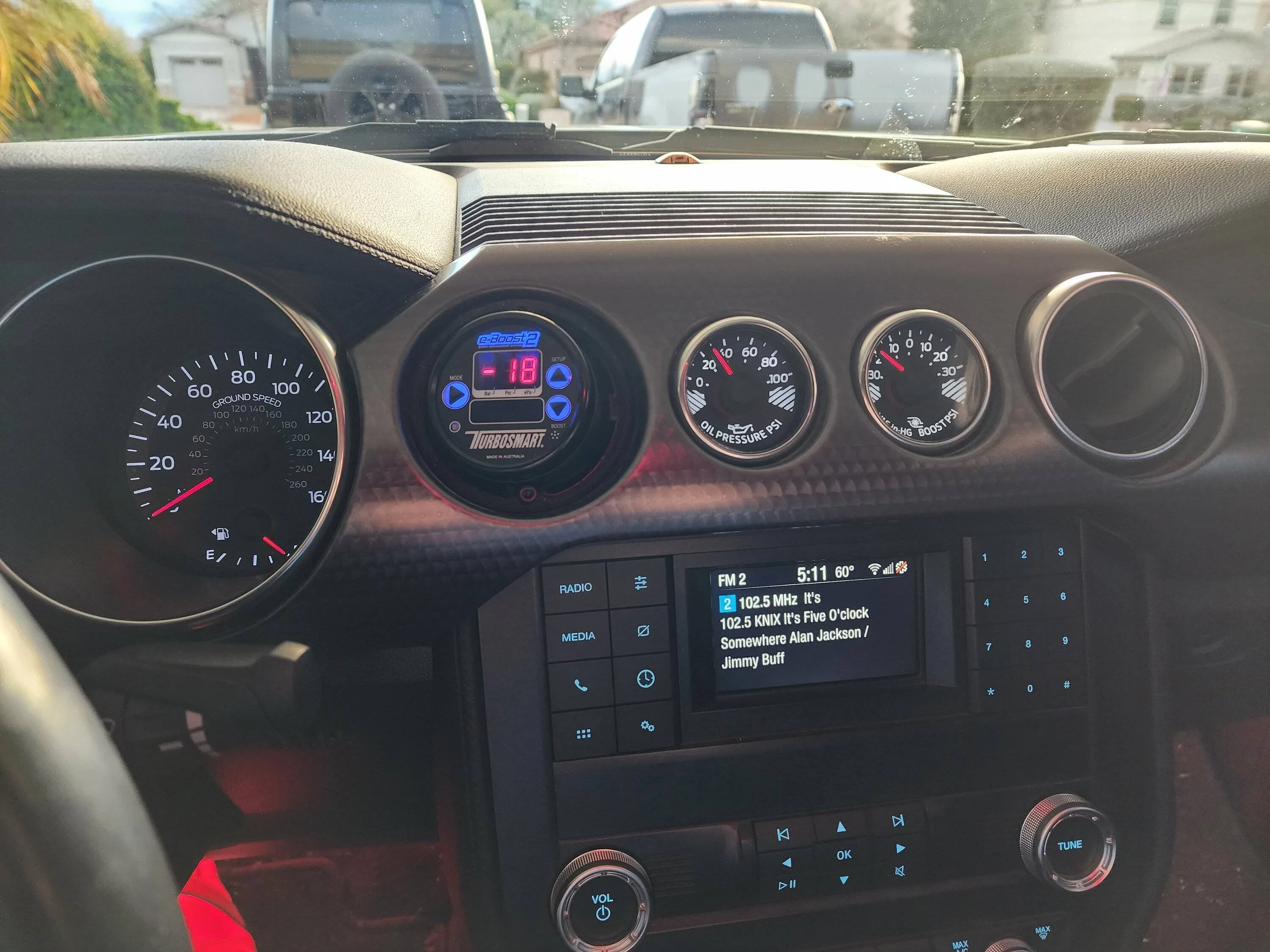

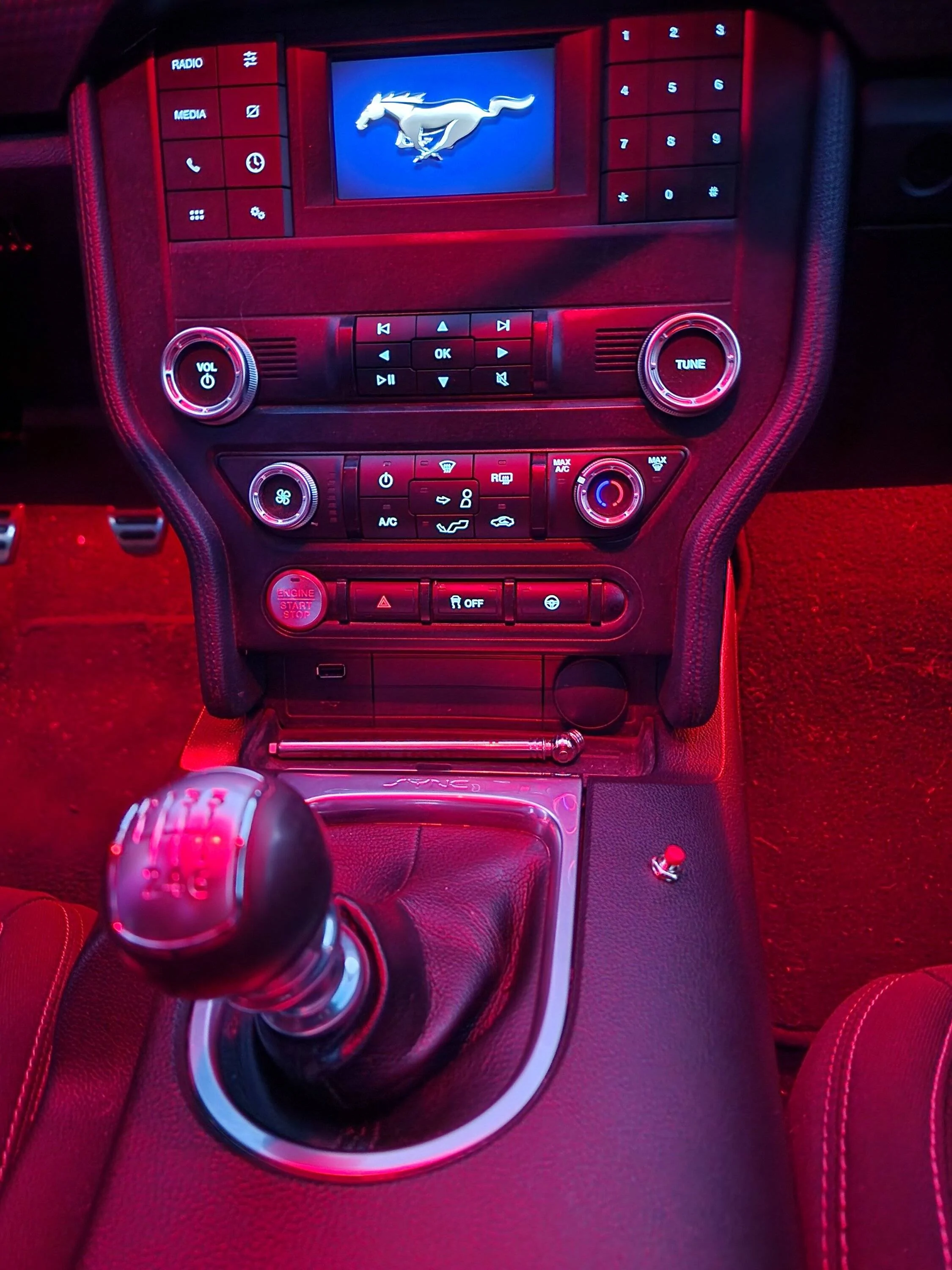

Installed. Now I just need time to get it all dialed in and set my boost groups. Installed a switch by the shifter for quick boost changes on the fly.

Finally got some time to start playing with the eboost this weekend. The car makes about 6lbs on the smaller wastegate springs and 7.5- 8lbs on the larger ones depending on outside temps. It launches so much better at low boost and with the switch by the shifter I can turn it up quick. Hit 10lbs for the first time this morning and Holy shit that was fun. Currently my 4 BG settings are 5.8lbs, 7lbs, 8.5lbs and 10lbs. Still need to datalog and fine tune them. Why did I wait so long to install a boost controller?

Did you block off the AC vent so cold air is not hitting the back of the Eboost unit?
Nope. I live in AZ. I want cold air hitting it in the summer plus it does let some air by to cool the cabin. It's not directed at me anymore but it definitely helps.
